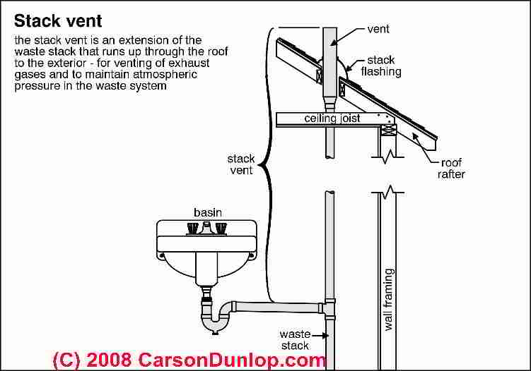

Bad vent is what it sounds like. Something might be caught inside.
The vent will be either through the roof or under the sink.
So basically if it is a bad vent just clean it out and the gurgling goes away? That simple? I will also check the main sewer cleanout that was suggested above.
Thanks for the picture because like I said above I had no idea. I just checked, looks like I will be getting on the roof today.

The pipe in the yard would be the one to check. It should have a threaded plug. Check to see if there is water standing in the pipe. It should be empty. The vent will be a pipe sticking though the roof. Just check to see if it's clear, somtimes it can get blocked by bug nest ot leaves.If there is water in your main some sewer companys will come out and clear the house trap for you.
I will check both pipes and get up on the roof and check my vent. Thanks for the info on the sewer companies as well.

You are probably already familiar with the trap under the sink, a certain amount of water is suppose to be trapped there to make a seal to keep gases from the waste system from coming into the room. for this to work both sides of the trap need to be vented to the atmosphere, if the drain system is sealed when you pour a gallon of water down the drain a gallon of air has to come out somewhere, it will push past one of the traps making a gurgling sound, as the water exits the drain system a gallon of air must enter the drain, again without a vent it will push past a trap making a gurgling sound.
