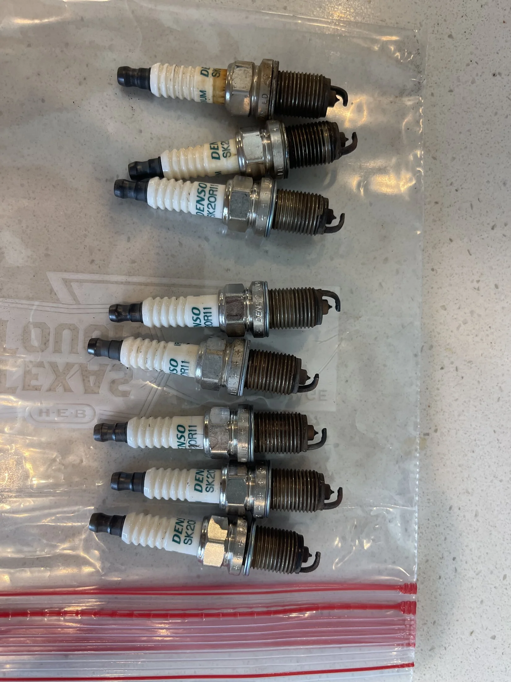

Replaced plugs

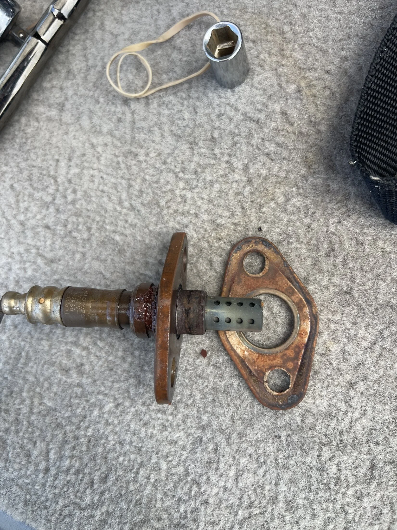

O2 sensor

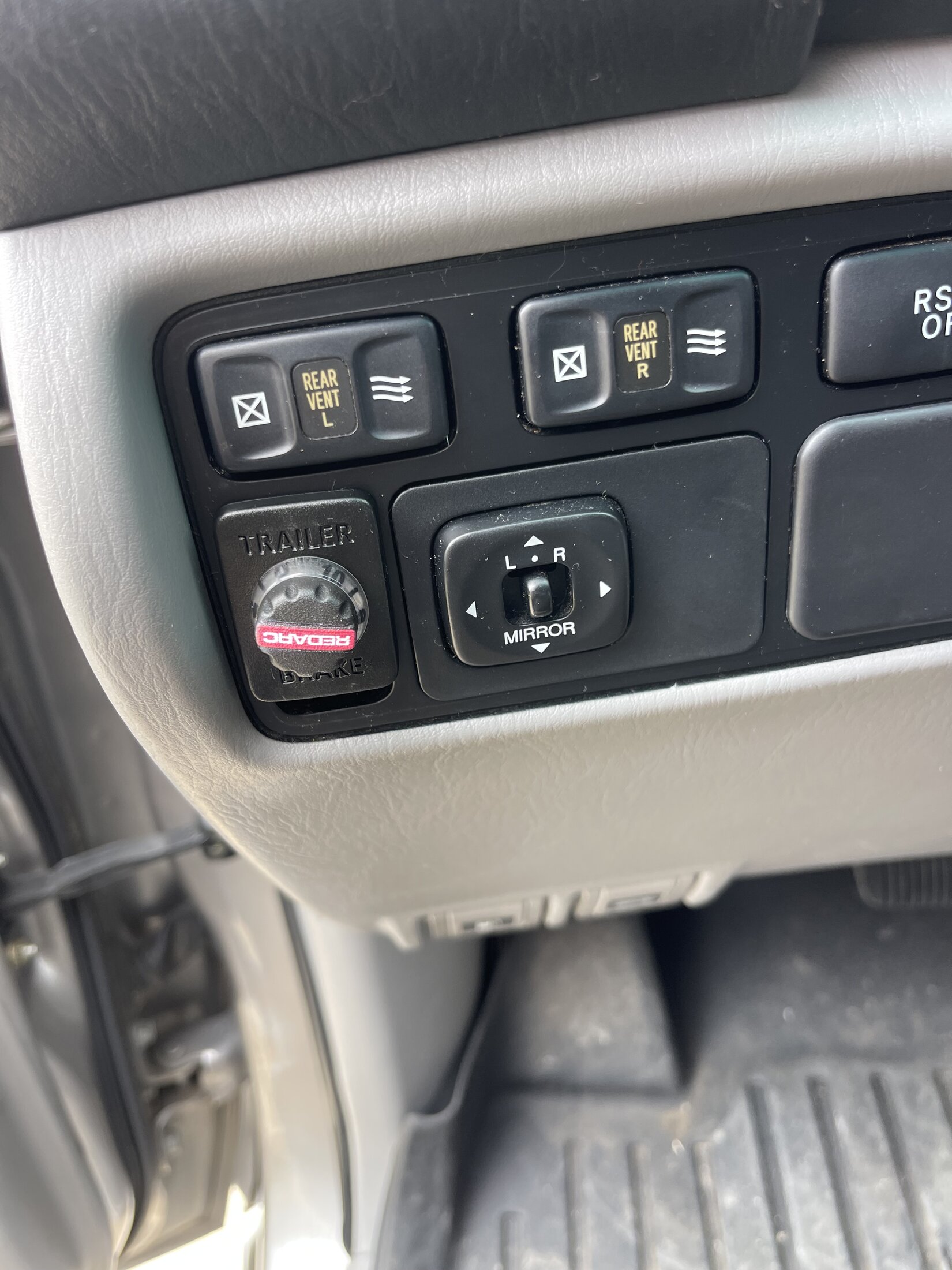

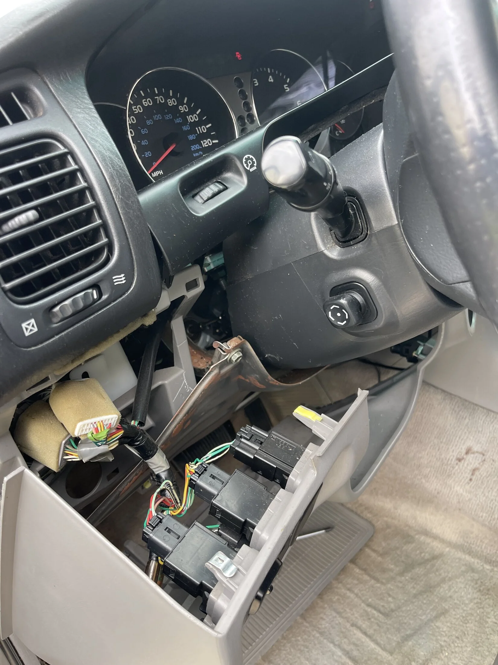

Added a red arc tow pro elite. Not a super hassle, hardest part was finding an adequate ground for the controller…and removing most of the dash. The suppled trailer brake blank doesn’t fit my only open blank- had to coerce it in there with a few strong words.
Crazy how similar the colors are.

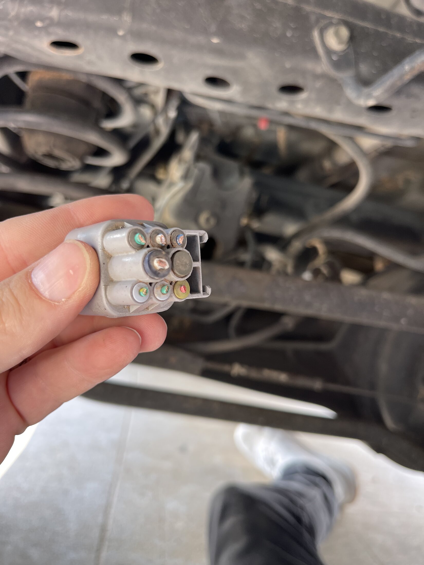

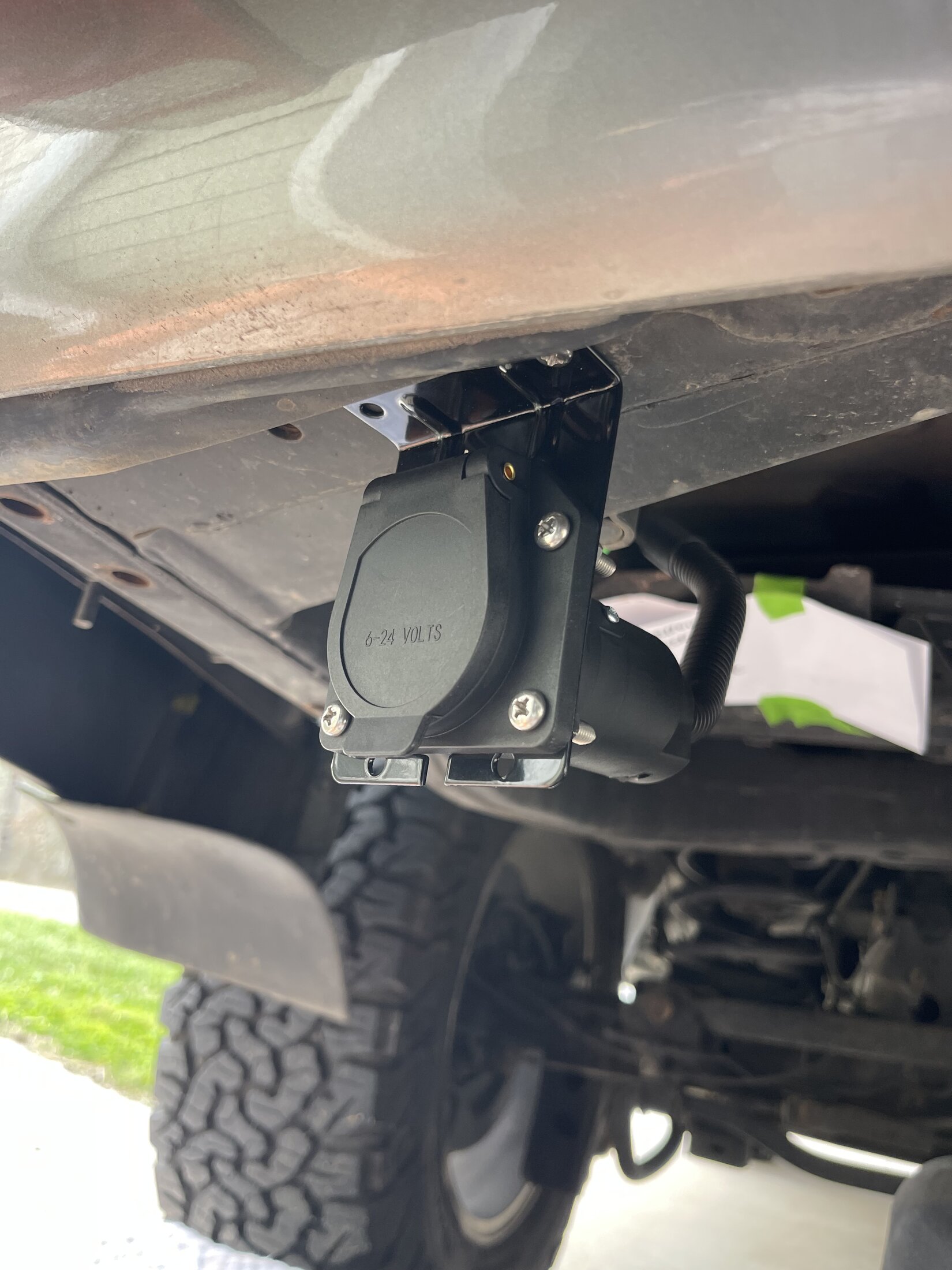

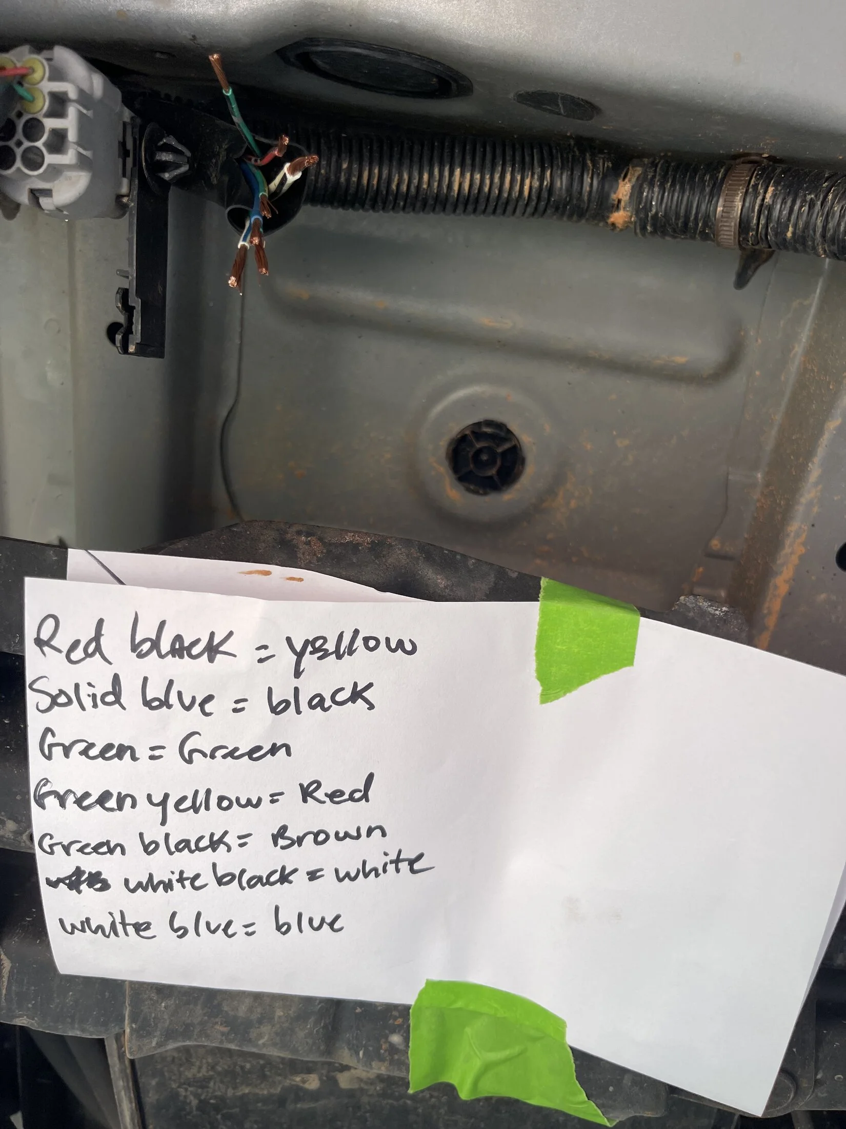

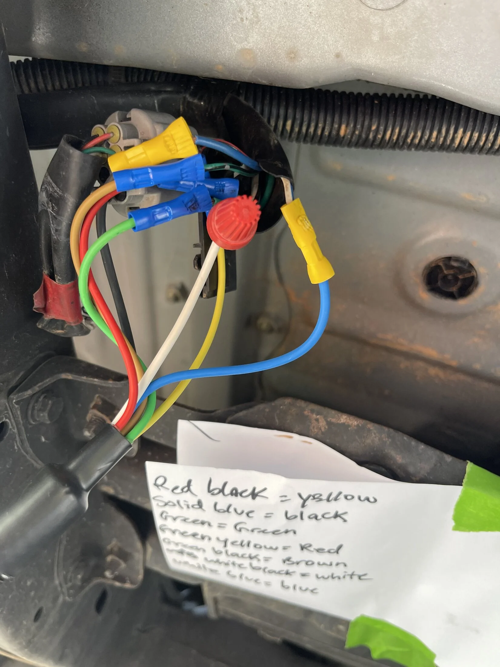

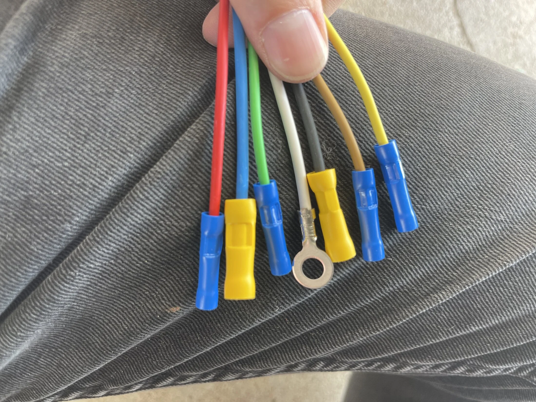

I don’t know how to turn this into a build page…kinda turning out to be one sooner than I expected. Mocked up my 7 pin connector today.
1. Trailer side connectors
2. Cheat sheet
3. Mock up to test connections
4. Possible location for the 7 pin housing
5. Toyota side 7 pin connector- pigtail connector was discontinued.
if it all works I’ll remove the plastic connectors and heat shrink each individual wire and then electrical tape then put an electrical guard on. Started to rain so I had to call it quits for today.

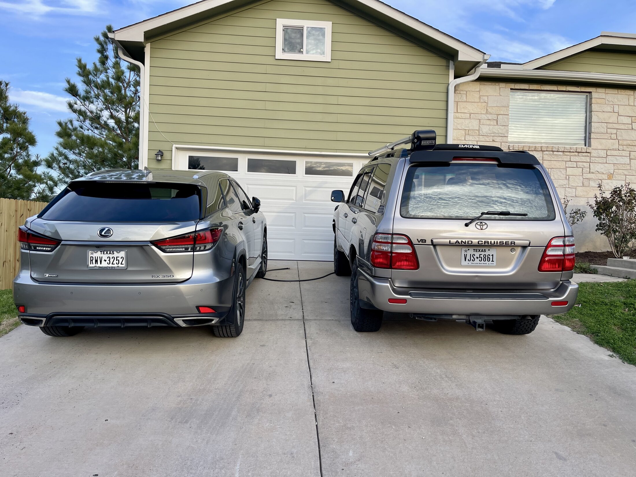

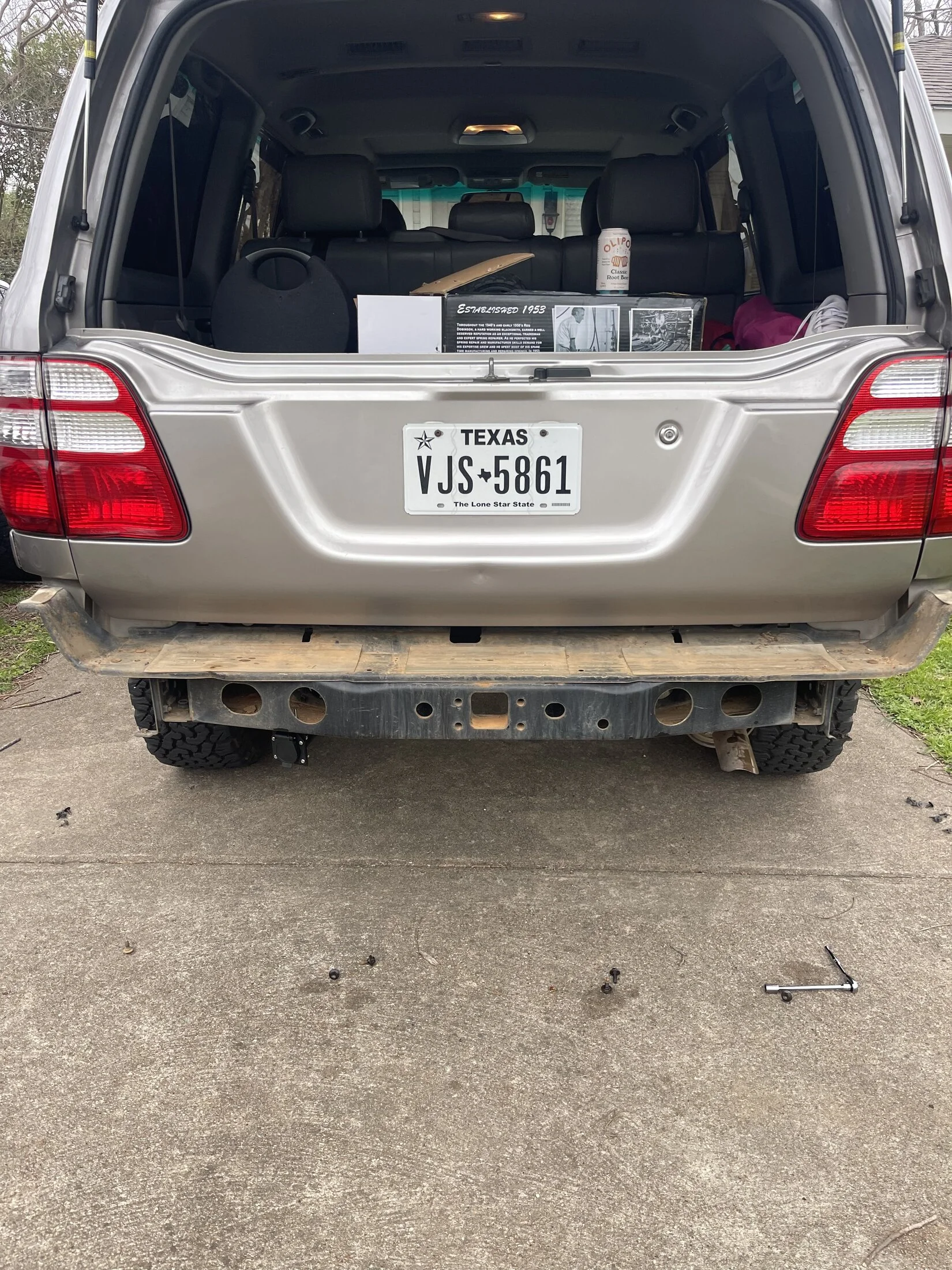

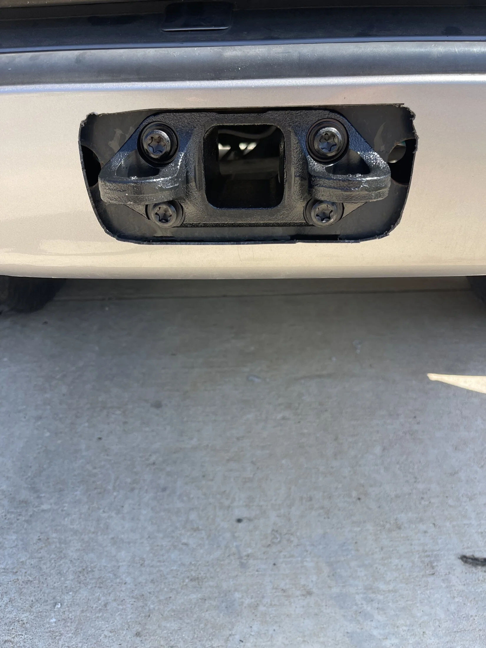

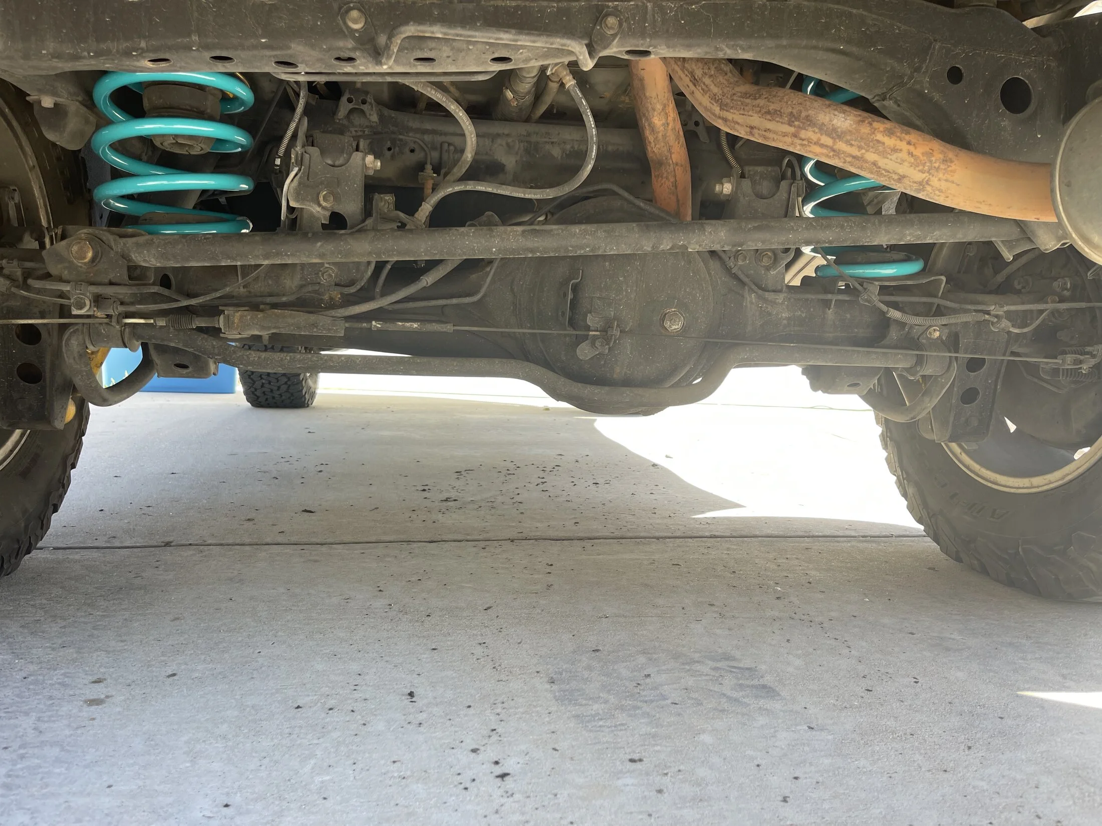

Added Dobinsons springs and helped quite a bit with the extra weight in the rear. Removed the rear bumper cover and added a hole (that I’ll clean up more later) for the Lexus style hitch receiver.
Did you have trouble fitting the hitch inside the receiver? I just bought a receiver and its extremely tight for a recovery shackle.
Great build btw very clean.
Yes it was a PITA to get it fit inside of the receiver- i used Adams undercarriage spray (its extremely slick) and i sanded down all the rough spots on the inside of the receiver.
