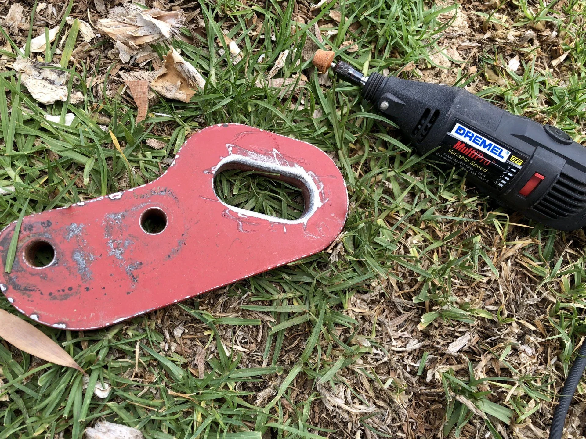

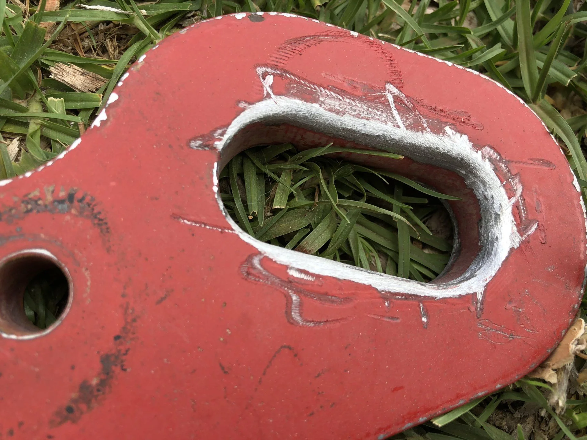

Just a word of caution re SOFT shackles used with ARB recovery points or similar:
-The inner edges of the ARB recovery points are a sharp 90 degree corner and can CUT into soft shackles (even where the reinforcement band is around the strands)

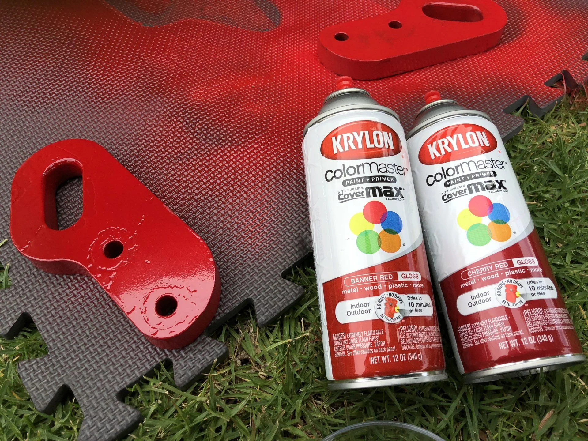

-Remedy=grinding/smoothing of the inner edges of the holes & repainting. I smoothed mine with a dremel & repainted. Made all the difference.
Just enough to take the bite off. Looks ugly at first, but it gets better...
No more soft shackle damage.
