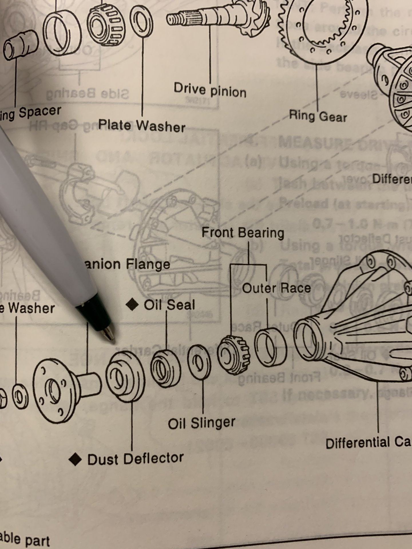

My 1997 with 227K was making a drive-line "jingling" noise while decelerating - same as the recording in post #1.

It was the rear differential dust cover/ cap. I believe it was pressed on originally, but had worked its way loose. Just put your hand on it and see if it spins, if so, there is your noise!!!
I am trying to upload the video, but if I can't upload it, the dust cap is forward facing and on the very front tip of the rear differential. Can't miss it. Good luck!
No U-Joints to replace and no cost to put some black silicone around it to reseal it (or just a tap spot weld in a couple places) will do the trick.
