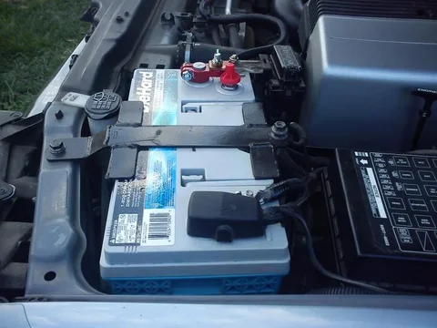

My Battery retrofit install

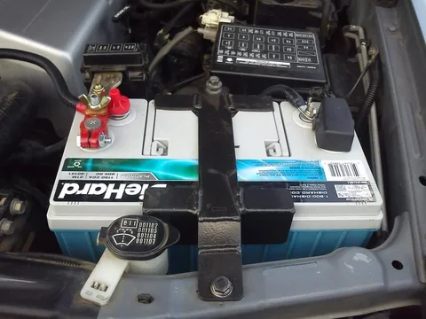

This is my install of the battery retrofit kit; fit, form and function aircraft quality! I used all of the parts except for one; I used a Hi-Lock bolt and collar to make sure the tray does not walk away. I also have adjusted the positive bar a little bit too. Sorry about the finger prints on the paint job will strip and repaint. :banana::banana: job with all of the resets included.
Btw, take a look at the windshield wiper fluid cover on your LX and my pictures on the prior page. I think mine is slightly rounder/fatter, which is why I may have had more interference from it than others have reported...
I never knew that there were differences in the windshield wiper fluid reservoir over the years. Learn something new everyday... :popcorn:
Looks Great!
Here are a couple of pics of my install. Thanks again Shaggy!

For those of you who want the post type connectors shown in my demo pics, they are sold at oreiley's and most likely auto zone as well. I also was able to find some terminal covers that work as well:
For the terminals that I have pictured:
Marine Battery Boots - Terminals & Connectors - Waytek, Inc.
For standard military terminals:
For the post terminal on the side of the main terminal on the battery:
Alternator Battery Boots - Terminals & Connectors - Waytek, Inc.
