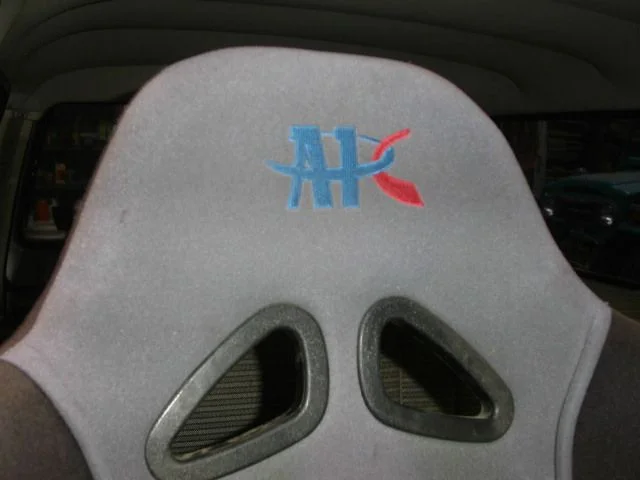

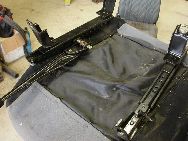

    I bought a new set of Blue A1C seats for my FJ 40 and installed them. Since I am waiting on parts for my 2F on my FJ 60 I decided to install my old Grey A1C Seats in my 60.
    When I installed these in my 40 it was a complete custom fabrication for the mounts. On the 60 it was almost a direct bolt in.

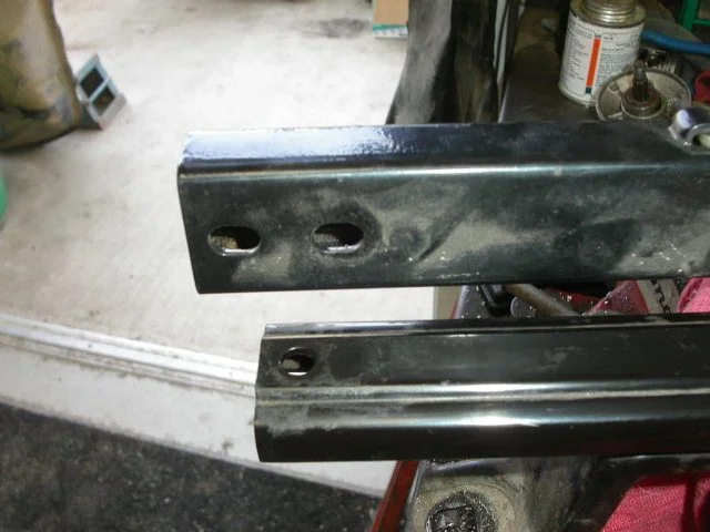

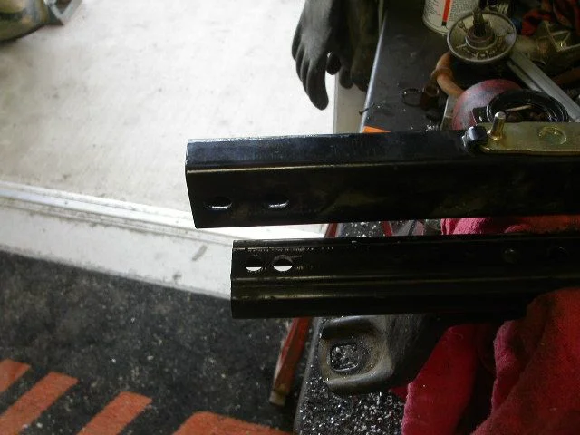

    You have to drill a hole about 3/8" in the factory FJ bracket so they fit correctly.

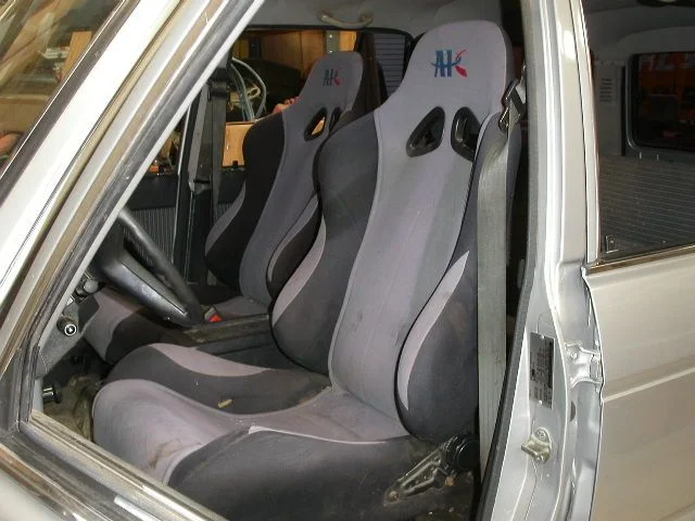

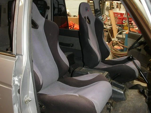

    They bolted right back in using the factory holes and bolts.

    There ya go... now you can corner at blistering speed and you won't fall out. They look comfy.

    They are the wide back version for us full size people.
    They are really comfy. Georg sat in them and I think he liked them.
