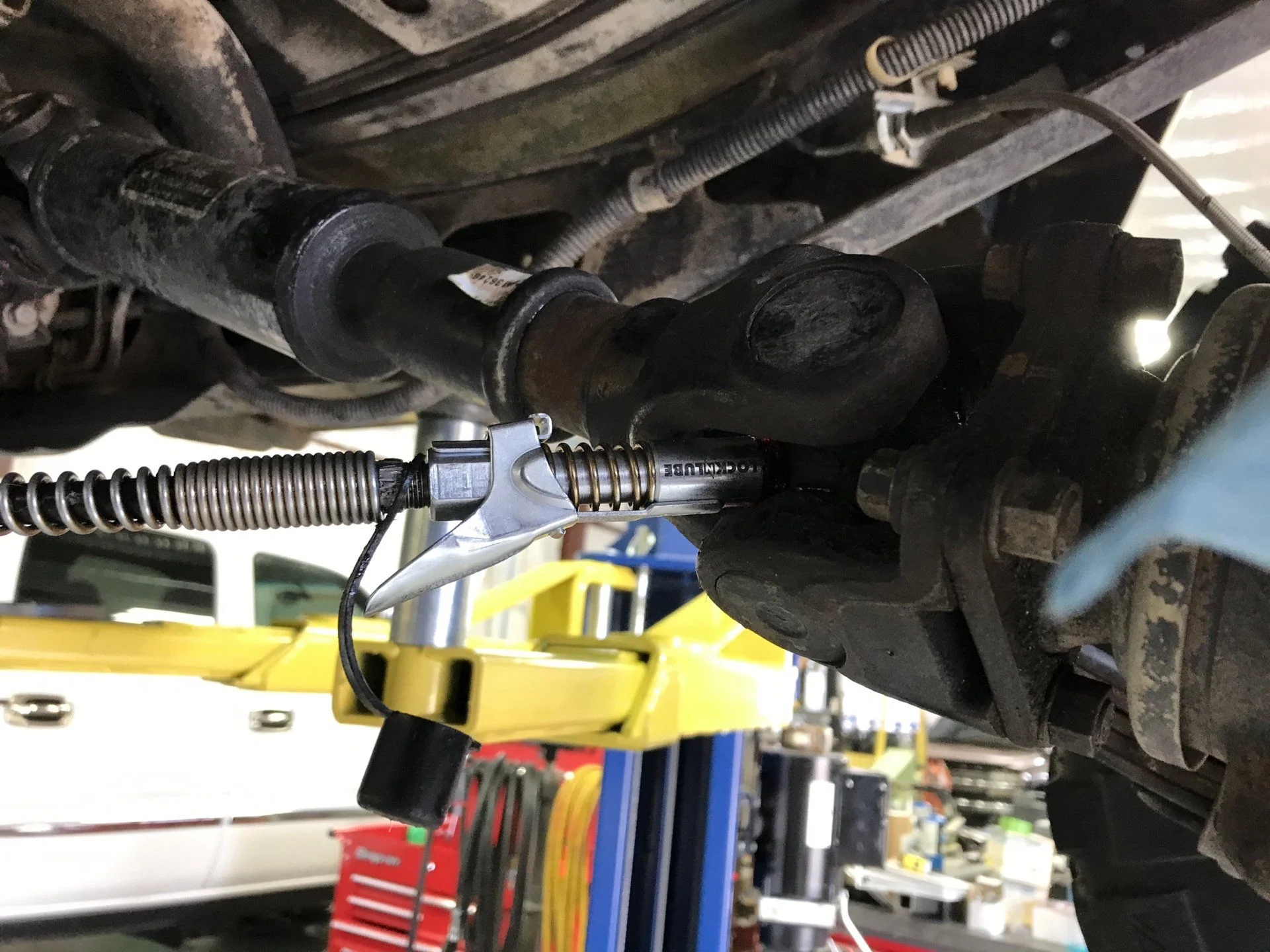

Lincolns are nice but I prefer the Alemite brand. My lever Alemite is 30+ years old and works perfect. My fave is my 2 yr old Alemite 555-E Pistol Grip. The two speed feature is really nice. If you have a clogged Zurk you can flip the lever to high pressure (more leverage) and often push it clear. Very easy to purge air and prime when changing cartridges. Often a pain with the cheap guns. I had to order my Lock & Lube seperate but now Amazon has the 555-E with the Lock & Lube on it as well as a swivel. Sweet. Alemite 555-E

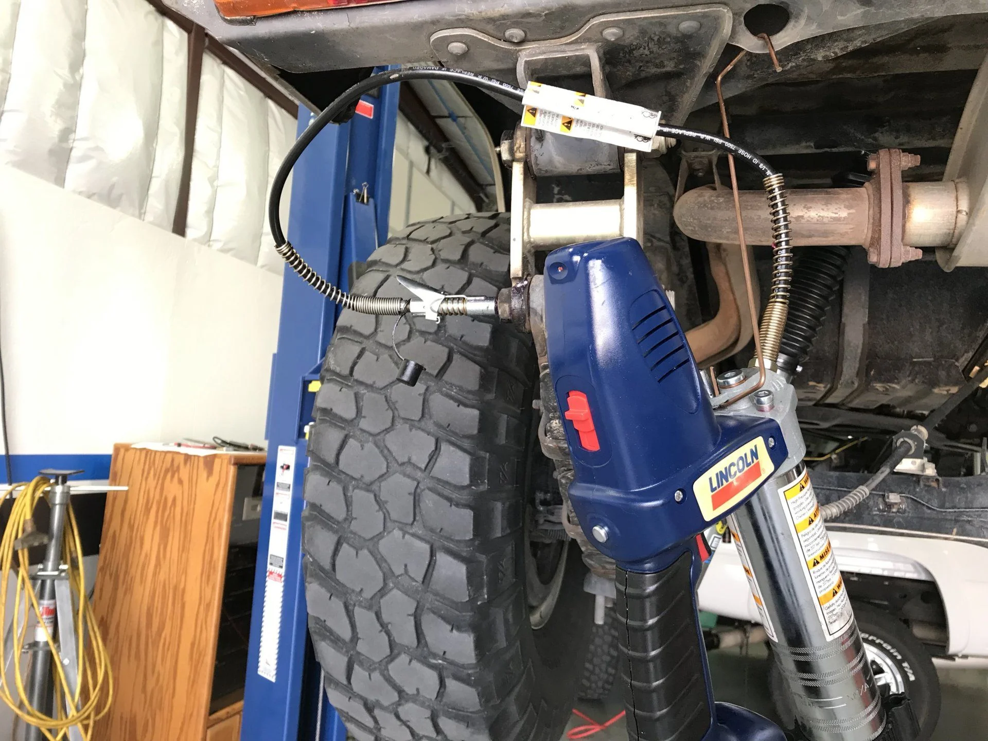

I got the pneumatic Lincoln grease gun with the lock-n-lube. Like @firestopper said, the lock-n-lube is a game changer. Love the pneumatic gun.
Search B0019COQ6C on amazon.
Thanks for the tip. Just ordered it. What fitting do you need with the lock and load or does it have everything you need?
I ordered the grease gun and one lock-n-lube. Came with everything you need. You just unscrew the push-on fitting from the end of the gun hose and screw on the lock-n-lube.

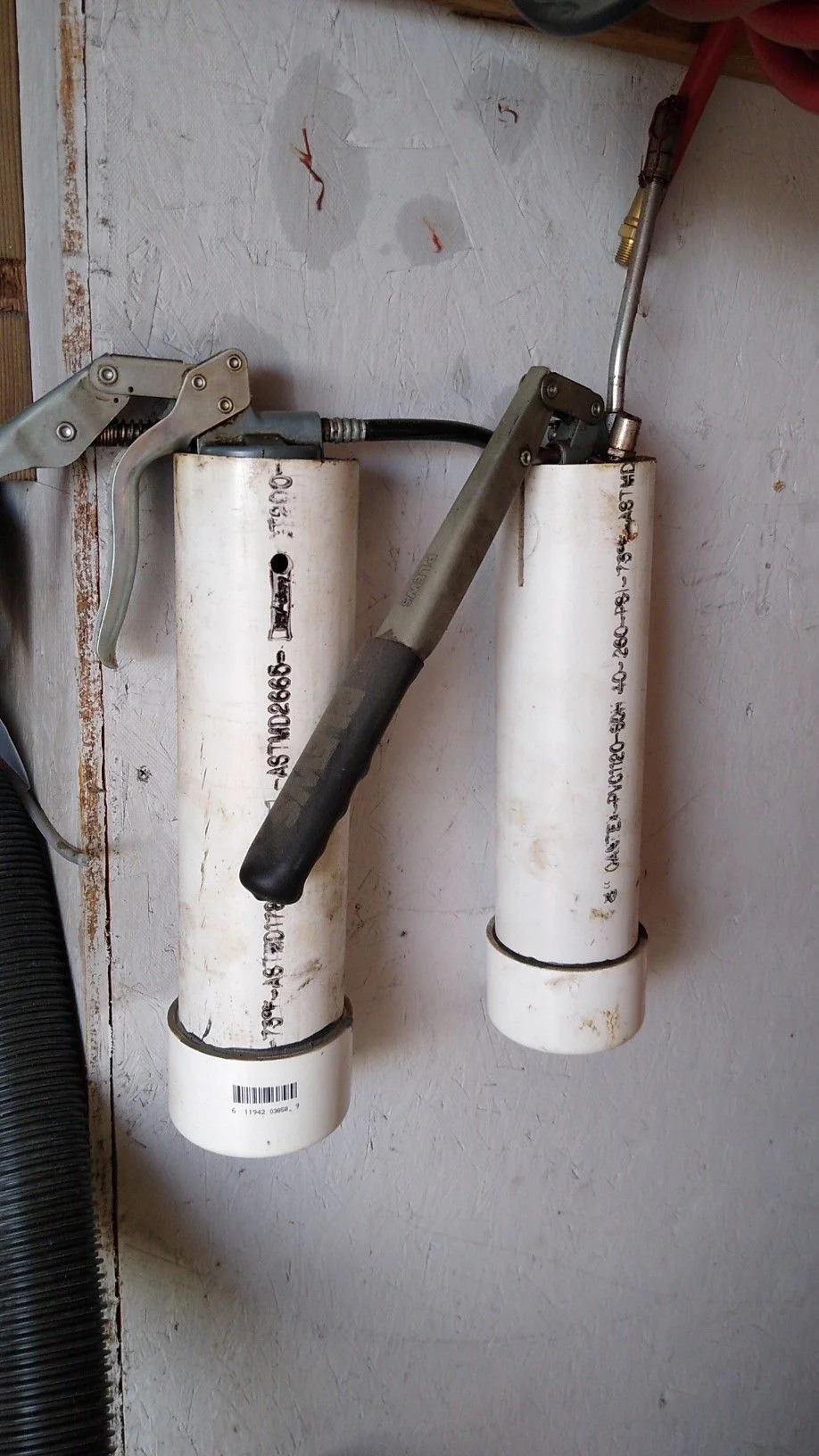

I'm new to owning a grease gun. what is proper storage? hang it from the "crotch" of lever/can? (Alemite 500). Also, when switching grease, does one do a full cleanout, or just waste the last bit of grease in the gun prior to actually using the new flavor?
Either that, or just lay it on a shelf. Sometimes a little grease or liquid will ooze out the applicator end after you use it, so I will lay mine on a rag.
I usually only change mine when the tube is empty. Rather than argue/worry over which grease is best for which application, I just use a good-quality full-synthetic grease for everything I own; tractors, u-joints, steering linkages, pedals, whatever. If I'm doing wheel bearings or birfields, I'm not using the grease gun anyway. If the birfields need topping off, they get whatever's in the gun. Some will disagree, but that's how I do it. YMMV.
