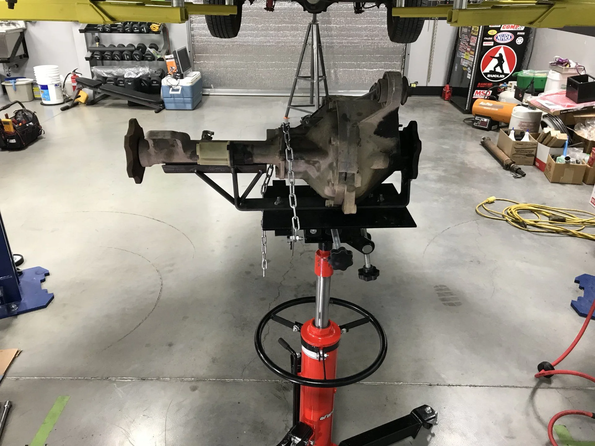

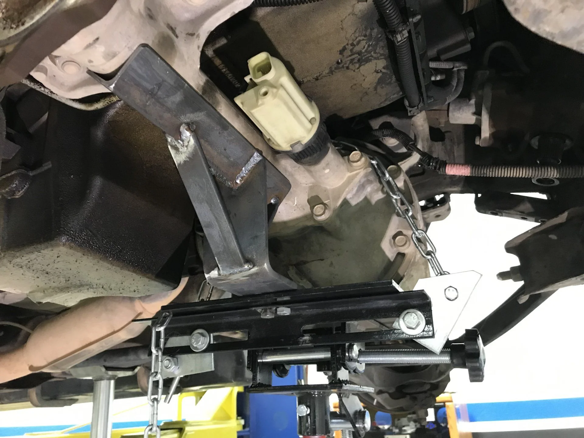

The front Axel jig was a simple design as well. Again utilizing scrap. Working alone, these things come in handy.
Notice the rear jack stand supporting the truck. Its placed under the hitch and provides plenty of stabilization.
Both jigs utilize a welded nut (capture nut) for easy install/adjustment to the jack's platform.
Owning a lift is a game changer and has paid off in the few years of ownership. Its also a good idea to purchase a couple of jack stands. Pulling large components change the center of gravity , so use those jacks and stay alive!

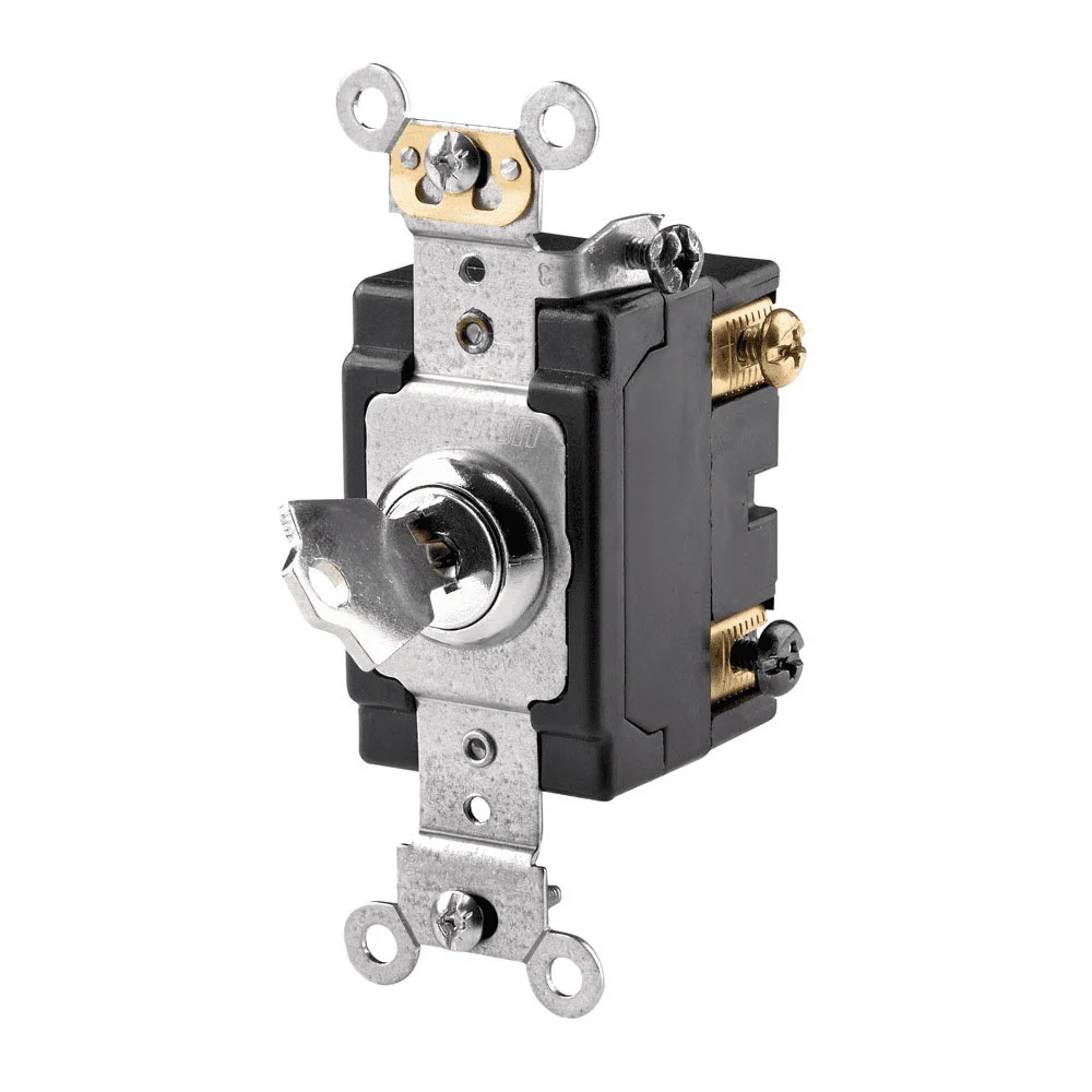

I don’t think you’ll find one with some sort of lock out feature, however, that would be easy to install on the electrical line running to it.
What I would do, is use a switch like this added somewhere near the controls and electrical coming in, and that feeding back to a relay (actually a contactor) that turns the power on or off feeding the motor. So this is simple 120 power (fed from separate source) that when keyed off will switch the 220 relay off. When on, it will allow power to feed through. I did a similar set up for my air compressor system in my garage using a typical air-conditioner relay -- I use a timer switch (not keyed) so the compressor stays on for the time I set it to, thus I always "remember" to turn it off when I am away from the shop. I had a compressor red hot when a line broke and it stayed on for hours.
Leviton 1222-2KL 20 Amp, 120/277 Volt, Key Locking, Double-Pole, AC Quiet Switch, Extra Heavy Duty Grade, Chrome Leviton 1222-2KL 20 Amp, 120/277 Volt, Key Locking, Double-Pole, AC Quiet Switch, Extra Heavy Duty Grade, Chrome - Wall Light Switches - Amazon.com

You could also just set up a switch that you could put a padlock on. Cheap, and when your kids are older, you will not have to mess with the key.

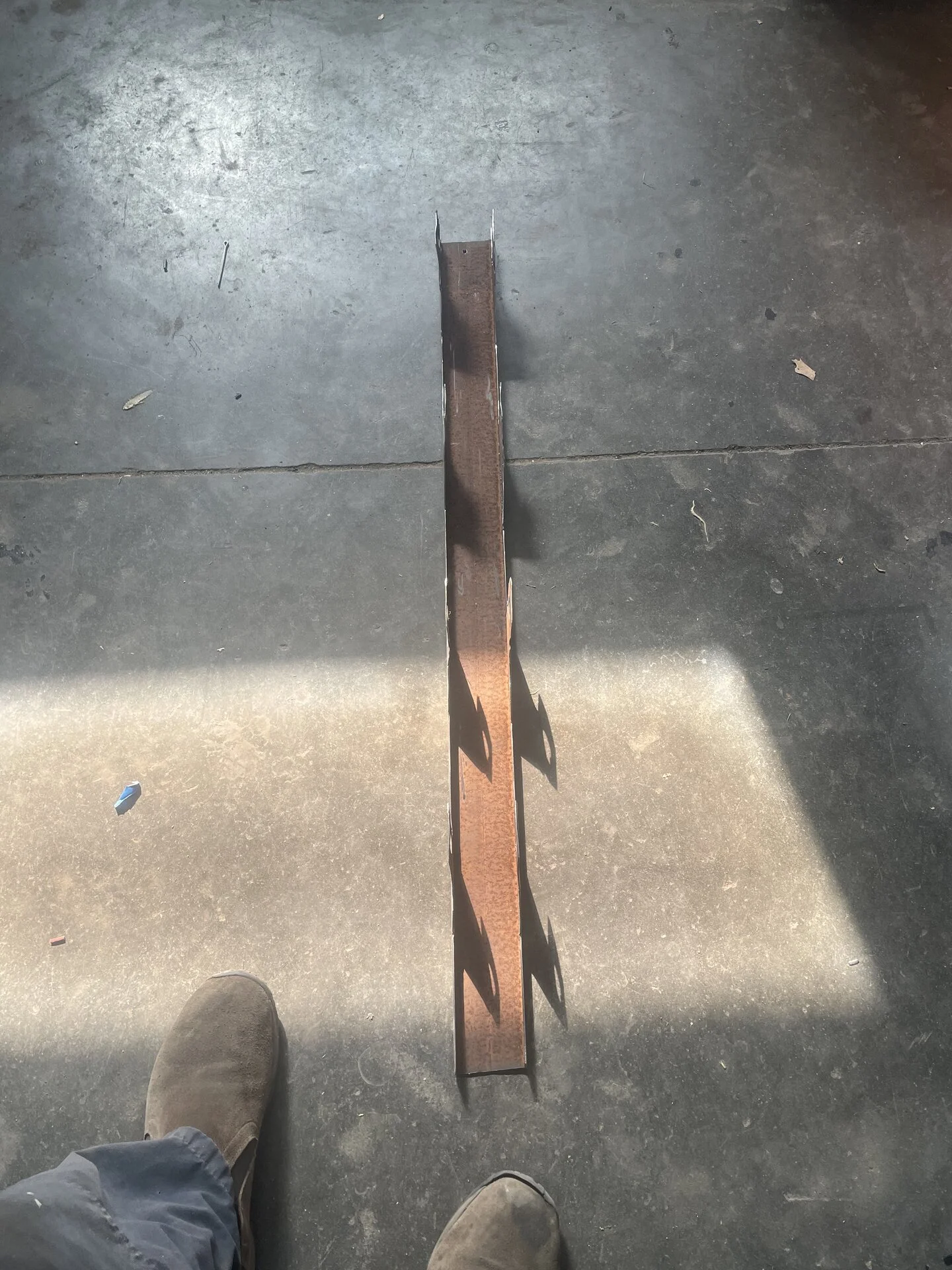

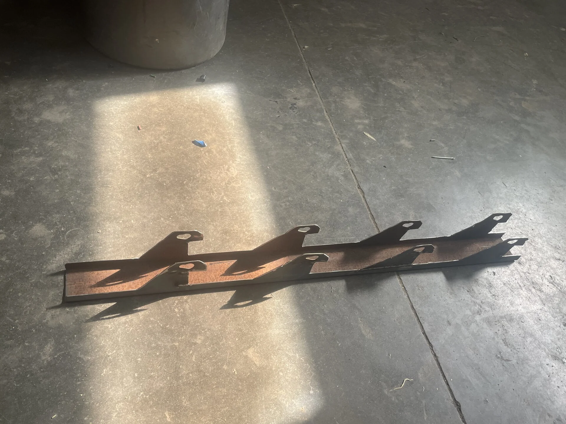

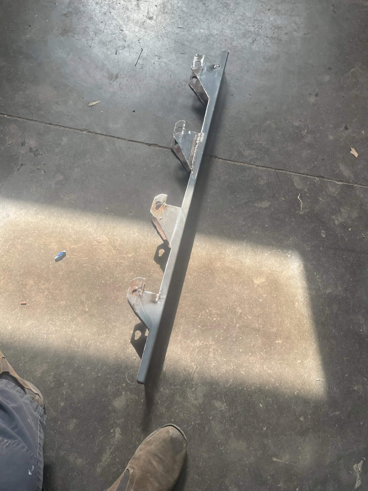

Just made these and added this to the side the lift
