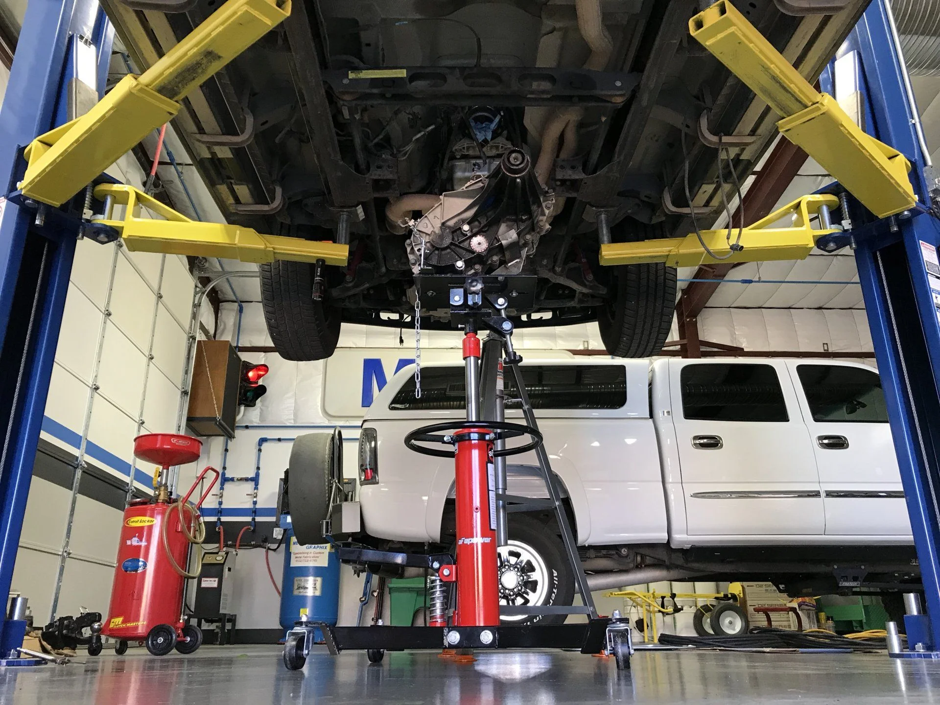

Thinking a tranny jack would be good. Any brand recommended? Found this on ebay.
1100lbs Transmission Jack 2 Stage Hydraulic w/ 360° for car lift / auto lift | eBay

I have a transmission jack if you want to borrow it. Somewhat of a pain to store a unitasker tool. They make an adapter for your floor jack that works just about as well. But since you might be doing this at shoulder height.. you are on your own! Only issue i have had with a transmission jack on a landcruiser is the jacks are designed for rear wheel drive regular transmissions. the tcase clocks them counterclockwise and takes a bit to orient them straight on the jack. Blocks and ratchet straps are your friend. Just about as easy to use an engine hoist inside the cab and lift it from the floor. Wish I had your real world problems..
A transmission jack is awfully handy, if you're removing or installing transmissions and transfer cases.

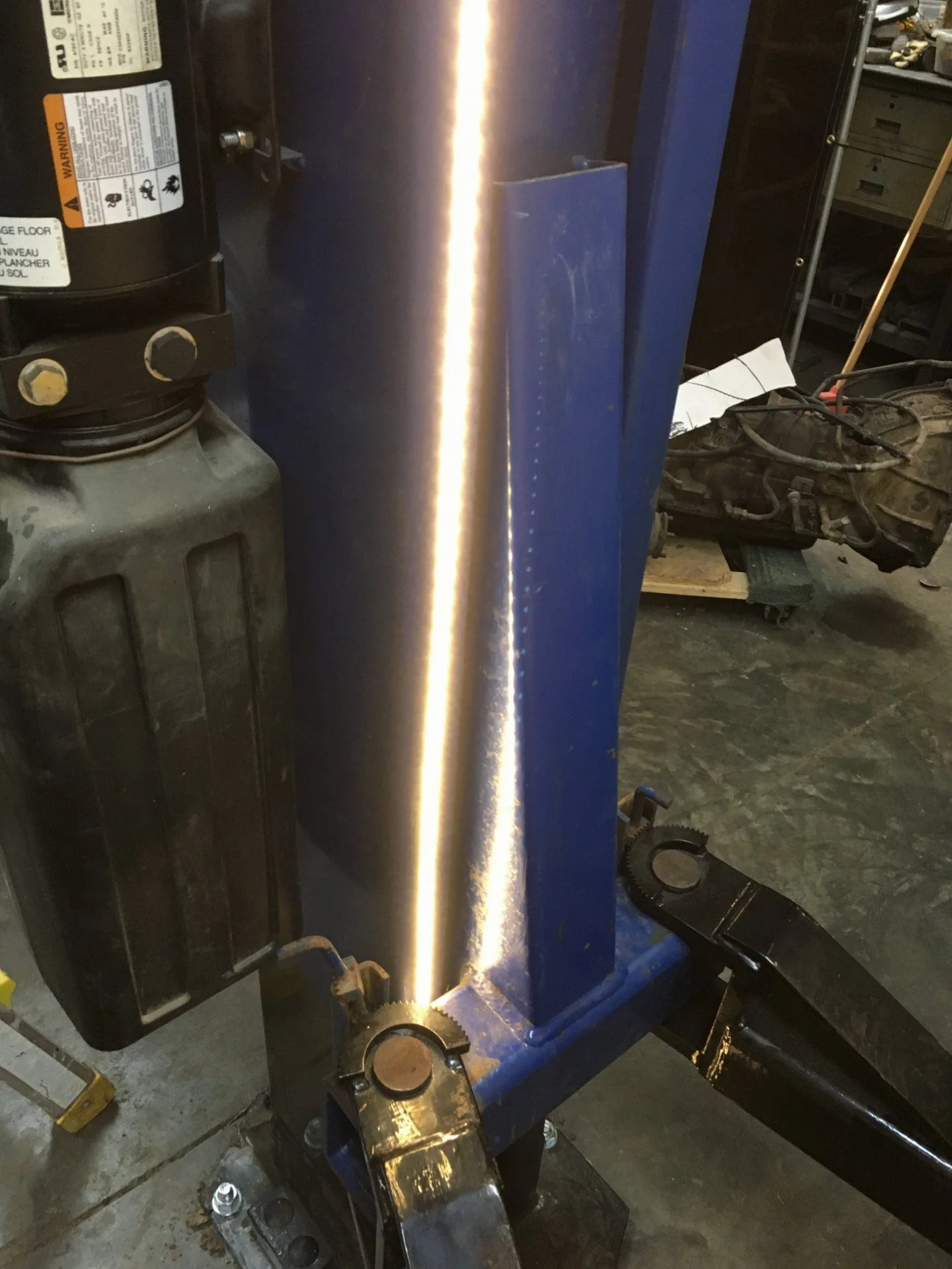

This weekend I decided to try some LED strip lights on the post ... worked out great. Not too bright that it blinds you, and added lots of light under the car

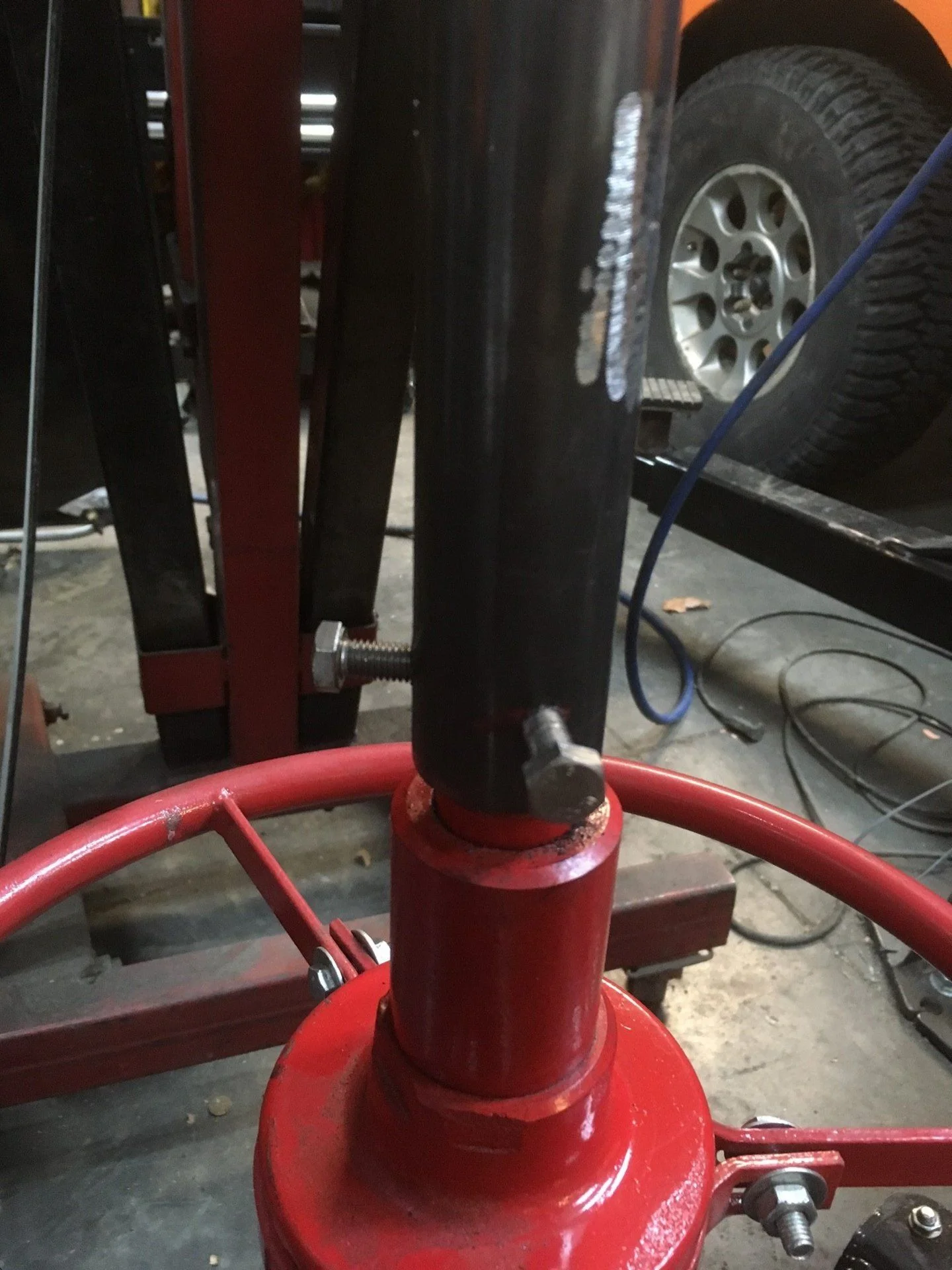

Kept having the tranny lift not quite reach the tranny, so we would lower the car down, then crouch down and bang our head, so I added an extension to the lift. Found some scrap steel about the right size, tapped and put some bolts on. Works much better now, except starting point -- where you have to lift the tranny up to is much higher too.

@2fpower nice touch with the led lights , I’ll have to look into that. I currently use a portable and it’s pretty good but some places are hard to find a hanger for it.

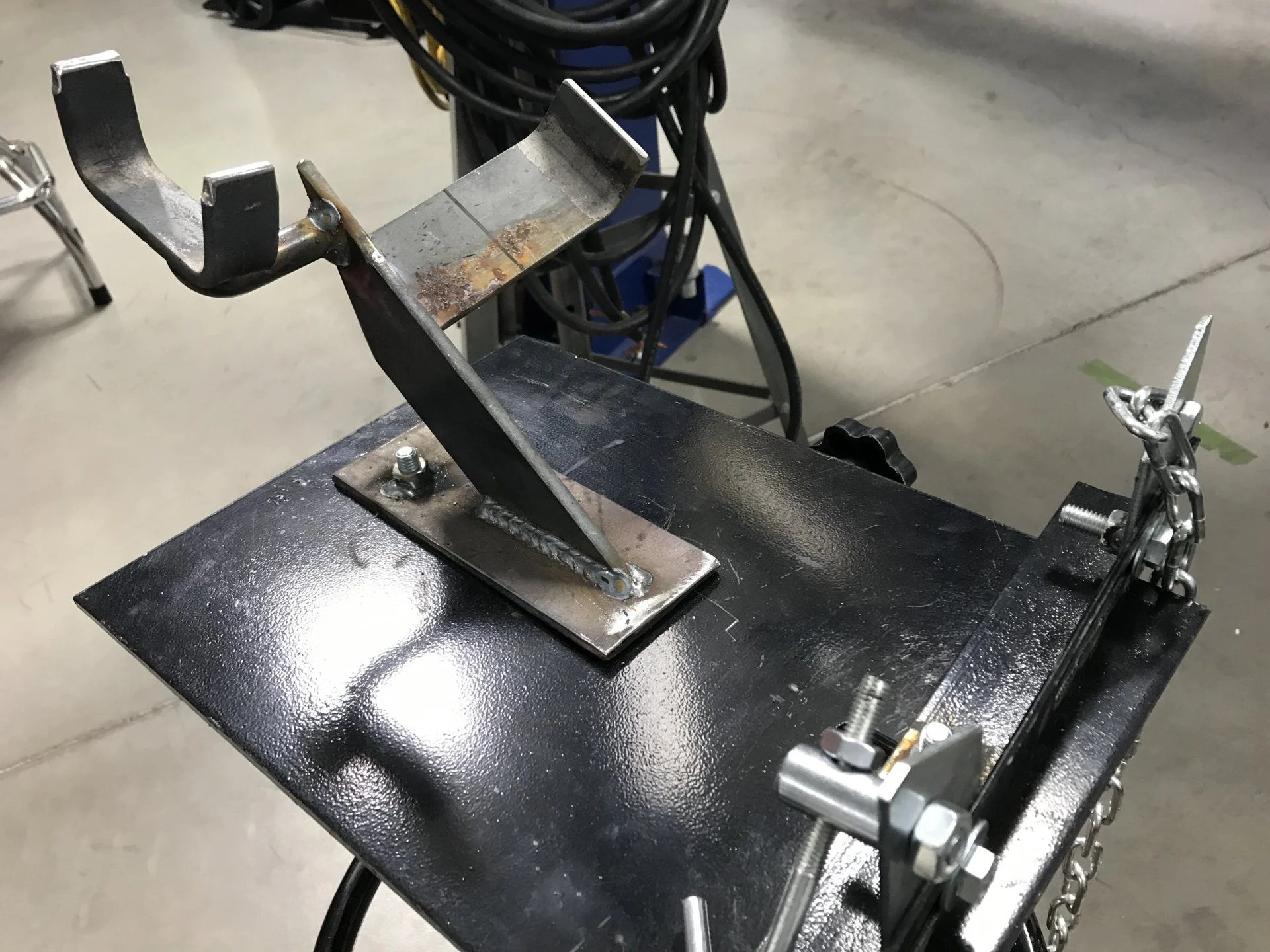

Simple scrap steel comes in handy for custom jigs. I keep a 5 gallon pail of all shorts of pieces.

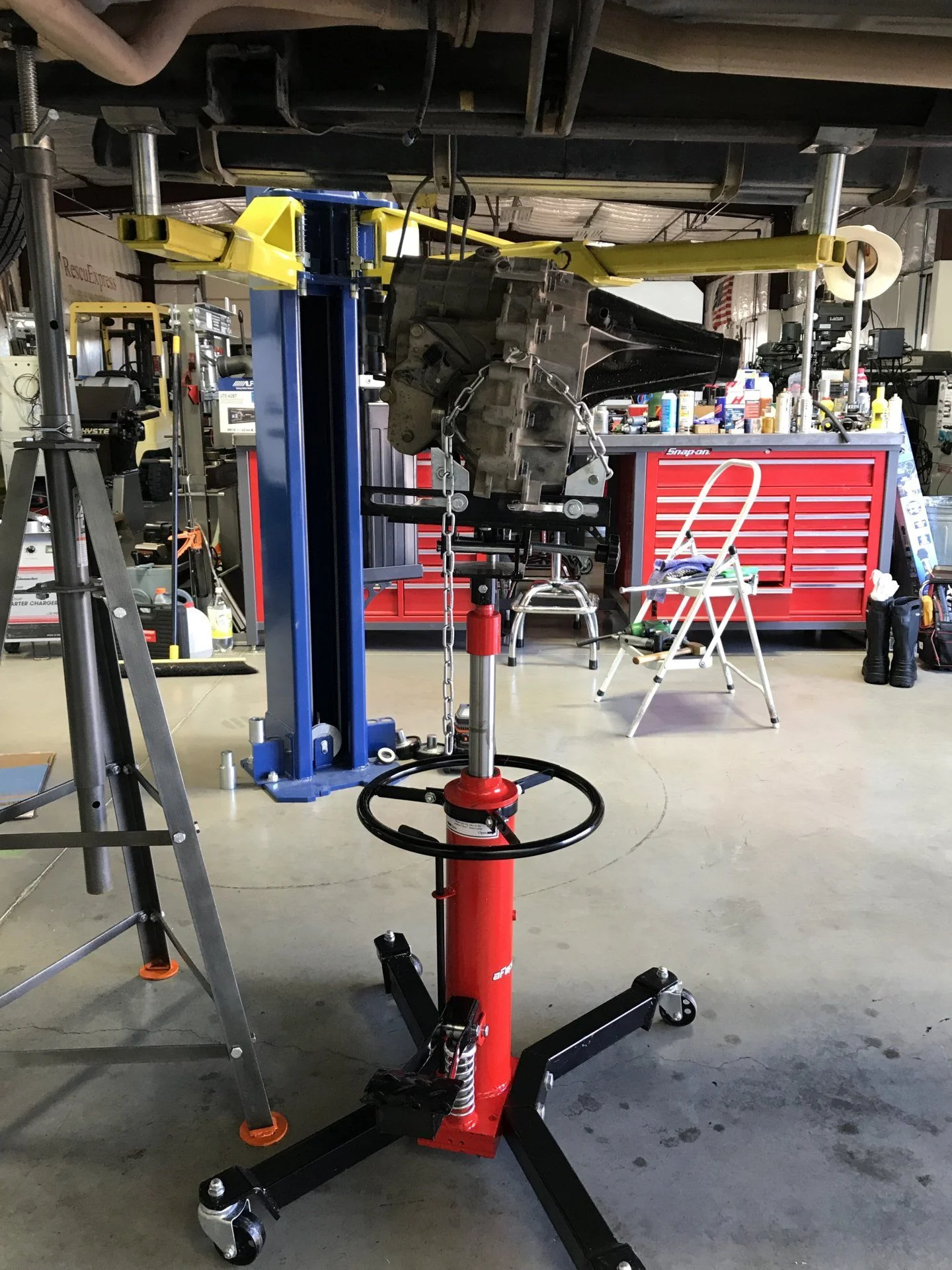

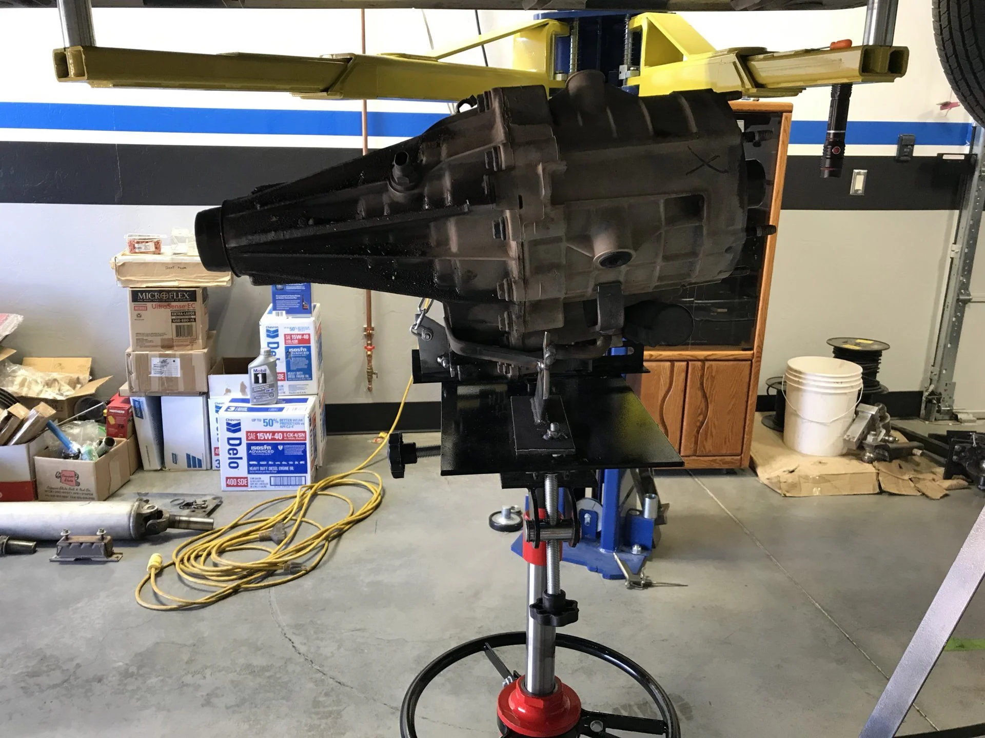

Pulled the transfer case on the wife's truck as well as the front axel.
The simple jig supported the T-case in the mounted attitude, reinstalling was effortless with all holes lining up. The imported jack is a two stage that reaches 72".
