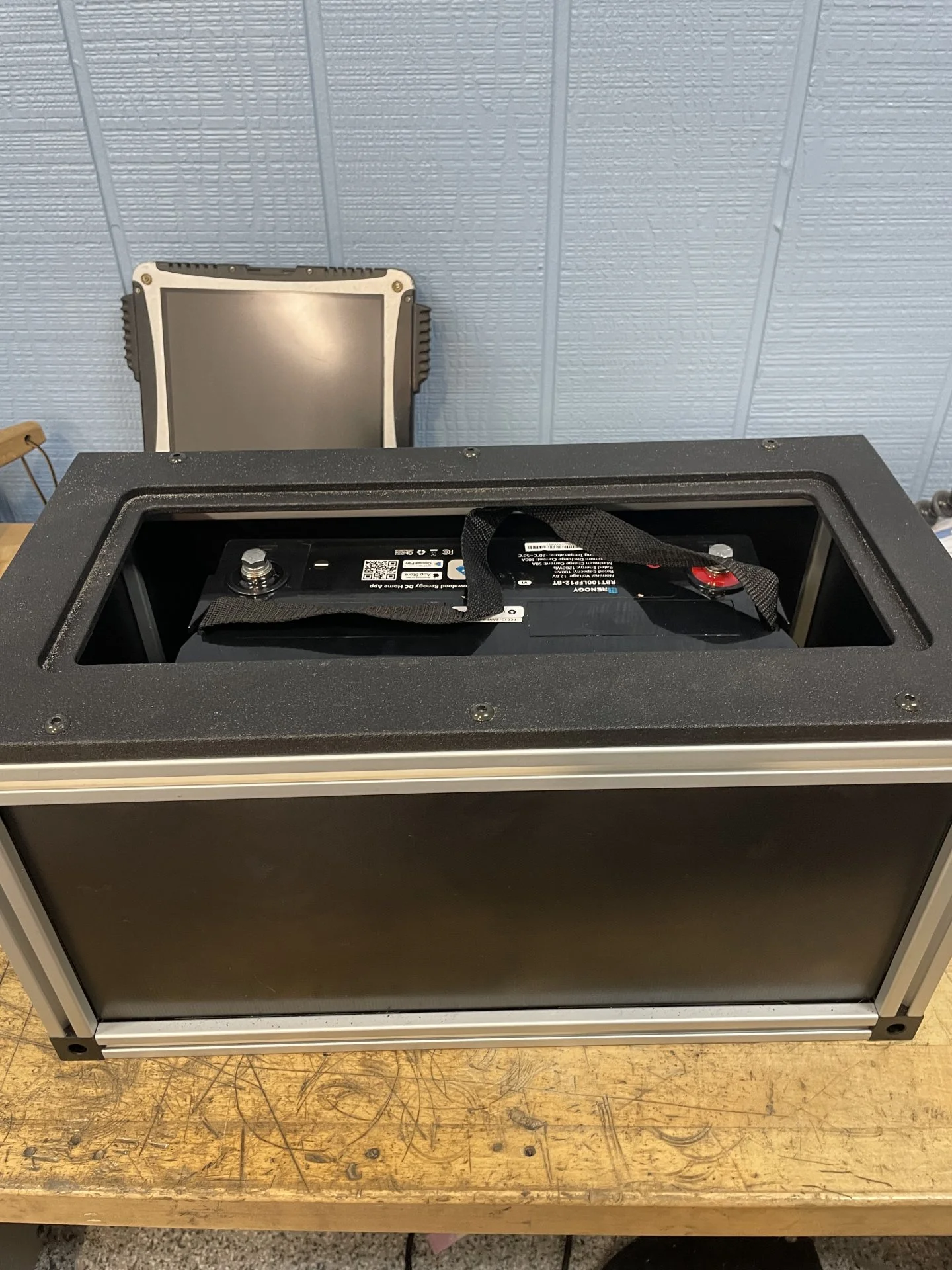

I guess before I do a thread has anyone installed a G31 sized battery in the compartment behind
The fridge box on a goose gear ultimate chef system?
I happened to have a friend whom sold me his Goose gear package.
I’ve already purchased a Renogy 100ah Bluetooth LiPo and a redarc bcdc1240d charger.
Well the battery fits with enough room to get a battery clamp in there and the top of the box fits as well, but not much else is going to go in there other than the wiring.

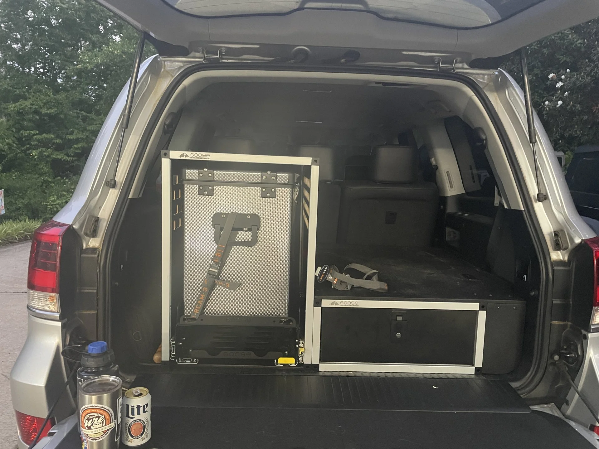

There is a wire size chart someone posted. Look at your amps and how long the wire needed is first, then it will tell you the minimum size. I ran 2 (with breakers at each end) as I had extra that size in my box or spare wire. I also put my battery in under the drive side of the ARB fit kit, which would be to the left of where the fridge is in the picture above.

I bought 25 feet of wire and running under the truck and through the drivers side grommet up to the battery box behind the fridge.. So probably ~15' so 4 gauge wire is what I am going to use.
I'll have to figure out how I am going to use the space to the left of the fridge... or maybe build a wing there.
