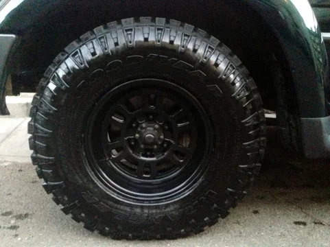

Hey Retro, do you have any pics? I want to see how the 315s look on the stock rims...as i mentioned the tire guy said he wouldnt do it because it would be pulling in the tire quite a bit...
Thanks
Thanks
In the process of rebuilding my PC so this the first quick pic of them on my friends truck (long story and he is on OME 2.5")
Thanks
FWIW in the pic those are running around 17psi. They are the D range.
