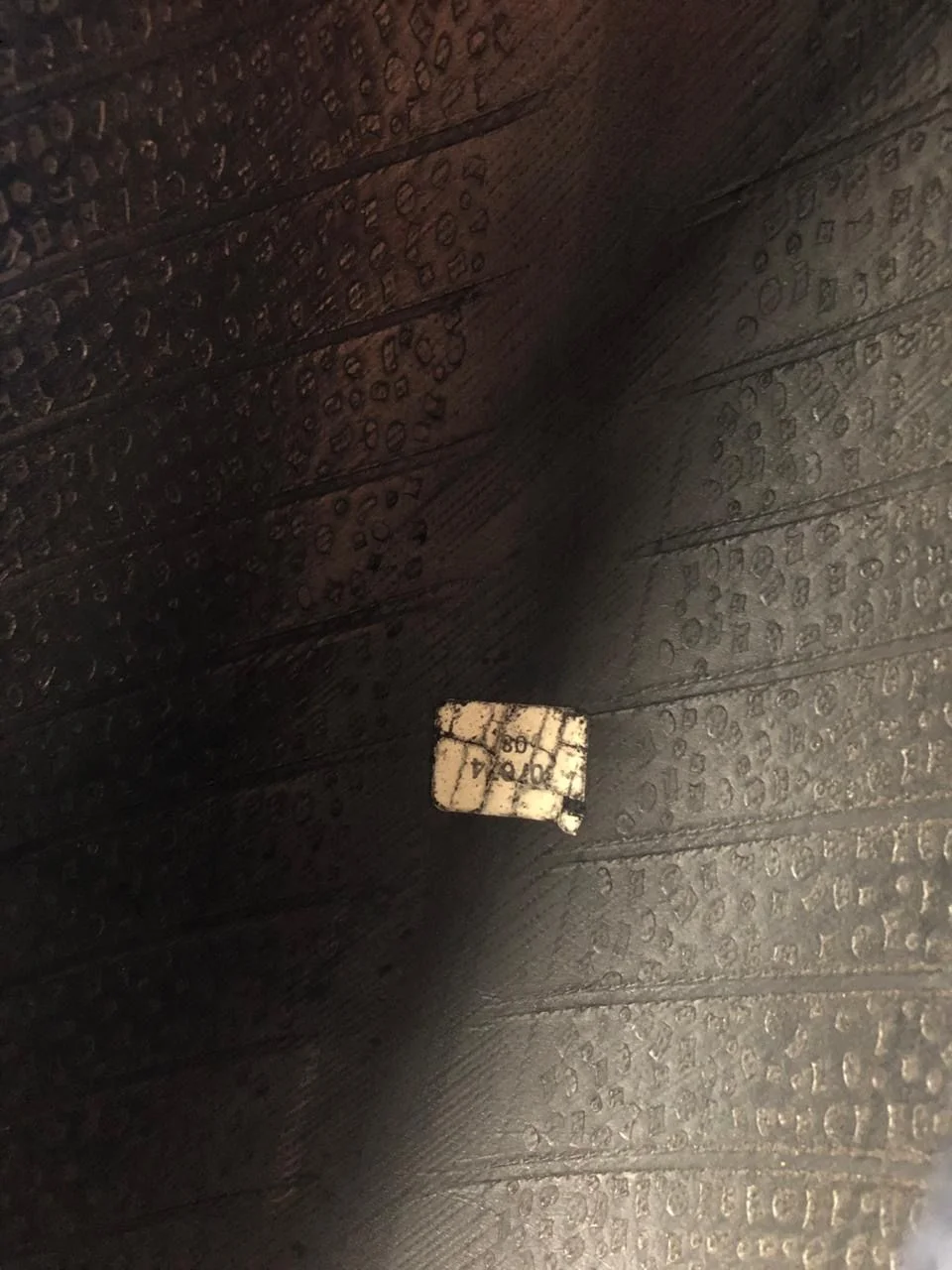

The 3rd tire was the sticker again. The 1 inch by 1 inch sticker is paper plastic like. It cracks and causes a hole. I searched with a light inside the tire. There are no punctures.

The 4th tire had a flat. It was the sticker again. So I took the 5th tire off and removed the sticker and put a patch over where it was. I’ve driven more then 1000 km since that. All is good. Driving on Patagonia dirt with many loose rocks and some pavement.
I have one tire in the back with tubeless valve in it and no tube as a test. It has also been fine. Not leaking any air. I check it often
Attached is a photo of the sticker

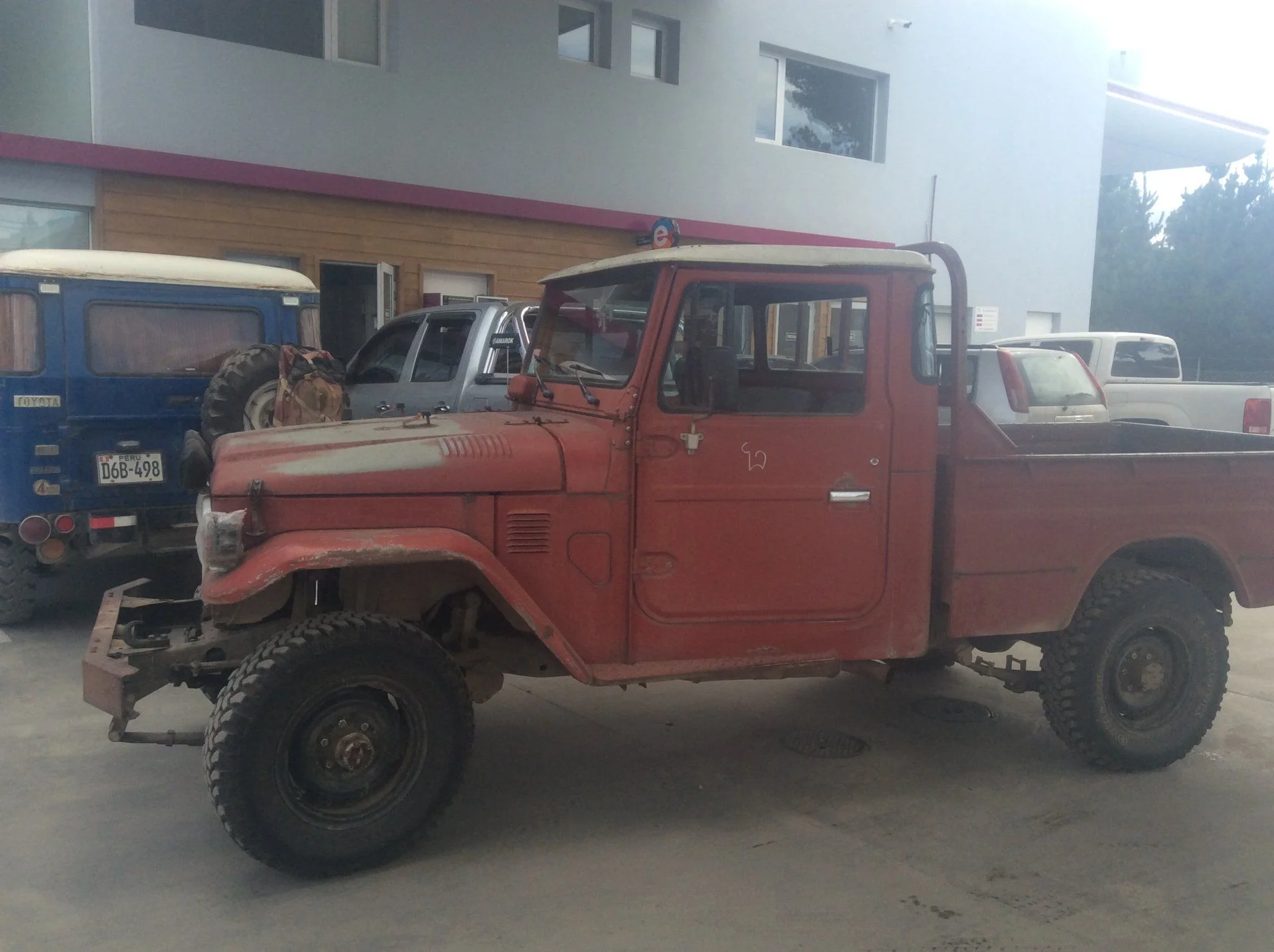

The second picture is of an Fj I saw down here. (Argentina) I’ve only see 4 so far. This one was very original. I would be very happy with this on also

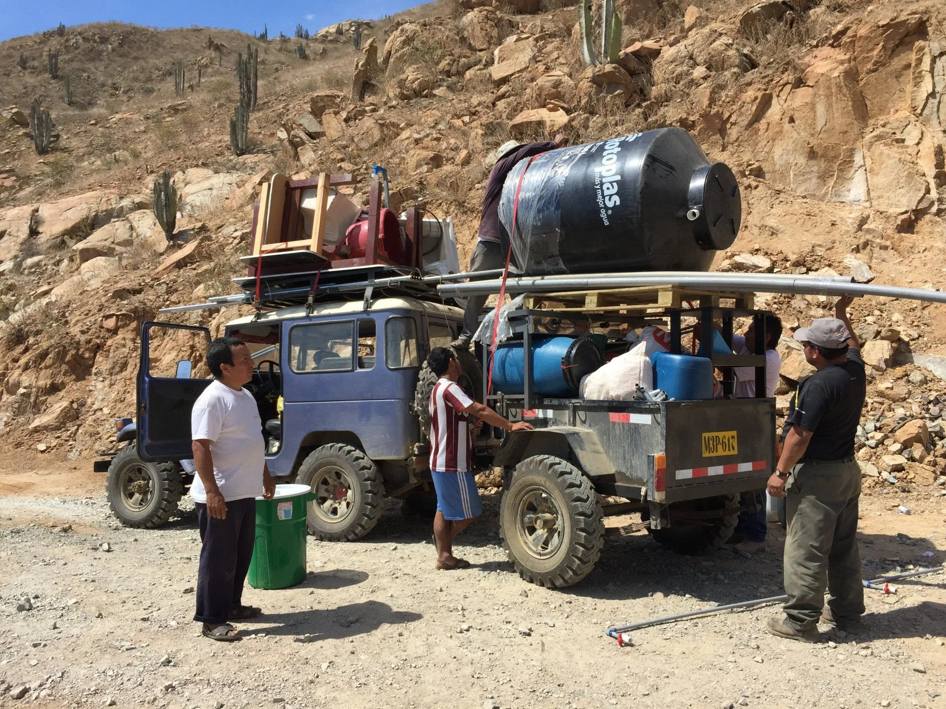

Hi Pickelltree, my Peruvian donkey has the same model tires but the 16x7.5 version. Bought from goodyear, Av. Canada, in Lima, who installed with (more expensive) goodyear tubes and liners (important). Got a good deal on 8 tires though (Burra + Trailer + 2 spares). After a legitimate puncture from a killer 6" thorn in the northern Peruvian desert, had a couple of problems due to incorrect refitting of the liner post puncture repair: you have to be careful to make sure the liner goes in as it came out, also any stickers or junk inside the tire will also make holes).
I use La Burra for work in the small mining sector and it takes me over some pretty rough terrain of all types along the desert coast and through the andes. Unless you are carrying enormous weights, I recommend you drop your normal running pressure to 30psi, your suspension and kidneys will thank you, and you can drop down to 25psi on really rough tracks no problem. Watch altitude, if you are going from sea level to 4000m, you will have higher pressure in your tires at the top, and vica versa.
The sidewall height on these "Pantaneras" as we call them in Peru is great for clearance, but at low pressure also will get you through sand better than a fat tire. I have run mine at 12psi in sand no problems, of course you are not driving like Dakar, you are going carefully to get out of a dune field and avoid a 6 hour walk in the hot sun!

Here's a pic of La Burra loaded up after dismantling an exploration camp in the foothills of the andes in North Central Peru.
