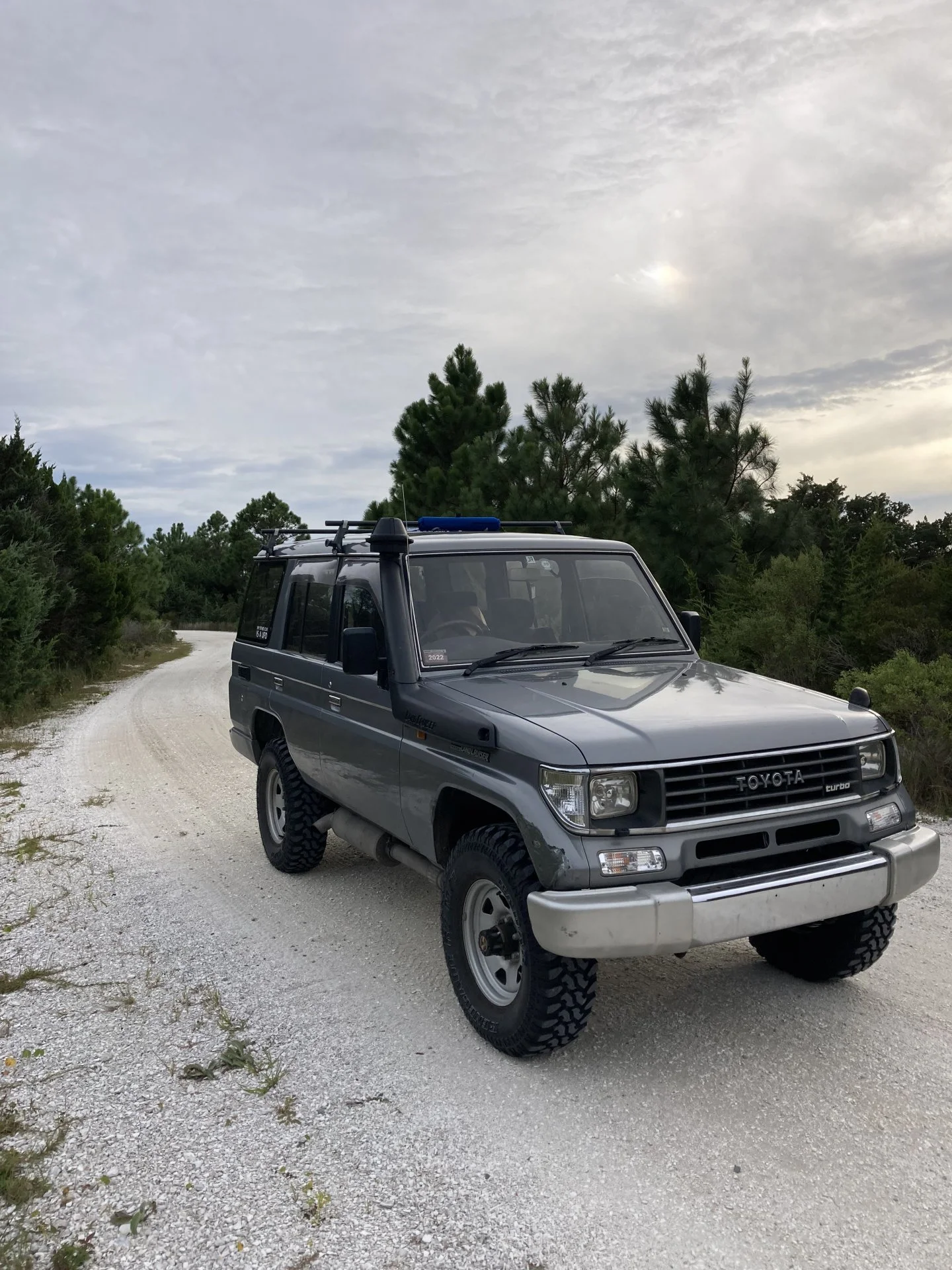

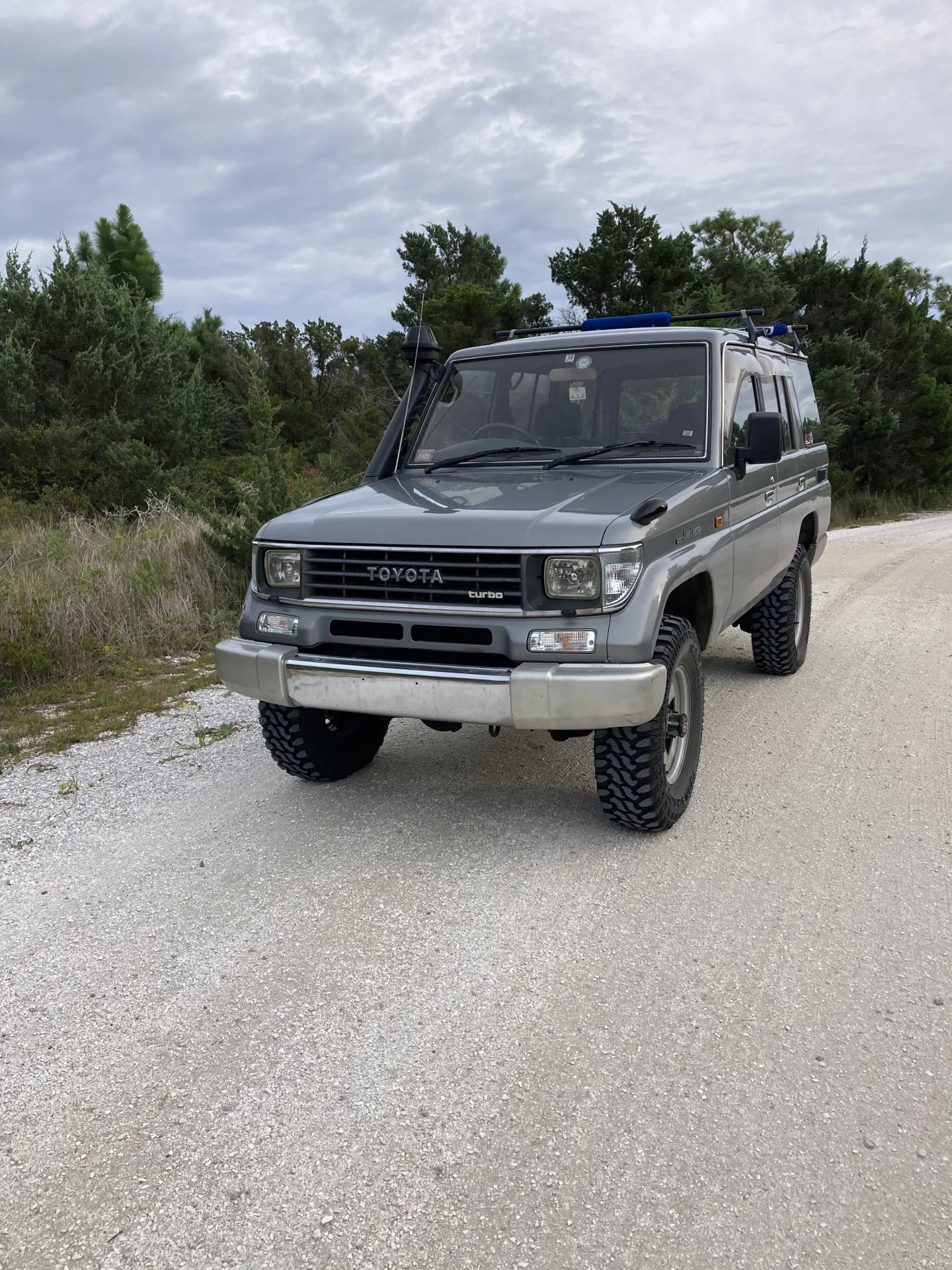

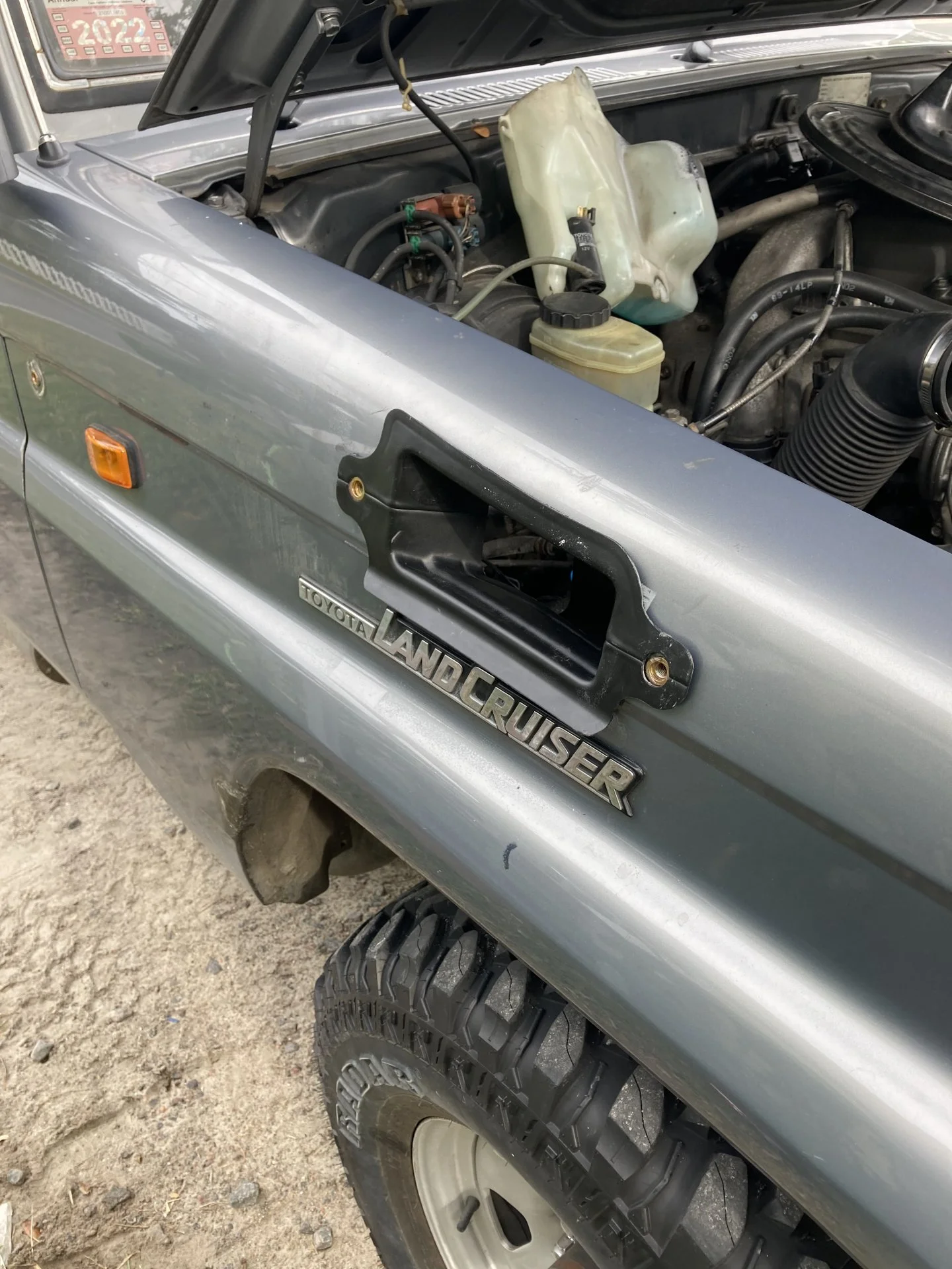

I finally got my parts to finish the snorkel install. They were stuck in Tennessee for 5 days. I ended up modifying a few parts to make it work. The inner fender duct from a vdj79 that goes to the airbox was slightly too long for the kzj78. its soo close to fitting its absurd. to make things easier I ended up using some of the old air intake from the in the fender and combining/cutting the two to make it work. (right now its just taped but I plan on fiber glassing it together this weekend). This made it easier to use the rectangle hole that the vdj79 snorkel uses. I know some people modify the snorkel to make it work. but I modified the fender duct work. I used M8 sized nutzerts to attach to the snorkel and the Toyota OEM bolts that go to the lower part of the snorkel.
I will up load some more pictures tomorrow as I will use some sealer to make everything water tight. To do this I will need to take everything apart again. But for now here are few pictures of everything installed and working!
