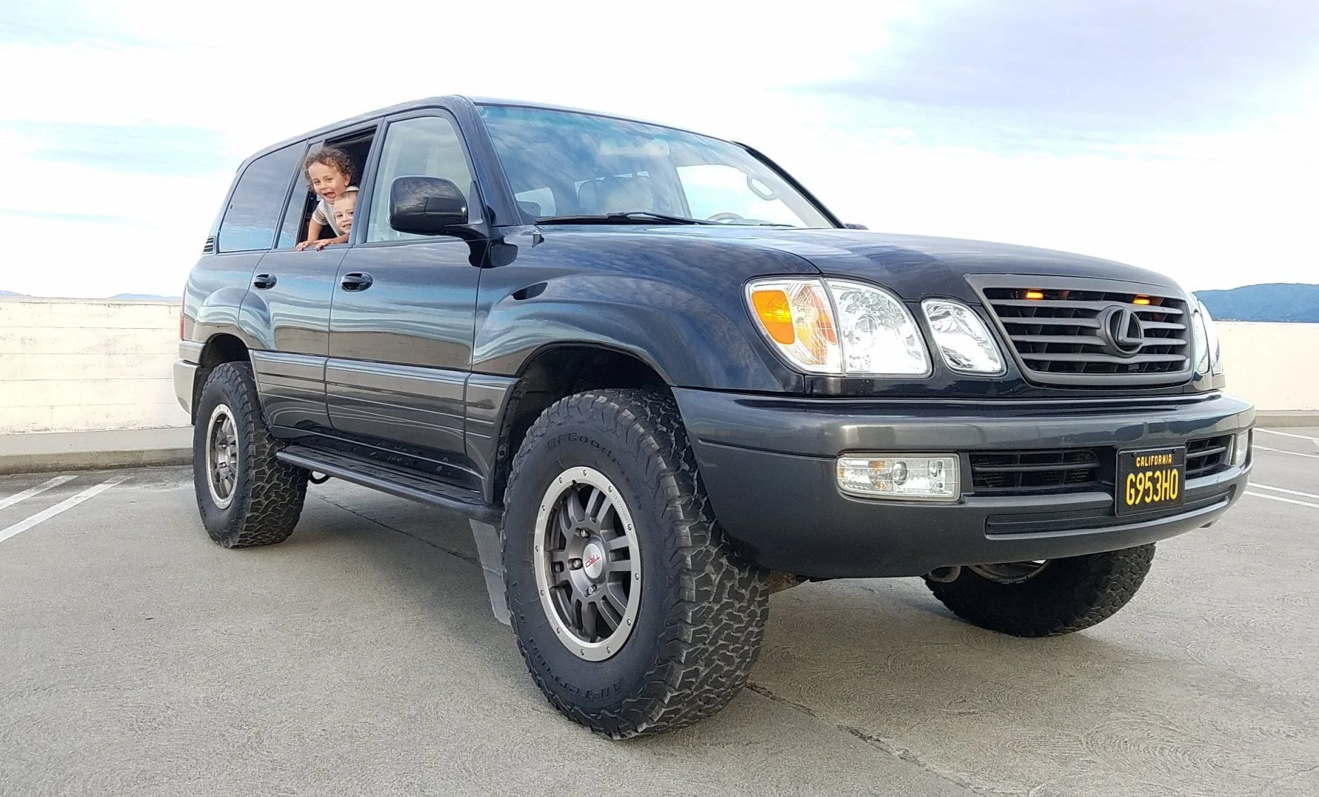

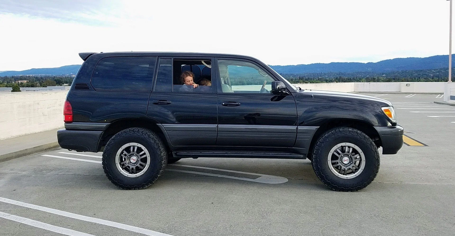

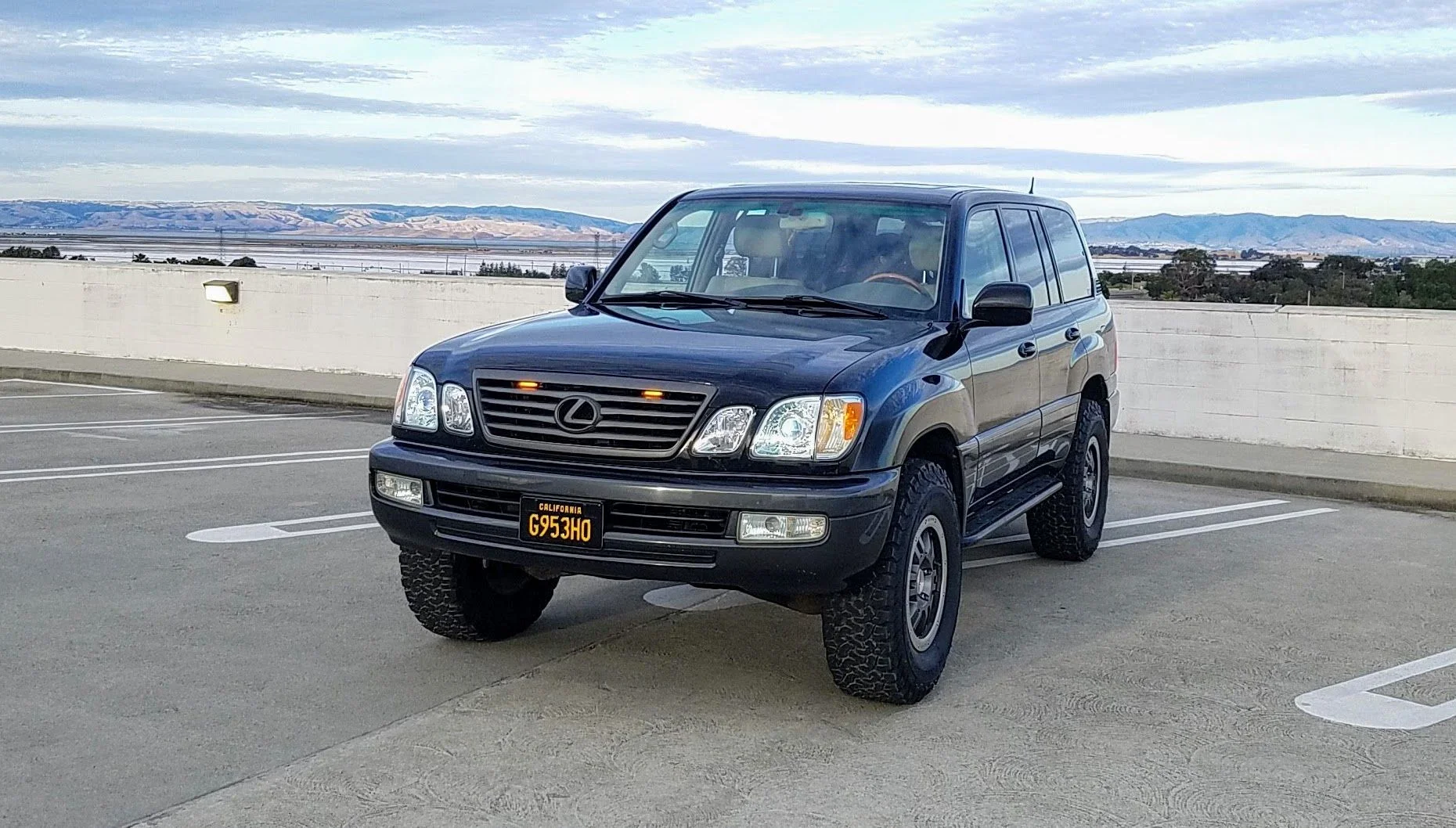

Well after much consideration I kind of took the easy way out and went with the known quantity, the BFG ko2's, 285/75/17 . This will be my 4th set and I got a nice little discount on them from America's tire which brought them in line with some of the Toyo's and Cooper's I was looking at. Also I saw both the new Toyo AT3 and the Cooper Discoverer, and I think the Ko2 has a better, more aggressive sidewall, so aesthetically it's advantage Ko2. This tire did require some pinch weld modification even though I have a 2" inch lift and 1.25" spacers...

I think thats the best looking LX470 Ive ever seen. Love the slicktop roof with the spoiler on the back, and with factory bumpers. Looks clean!

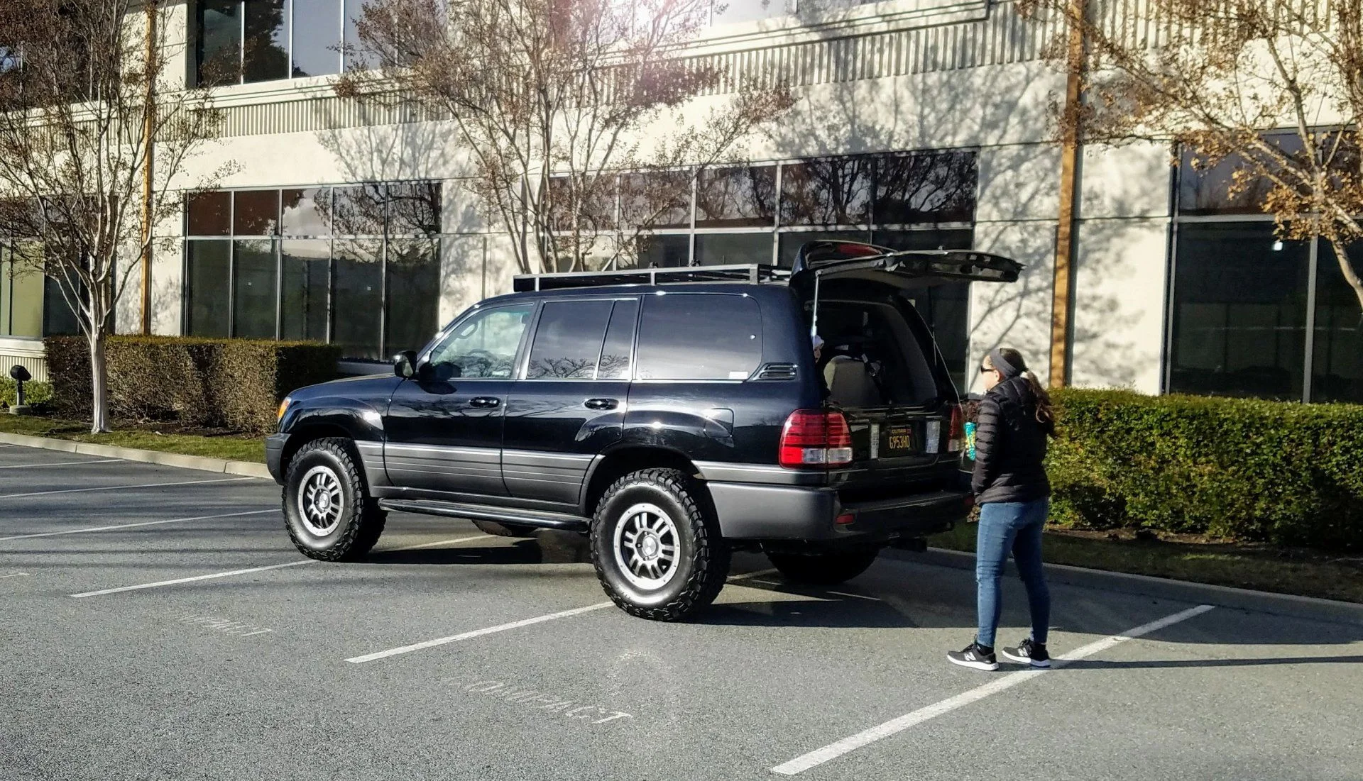

Much appreciated studawg! I have my roof rack back on these days...
Uggh! My eyes! Haha jk, I just like the slicktop look for some reason, especially with lift and bigger tires and the spoiler. Makes it look like its going fast sitting still.

if we didn't have 3 kids who need a mountain of stuff to go camping, I'd keep it no rack...
