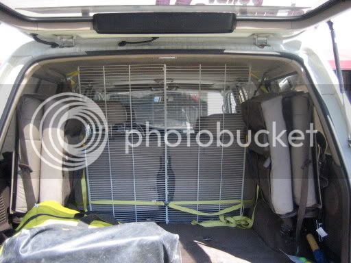

Time and budget did not permit the purchase of a proper steel bolt-in cargo barrier. However, I didn't need something stout enough to hold back air tanks, spare tire, or a portable welder, just bins of food and baby gear.

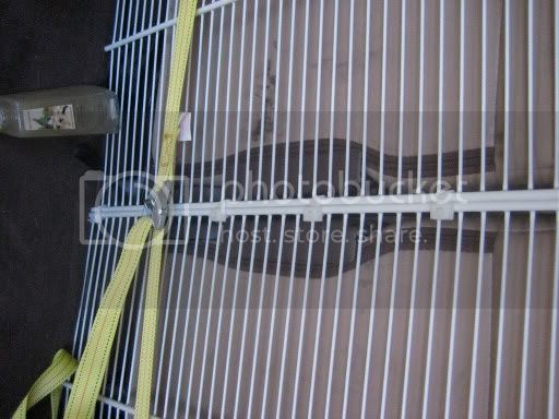

I went to Home Depot, and purchased two racks of pre-prepared wire shelving, some industrial ducting zip-ties, and four lashing straps. I think the entire thing cost around $30.00 altogether.

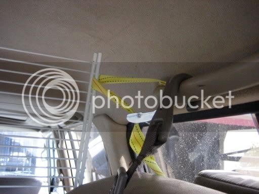

I measured the distance between the carpet and the headliner, just behind the 2nd row of seating. Could have used a set of bolt cutters to cut through, but used an angle grinder with a cutting wheel to cut it down to size. Amazingly, the two shelves, when put between the wheel wells, fit almost perfectly. I joined the two shelves together with 12 of the largest zip-ties I could find. Then I strapped the makeshift barrier to the rear grab handles with lashing straps, and finally wove one more strap through the bottom rungs and around the rear seat to fasten the bottom to the seat.
We had the truck packed to the roof with miscellaneous small items and gear bins by the time we were done. The back and front seats were empty.
Here are the pics of the finished product.
Is it a ghetto mod? Definitely. Would it have protected my wife son from gear hitting them in the event of a head-on impact? Probably not. But, I believe in the event of a slow roll, or sudden brake action, it would have kept the cargo at bay. Plus, it allowed me to pack the hell out of the rear area without having gear spill out all over the place.
