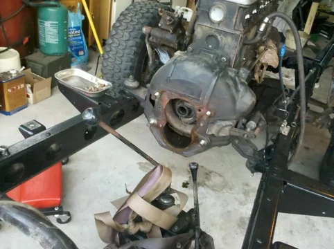

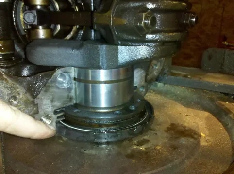

'76 2F 4spd - tranny/transfer removed, oil pan dropped and rear main cap removed. from all accounts, I should be able to pull out the rear main seal by hand and replace. Maybe I'm missing something, but the sucker won't come out - it looks like the flywheel attaches directly to the crankshaft - is that correct?

Needs to look like this:

Thanks all for the sanity check. I was hoping i wouldn't have to remove clutch/flywheel, but oh well. Thanks again.
