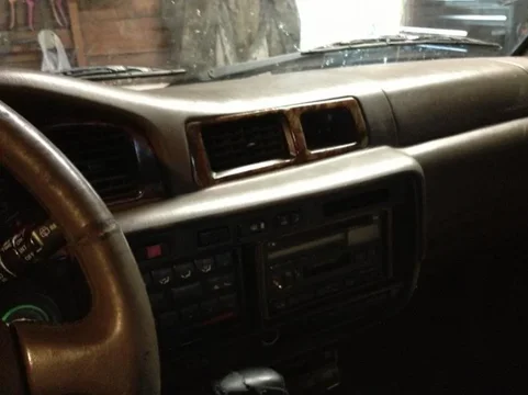

Got bored and the gold emblem was getting on my nerves. Time to bust out the rattle can.

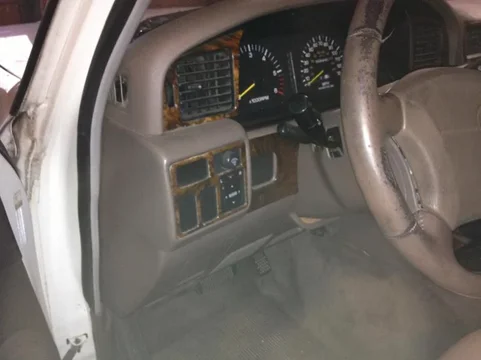

Decided to get rid of the nasty, old, and cracked "wood" trim.
Didn't get much done today but did manage to get the rest of the wood trim off. Still need to clean the new surface up a bit but I think it looks a ton better.
