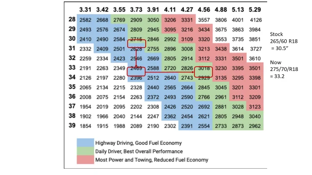

This is what I used for the 4Runner. It guided me to go from3.73 stock gears to 4.56 for the new tires. I nudged it from the Highway/Daily powerband to the Daily/More Power section. With the larger tires and stock gears it was downshifting all the time, now it's fine. The numbers in the table are RPM at 65 MPH.
