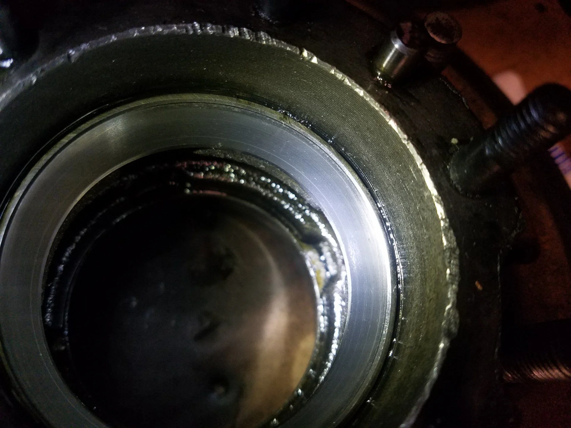

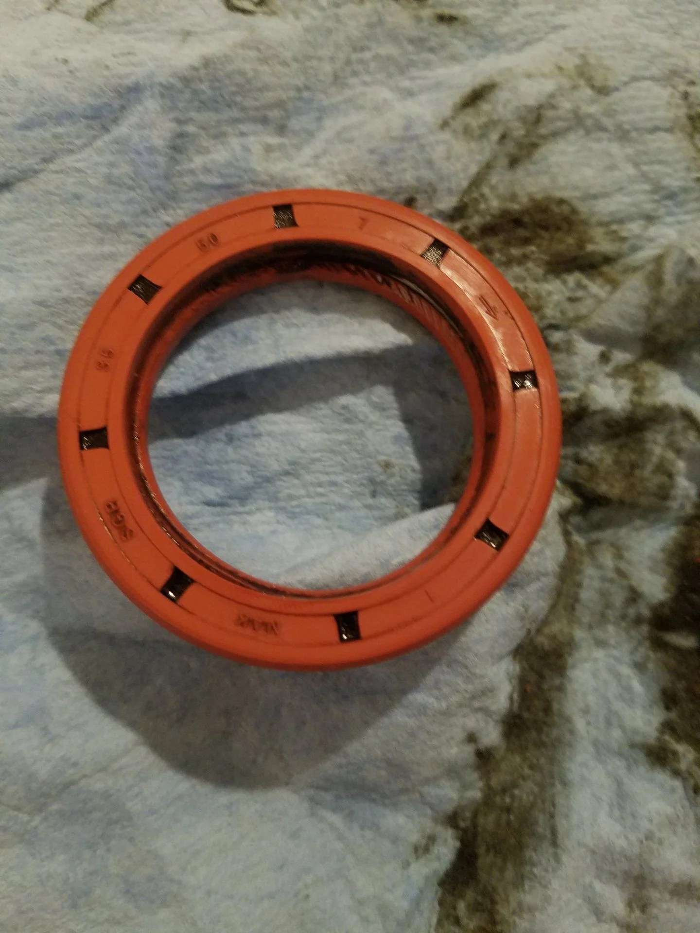

Just purchased my first FJZ80 ('94). My front driver's side knuckle was spewing gear oil onto the tire so I started a front axle rebuild. When I took apart the hub, gear oil started leaking out. I found that both the inner axle seal and the wheel bearing seal had failed and gear oil had washed out all of the grease in both the wheel bearing and the birf. When I pulled out the birf, the inner axle seal came with it. The seal was very loose and I could easily pop it in and out--it was a red NAK seal and I'm almost certain it was the wrong part number. The gear oil that drained out of the differential was super dark due to all the mixing with the moly grease. I know from a PO that it has been leaking at least a year, maybe several years, who knows.

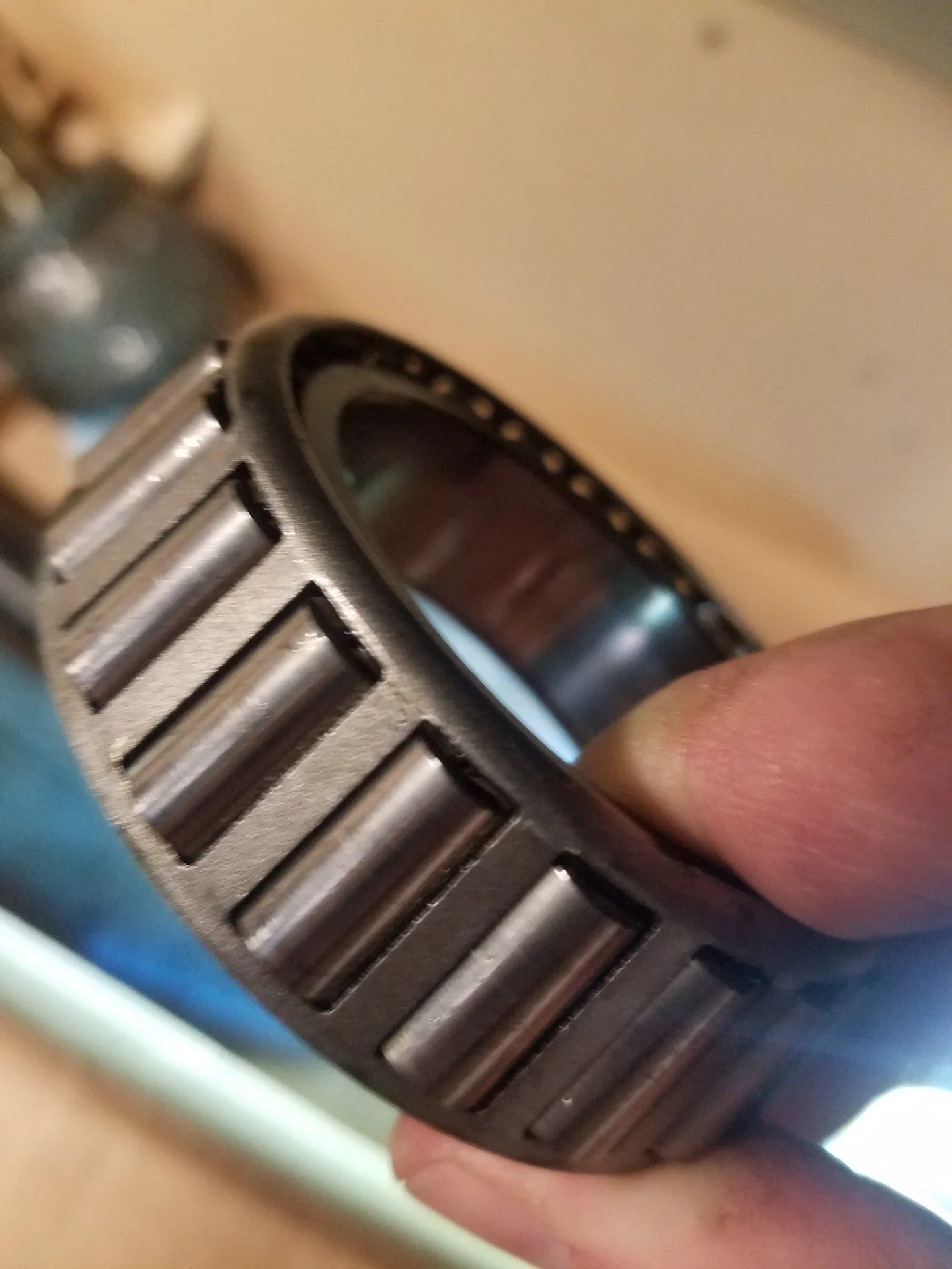

So now my question: the Timken wheel bearing looks fine--no obvious damage or flat spots on the rollers. Everything was well lubricated, just with gear oil instead of grease. Is there an easy way to inspect the wheel bearings (in hand) to see if I should replace them? The birf was not clicking and seems fine.

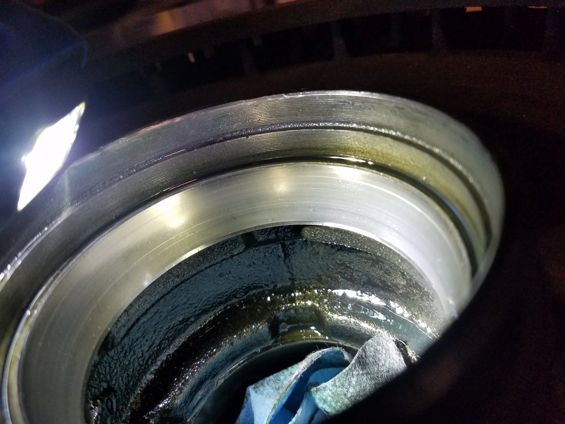

Passenger side had the correct OEM inner axle seal and looked perfect--zero diff fluid in the grease and plenty of grease in the bearings (though it was moly grease instead of wheel bearing grease, not sure if that matters).
