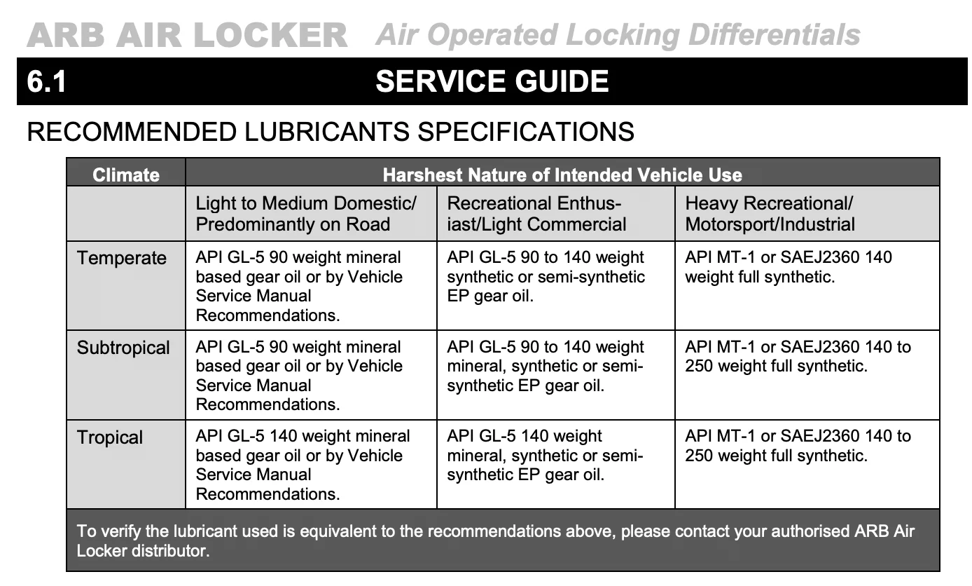

The 80 I recently picked up has ARB lockers front and rear, and I want to baseline all fluids.
According to the ARB manual, based on my climate and usage, I should run API MT-1 or SAEJ2360 140 weight full synthetic.
I've searched 'mud for hours and read a lot. It sounds like I should be getting gear oil without limited slip additive. This makes the right oil very hard to locate.
Does anyone have a recommendation for a brand (and source) for gear oil that meets API MT-1 or SAEJ2360 and is 140 weight, full synthetic, without limited slip additive?
Thanks for anything you can share.

What your gear manufacturer recommends is far more important than what the carrier manufacturer recommends fyi. ARB's will function in dish soap, but the gears wont last very long.
I use Mobil Delvac 1 75-90 in all of my vehicles that call for 75-90. Great stuff and you can get gallons from summit racing.
I have never heard of 140 being a requirement in an 80. I lived in a climate that saw 120f+ temps every year and have only run 75-90.
Maybe this is from the wrong manual?
I consider my location temperate (northeast USA) and my intended use is heavy recreational.
Thank you. Looks like it is also readily available, which is a huge plus.
That is about as general as you can get lol. Never even seen that table before.
Arb's are very simple inside and the only friction surfaces are the spider gears that move extremely slowly when turning (and not at all when locked). The ring and pinion manufacturer's requirement is exponentially more important, as the pinion is spinning several thousand RPM's at highway speed and applies tons of force on the ring gear.
As far as gear oil weight, 140 is too much if you see temps below 40f. For example - in my Cummins, it is recommend to use 140 if you tow heavy consistently and the temps never go below 40f. But that is in a truck that can tow 15k lbs while weighing 9k lbs and has 4x the torque of an 80. I still run 75-90 in mine since I don't tow that heavy and I don't want to have to change gear oil twice a year.
85W140 in mine, seems happy.
