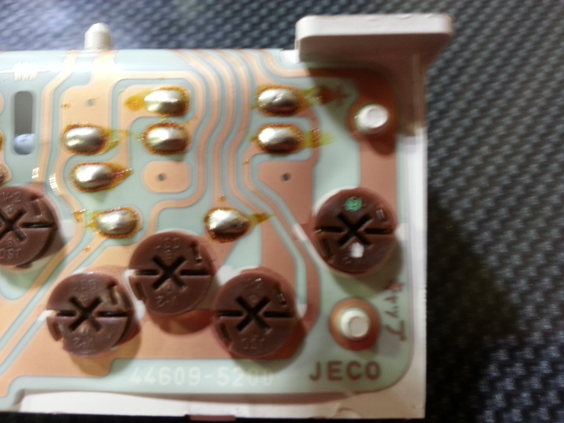

I chased this exact problem for about a year, including a 200 dollar neutral safety switch that was not bad after all.
It ended up being a break in a ground path in the dash position indicator lamp.

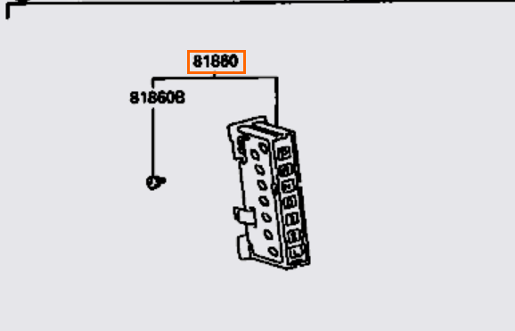

Screenshot 2021-12-04 at 14-11-53 83-02 INDICATOR diagram, 1993 TOYOTA LAND CRUISER.png
I think I will look into that Dan before I buy a new NSS. I did have the dash apart once before about 2-3 years ago the change the D bulb. No fun. Thanks for your help.
Examine the printed circuit carefully for cracks in the copper. I bet you find one. Sorry this is out of focus. It's the only photo I have of it.
