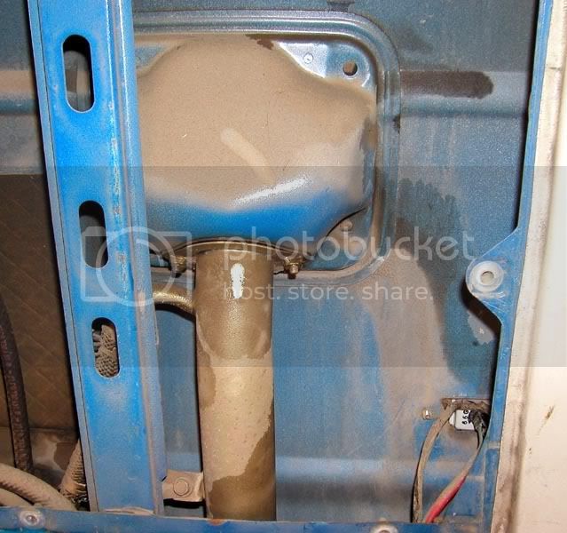

    I'm not exactly sure what is going on on top though. When I took the panel off, there was a strong gas smell. It looks like gas had leaked in there.
    [​IMG]
    The gas cap usually seals completely but perhaps because of the bent lip it didn't? When I was on the outside I also noticed a little stain down the side. I didn't top it off but maybe it was too full and splashed past the fuel cap and then drained into the inside of the quarter panel? I cleaned out the inside and hopefully the smell goes away. I'm not sure where the smell is still coming from.
    [​IMG]
    [​IMG]
    Thanks for all the input. If anyone has any thoughts, let me know.
    :beer: Chad

    Holy crap! My truck is (was) the same color but faded, and mine leaks at the same spot, and has a bent lip just like that. I suspect that's what it is on mine. It also looks like there is a gasket there as well that is maybe there to hold out of the quarter panel. My rear panels got soaked in gas regularily for a little while and they'd smell like gas for a day or so, but the leaking fumes would regularily get vacuumed into the cab. I built new panels out of fiberboard and bedlined both sides of it, and screwed it down tight with sheet metal screws and it got rid of the smell atleast. Also cut out the exhaust fumes from my broken exhaust :rolleyes: . I'm going to try a new filler neck and new hoses w/ fresh clamps.

    I ordered a gas fill hose, a gas fill neck gasket, and a gas cap from CDan. I'll try and bend the lip back once I have everything apart. Hopefully that fixes the problem.

    Just as a follow up, I had to loosen the fill neck tube to get the hose off and on. This meant removing the two screws at the gas fill cap area and then there is one bolt that you get at through the inner quarter panel. I also replaced the gasket there at the top as well. Looks like the new gasket will keep any spilled gas from getting in to the interior.
    I couldn't bend the lip back on the fill neck tube but the new gas cap fits very snug. I didn't think there was anything wrong with the old cap but the new one always seals well even with the bent lip. I haven't had any gas leaks since the fix. I guess I could replace the fill neck tube one day, but at ~$150 I think I'll spend my money elsewhere for the time being.
