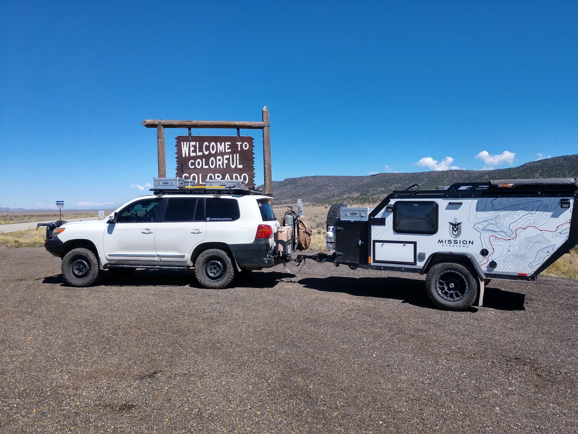

I have a 2013 LC with bumpers ,40 gallon LRA, 33" tires and 4.88 gears. I tow a 3K trailer. I'm getting 8.5 mpg on the highway at highway speeds and it can drop to 7.0 with hills and winds.
What are you other trailer towers getting for mileage? I know I am heavy but am interested in any comparisons. Thanks

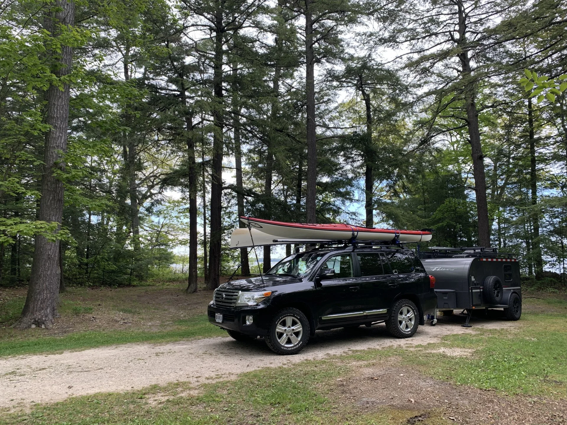

I get a very consistent 12mpg in the mountains and 14mpg on the flats pulling my trailer. Usually have canoes/kayaks on the roof as well. Mostly stock other than tires and 24 gallon long range fuel tank. I drive 65mph max. I pull this setup all over North America / 20k miles a year.

I haven't done extensive towing with the 200 yet, but just some comments:
  • 4.88 gears and 33's probably not helping MPG any. You've got to be running significantly higher RPM than stock at a given speed. I bet it feels strong and tows great though.
  • Boxes on the roof have got to be hell for your aero. I've noticed a huge difference in wind resistance between different shape campers or hanging crap off the truck, even when the weight is similar (i.e. pop-up vs. boxy teardrop like yours). You really notice this stuff driving an 80-series into a headwind in Wyoming. Maybe build a wind fairing or find a way to get that crap inside or into a rocket box?
  • What's your typical cruising speed? Bringing it down to sub-70 will definitely help. I know this, yet I still can't bring myself to go any slower than the rig is capable of :hillbilly:
I know I have a lot of wind resistance. Without the trailer ,I've seen 12-13 mpg. Speed is an issue and I factor that in. 65mph is very slow to a speed limit of 80mph.
It always seem when I go on a trip it is terribly windy.
According to reading posts on MUD it seemed 4.88's with 33 tires would be optimal for off road performance and pulling a trailer. With stock gears the truck is a dog off road.
I understand poor gas mileage is part of the fun. Just trying to gauge what others are getting similarly equipped.
I get a very consistent 12mpg in the mountains and 14mpg on the flats pulling my trailer. Usually have canoes/kayaks on the roof as well. Mostly stock other than tires and 24 gallon long range fuel tank. I drive 65mph max. I pull this setup all over North America / 20k miles a year.View attachment 3030256
Looks like a stock truck.

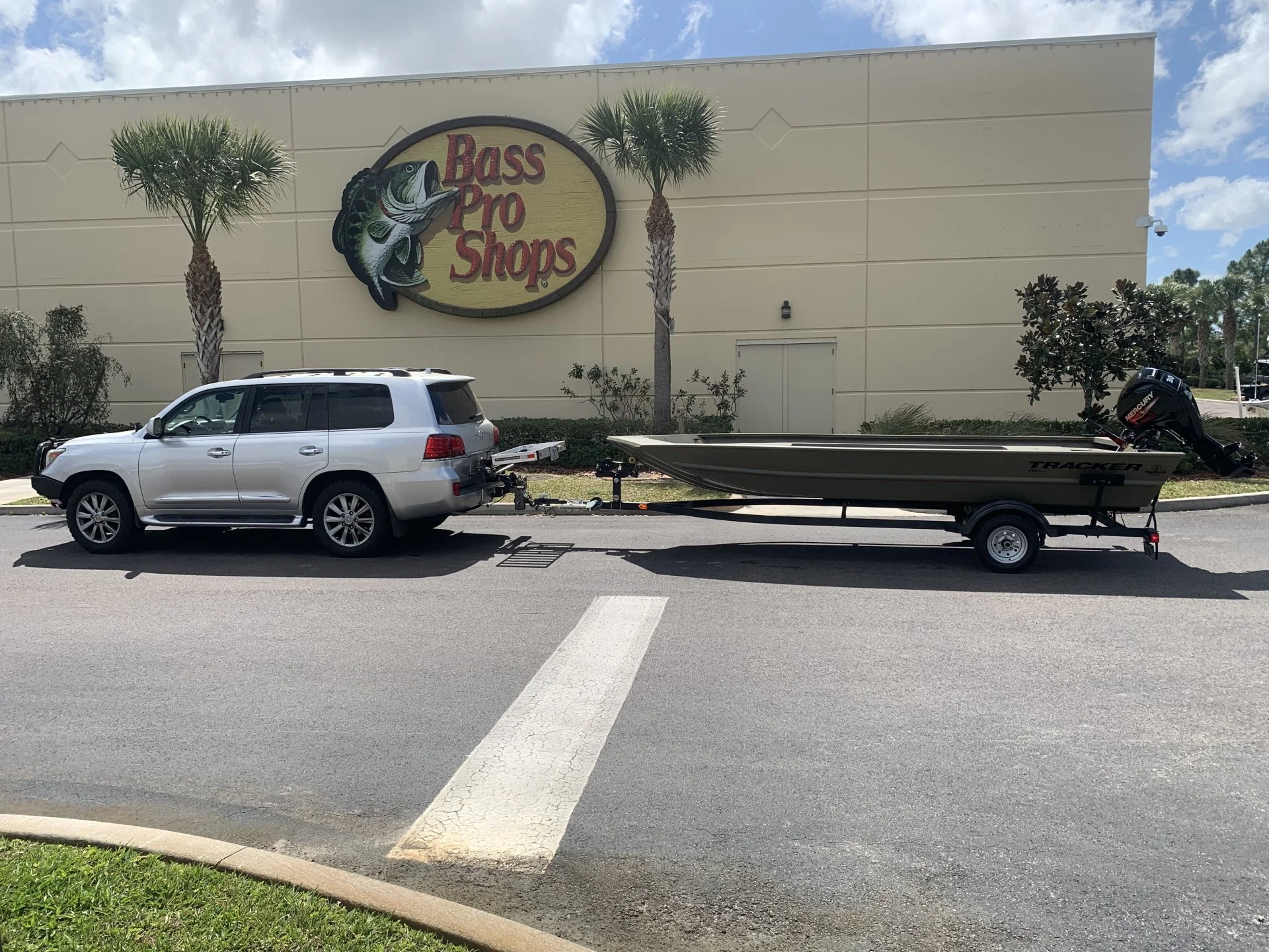

I average around 12 in town and 17-19 or so going 55-60 mph on flats…ive got 33’s and a bullbar in stock gears. 13-16 mpg towing a 17’ Jon boat.
Aero is a killer…and aerodynamics aren’t linear. The faster you go the even harder it is to push the air out of the way.

That photo tells the story. Your lucky to get the 8.5mpg! Front bumper, heavy tires, square boxes on top, non-aero trailer, loaded everywhere stuff can be put; wow. The coefficient of drag would be off the charts. Ever weighed the setup on a CAT scale?
No need to weigh anything. If I could get away with less I would.

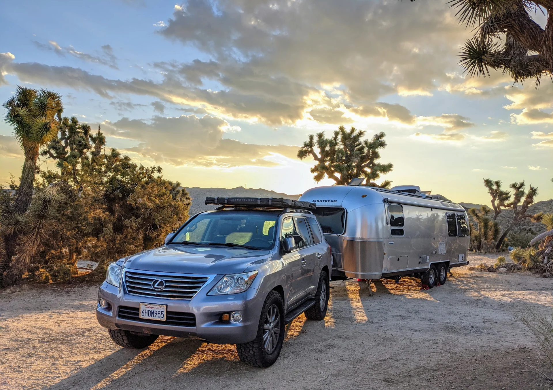

It's a slippery slope and a balance. With everyone probably comfortable with a different balance. I think @highfructose hit all the major points and I'm in agreement. Aero (and speed) is singularly the biggest variable.
As much as I'm tempted to build a cool looking rig, the need to tow my large 8k trailer keeps me grounded. To a degree. And when towing potentially saps half the range, it becomes a more major consideration. I've kept away from adding weight and external accessories as each one just saps that much more efficiency. Doesn't mean I've given up on them completely, just went about it differently. Like installing the longer factory LC rack with multiple cross bars on my LX. Keeping front bumper with small cutout for winch. Super low profile and lightweight RTT. Re-geared to 4.3s to get that back-to-factory gearing with 35s to maintain good wheel torque while reducing windage losses with extra RPM. And adding incrementally weight where it makes the most difference, like 35s, and an aux tank.
To answer the OPs question, I'm at 15,200lbs combined rig weight with the 28' 8k lb trailer. I typically get 9-10MPG. I can eek out 10.5 and almost 11 MPG if driving more conservative at 58-63 MPH and get behind a big rig. I usually cruise closer to 65-75MPH, getting closer to 9 MPG at those speeds. If I'm going faster or there's winds or grades, I've seen 7-8 MPG. So it's elastic based on whether I'm trying to be efficient or make time. On long haul days, speed may not help as it can drop range significantly and require more gas stops. The cost of driving faster can also really add up - $80+ more on a single day 350+ mile day.
