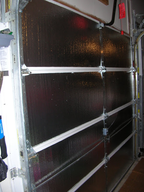

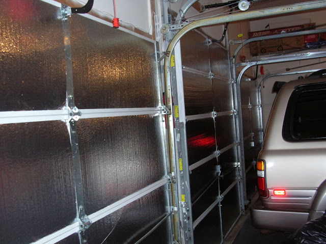

I had been looking to do the same for a couple of months but did not like any of the off shelf products. They either looked ugly or felt not long-lasting. Anyway, finally did it last weekend with my own way - basically 1/2" Dow Insulation Pad, covered by 1" styrofoam pad. I went Dow pad because it gives me relatively "good" R value. Unfortunately it is kind of brittle, and I won't be able to bent it slightly in order to tug into the garage door "frame". So I went with the 1" styrofoam pad as the cover layer. Both can be bought from local Lowes or HD and about $12 per 4x8 sheet, and 2 sheets of each kind per door. So the cost of insulating one 8x8 door is around $50 and 2 hour labor. The end result:
  • The R value is not as good as the off-shelf product. But good enough for garage door purpose in NJ (at least for my standard)
  • Excellent noise reduction, even the door open/close is so much quieter
  • A lot better lighting - a side effect due to the foil cover.
I would not say it is easy to install. I took some struggle to tug the pieces in especially you want them tight and nice looking. But once done, I am very happy with them. :clap:
Here are some pictures:
- Before insulation
- Materials:
- Finished:
