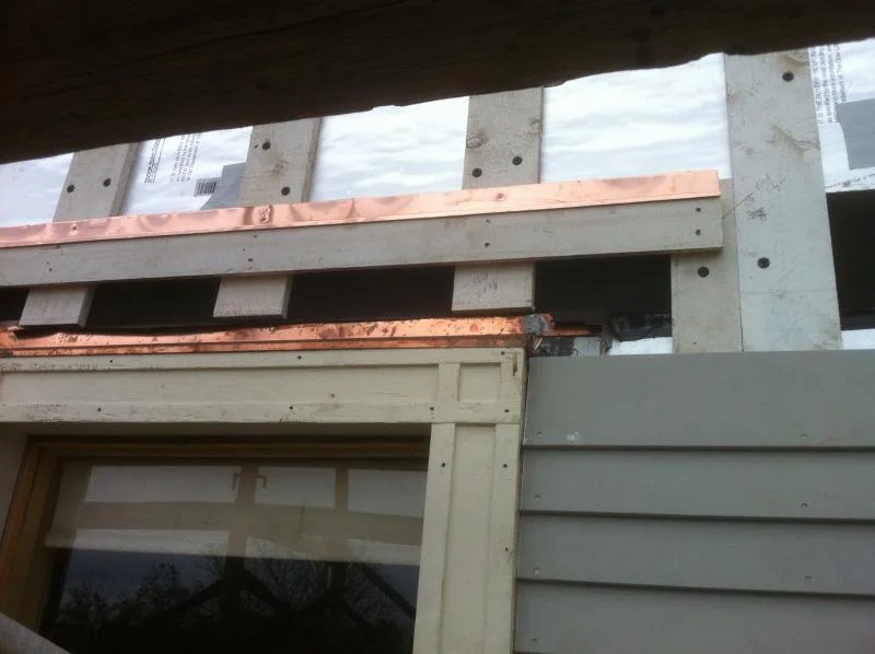

Its a bit more to do it this way but its relatively easy. Attached here is a pic of what I mean - back ventilated wood cladding over polyiso that is used as the air control and water control layer - all joints taped and sealed. This place will never need to be repainted in 100 years.

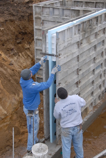

The last house I worked on with Habitat (dedication this weekend), we used Thermomass walls for the foundation, which is a sandwich of concrete/foam/concrete. Very easy to setup the forms (we had a contractor do all this). I would probably use this system if I were building new. Make sure you also put foam UNDER the basement slab. Photo of the crew putting up the forms:

This is called a "vented rain screen". We typically do this by putting strapping over the foam, with long (3") screws into the studs. Then you nail the siding to the strapping. You do need to make sure you put some sort of bug & critter screen at the bottom so they can't get up into the vented cavity. Very effective system, especially if you are using cedar or Hardie-Board siding.

In the Thermomass system, the concrete is there as a structural support and a durable outer layer. But concrete does have R-value, although very little.
