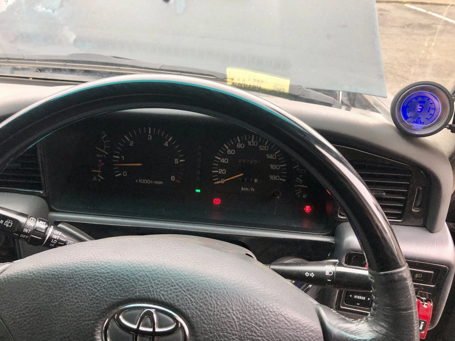

I've searched countless threads on abnormal oil press at idle, and only find ones about LOW pressure. My issue is higher pressure at idle (+10 psi over)
I recently refreshed the plenum and some other parts. Prior to replacing anything my idle was at 16-19 psi at idle (700~ rpm) depending on weather, which as far as i know thats healthy. It had a bunch of rotten vaccum lines and a grimey TB so i decided to change everything with new OEM stuff.
Now i'm getting 30 psi at 600 rpm, and 60-70 psi at 3000 rpm. Does anyone know why the idle psi is so high? The on throttle pressure is about the same as before i refreshed everything, but the 30 Psi at warm idle is concerning me that theres some compression blow by or something, however i didn't change anything related to any oiling. I'm reading the pressure with a prosport EVO2 oil pressure gauge, with the matching sending unit /harness which came with the gauge.
Am i over thinking this? Did the leaky vaccum lines, bad spark plug gaskets and old pcv valve really cause such a leak in oil pressure? As far as i know 30 psi is not normal for a later model 1fz-fe.
1995 JDM VX 1fz-fe
237000 KM (150k mi)
no engine mods besides oil press gauge and vaccum gauge

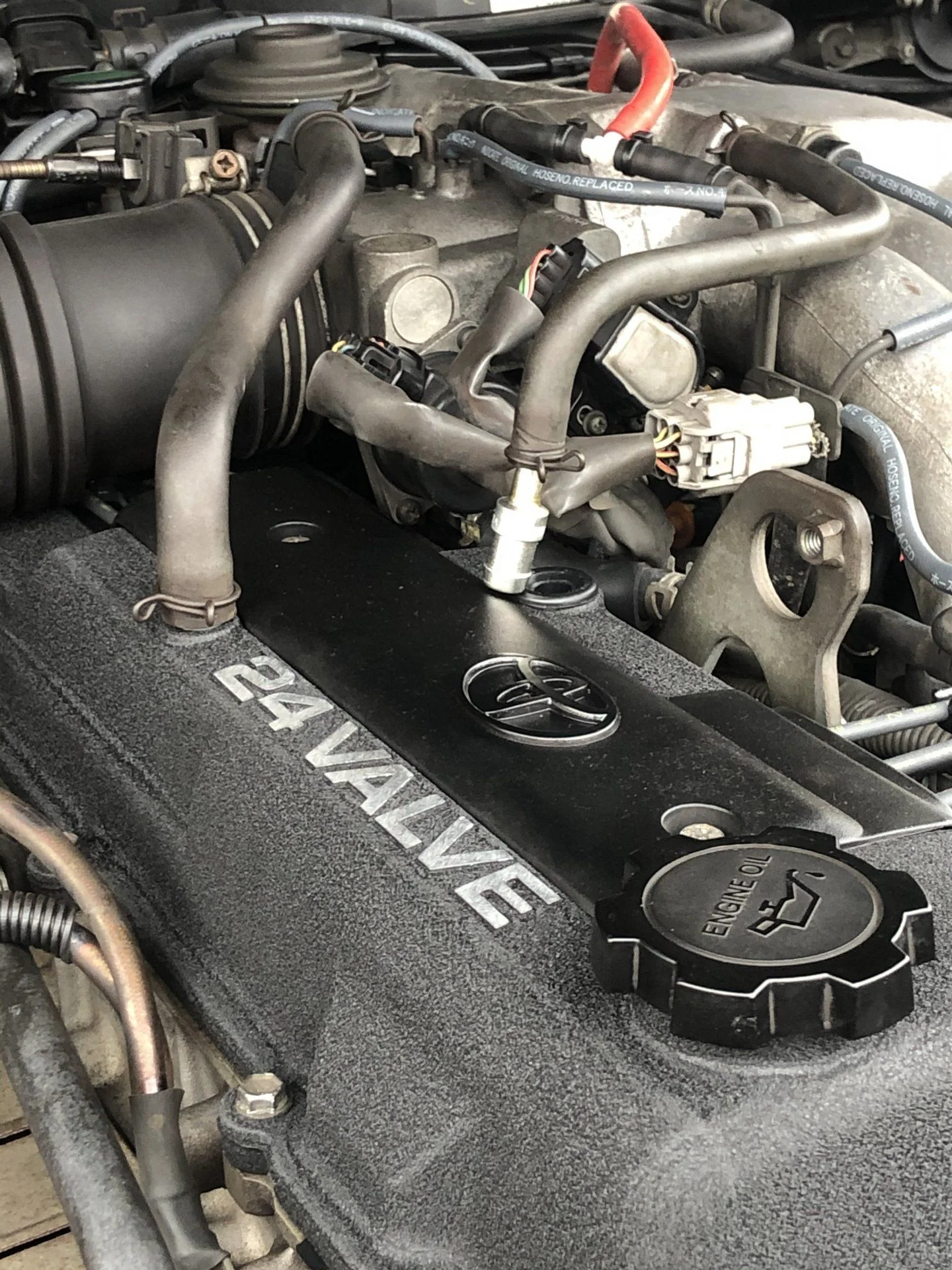

Things i replaced:
(All OEM Toyota parts)
every vaccum line
fuel vsv / egr vsv
Intake plenum top two gaskets
TB gasket and cleaned TB
EGR Gasket and cleaned EGR pathways in plenum
Spark plug gaskets (mine were rotted)
Valve cover gasket
new PCV valve and grommet
Distrubutor O ring
coolant bypass hose #1 / #2
new spark plug wires
