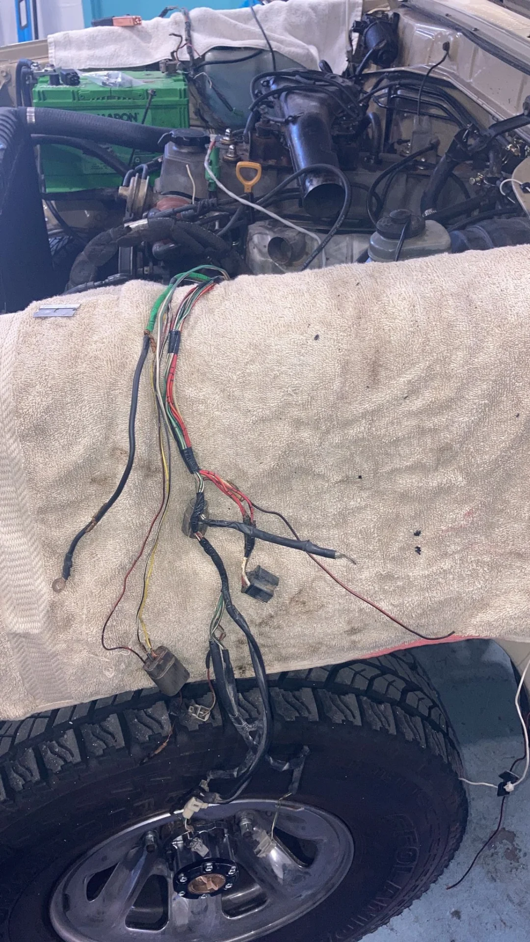

The good folks at Red Line Land Cruisers have taken my zombie 73 on and in speaking with @RLMS today, Justin said my harness is basically toast (@OGBeno thanks for sending Justin that diagram). He recommended replacing it over working through it as it’s rather fragile and victim to one ham-fisted fix on top of another.

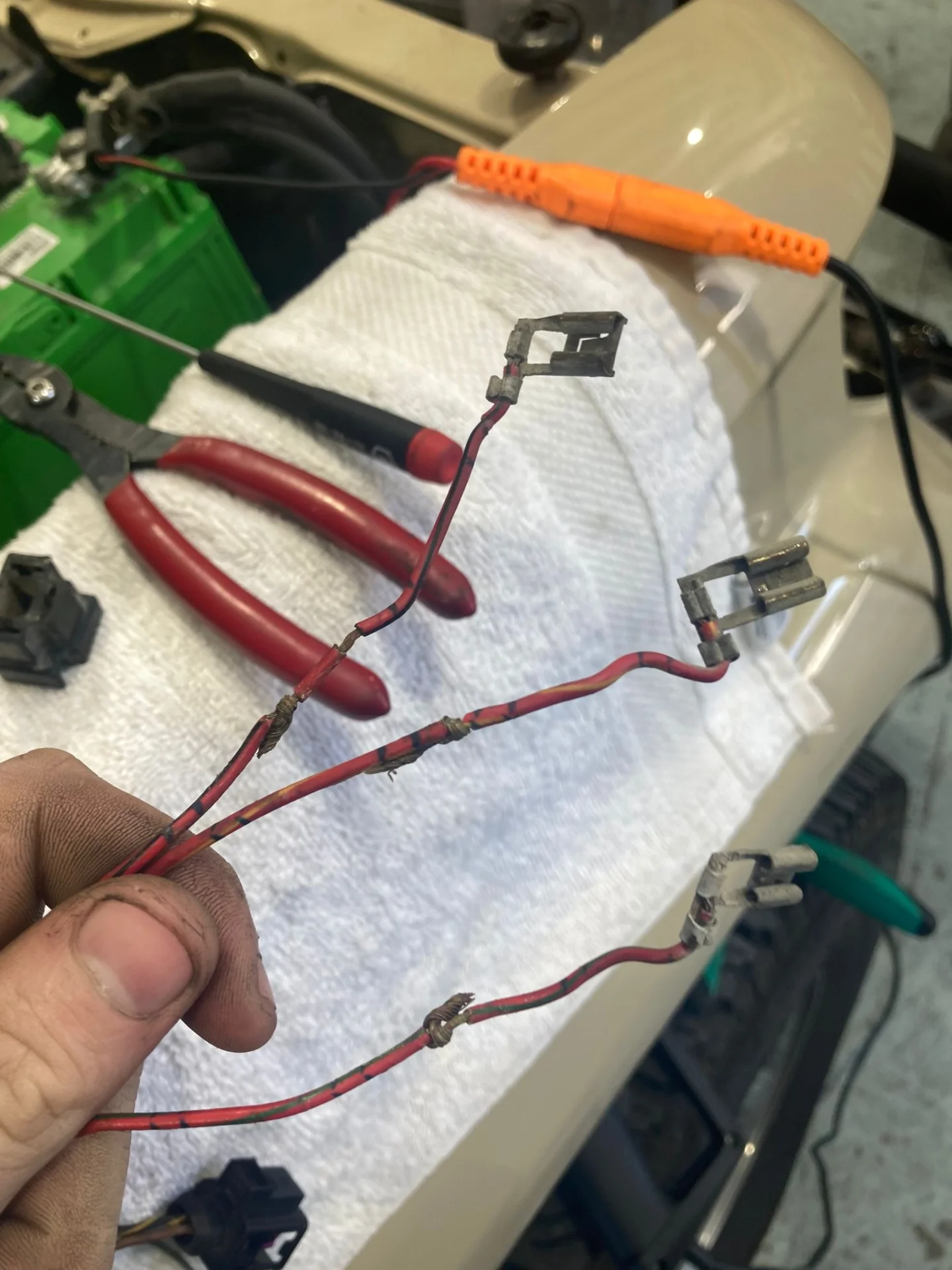

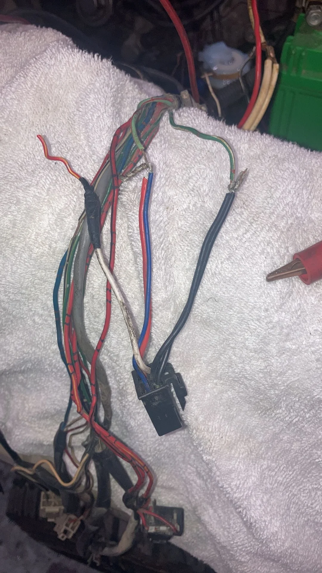

Ugh, I feel for you. I'm currently dealing with the same thing on @John Young RJ77. Every single connector cut and poorly spliced. I will probably have +20 hours in wiring repair when I'm done, wish I could just get a Toyota replacement.

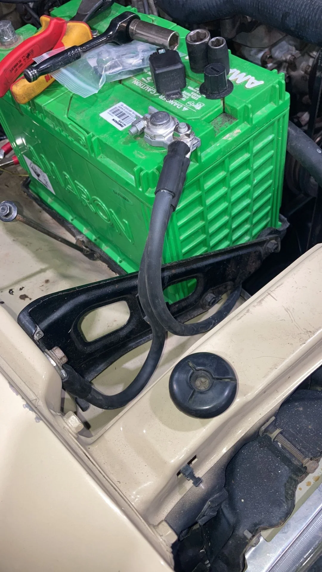

This is the truck that my son and I drove from VA to the Land Cruiser Heritage Museum in Salt Lake two years ago and back to Florida this year. It is no longer a surprise to me that the ignition coil melted like lava on a trail in Moab. Matt has been sharing photos as he goes along and ... well ... it is pretty amazing that we had as few problems as we did.
These issues are everywhere on this Middle East veteran.
And I'm just grateful to Matt for going through the vehicle the way he is finding and correcting. Here is an 'after' photo from what Matt is doing for us:

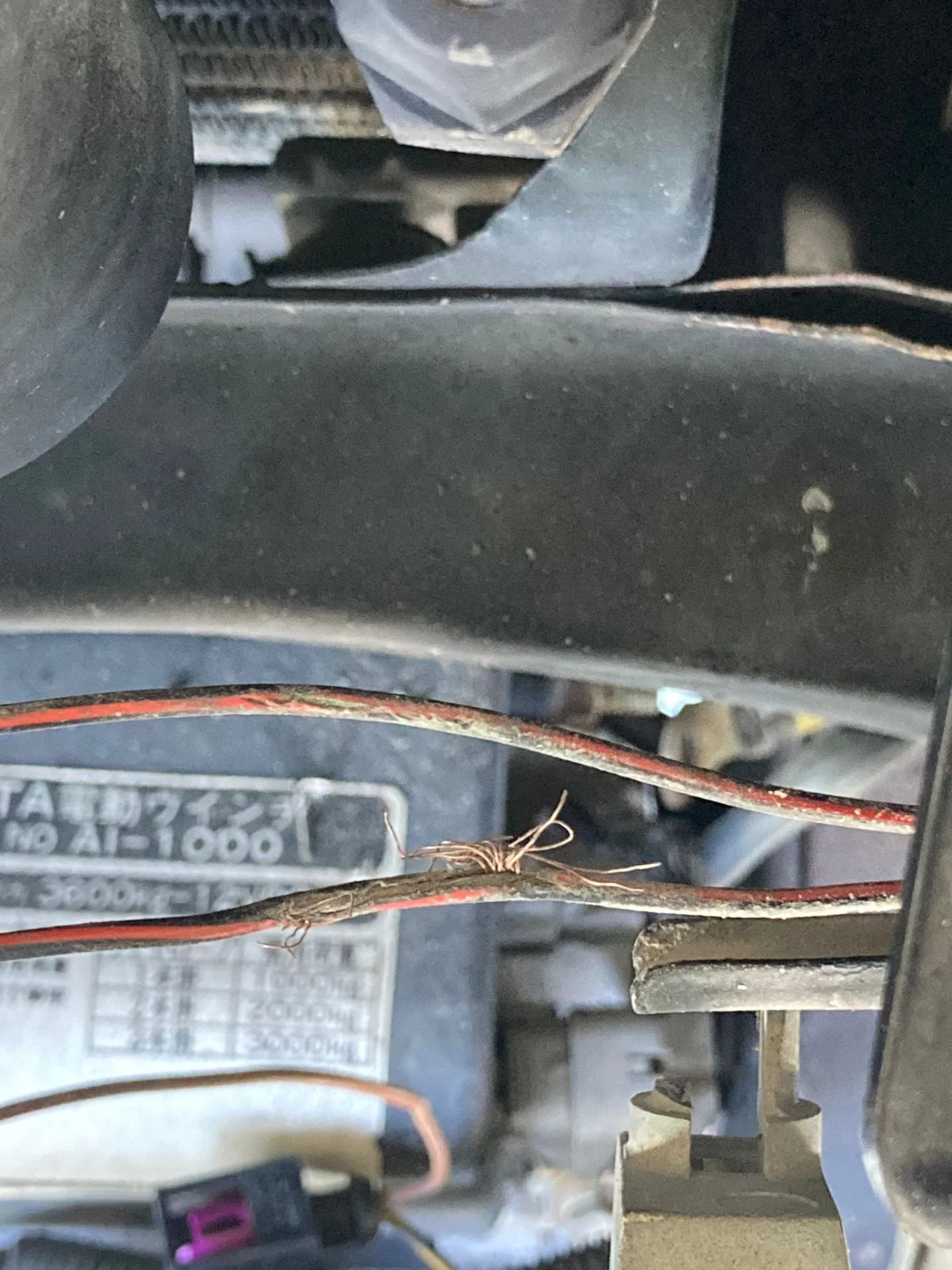

The desert is hard on connectors and wiring, and with such an old truck it is not too surprising. I've modified how I look at a potential purchase--I'm now quite keen to look closely at the wiring before making a purchase out here.
P.S. Did I mention that sometime in the life of this old truck someone had installed a Mitsubishi alternator, complete with mounting hardware, on our old truck? This is not atypical. Usually customers here in the Middle East just say 'fix it' and the shops just 'fix' it to get it moving down the road.

In your defense John, 95% of the issues were wrapped up good and very purposely concealed. Most would have thought it was mostly original wiring besides the few obvious issues, myself included at first glance.

This looks exactly the way I found my wire floor harness
