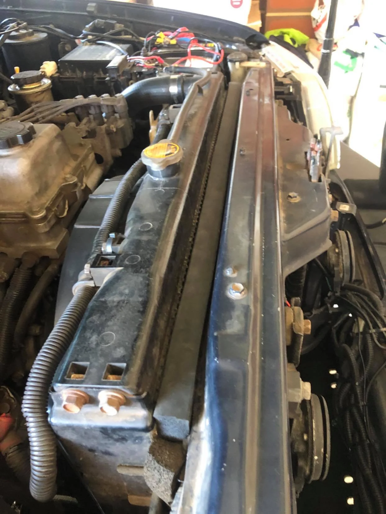

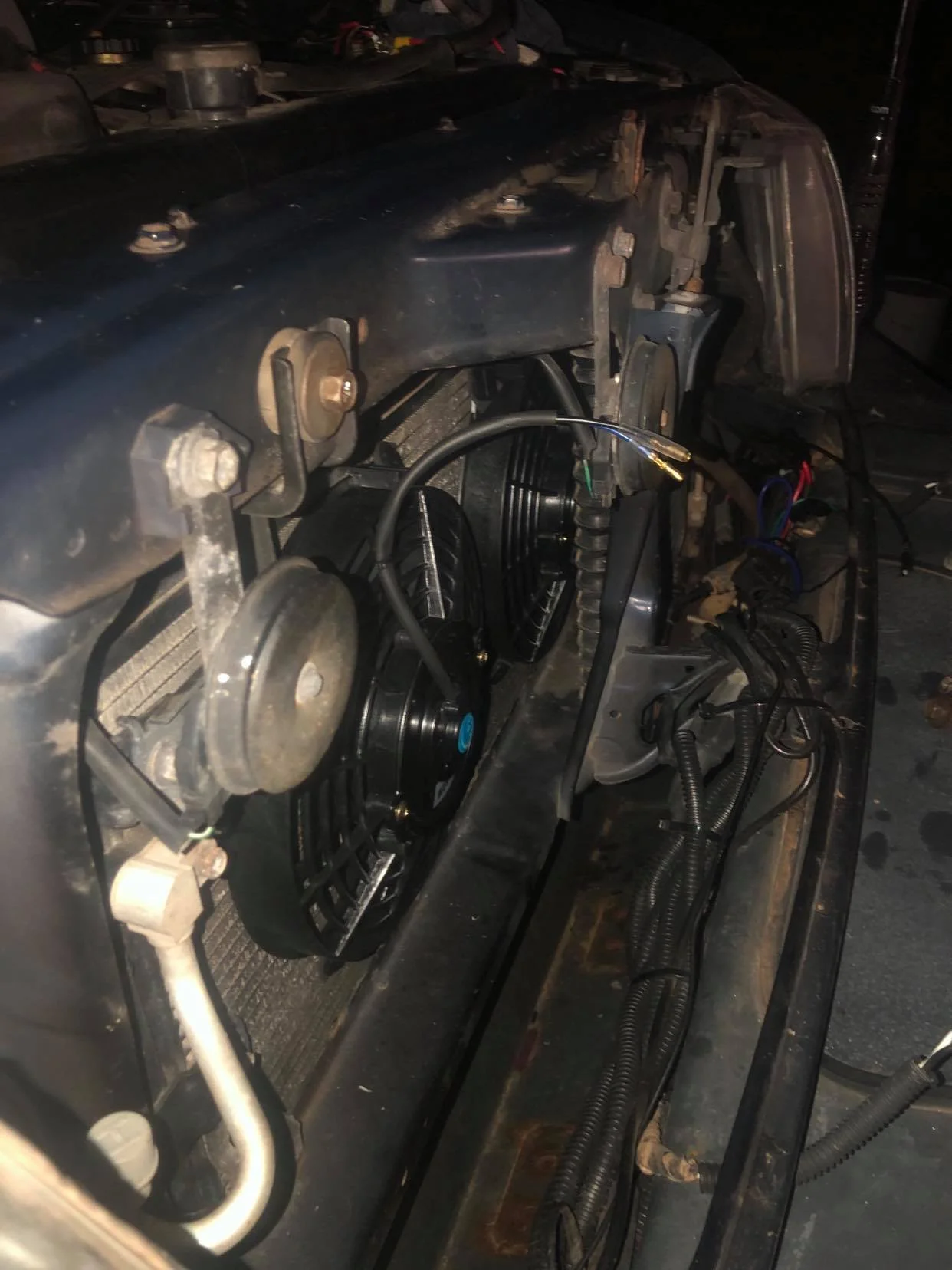

So I've gone to the extent of putting 2x thermo fans on the condenser and extending the A/T cooler forward.
I have replaced the broken Fan shroud and clutch driven fan (TORA) & put some rubber foam seal between radiator and front chassis. So more air is going over the fins obviously.
It gets cool real quick because of this, but there is still a problem in this system after the cars been run a bit suring the day then it cycles from cold to warm, back to cold. Obviously some sort of restriction in the AC system. On top of that, the AC Compressor does not stop, or switch off and then on again... making me think that is an obvious problem.
I have a squeek on my engine clutch driven fan now and it looks as if the fan clutch may be wobbling only very slightly. My theory is the 2 x thermo fans in push config is somehow blowing warm air back into the engine bay against the new TORA clutch driven fan and viscous clutch <-- weird but kinda evident something is squeeking a bit in there.
So now I've completely researched the entire AC system (DENSO) bought a temp gun and think I will just replace the condenser and TX Valve. The condenser looks easy, the Tx Valve can be done from the front of the firewall by the looks? Think I will leave the thermo fans off, or put them in PULL config, but I will be buying a vacuum pump to remove refridgerant first, so wont touch the condenser after first replacing I can buy more refridgerant later.

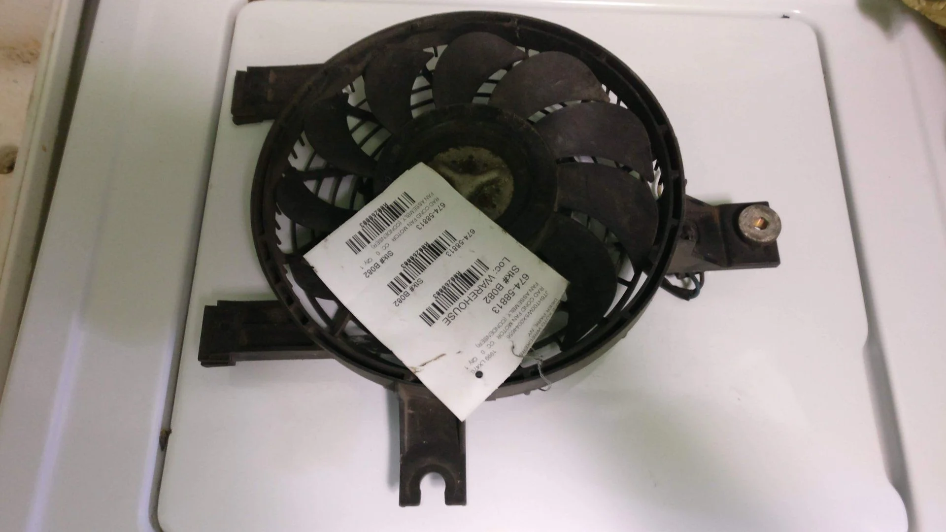

I've taken pictures of my cars A/C Pressure switch sensor and it has only 2 wires going in. However, as you can see in the pic, there is an unplugged connector above it which has 2 wires:
Would this unplugged connector be for the A/C Condenser fan ? I have this strange feeling maybe there was one if that is the case.
Anyone good at looking at Toyota Service Manuals that can tell me what that wire is for? (would help me determine if its for condenser fan)

Don't bother with the thermo fans, it did nothing for my AC.
