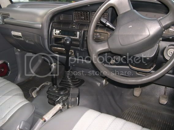

No transmission other than 4spd w OD automatic was offered in the US. Conversion can be done for around $4k US.
1990 N.A. 3F with manual came out in Oz so a swap is easy.:beer:
