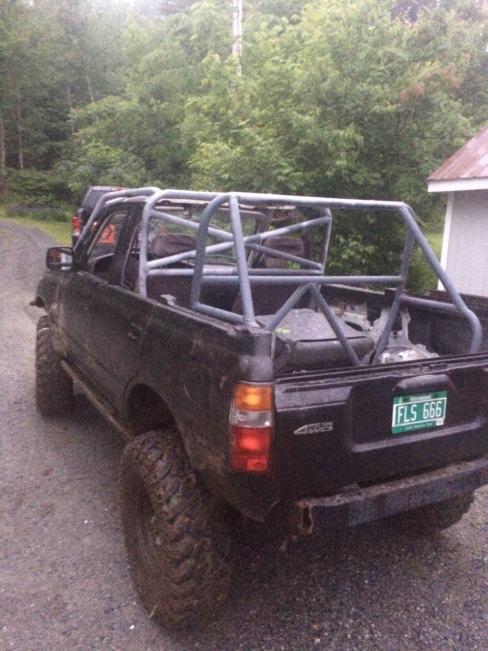

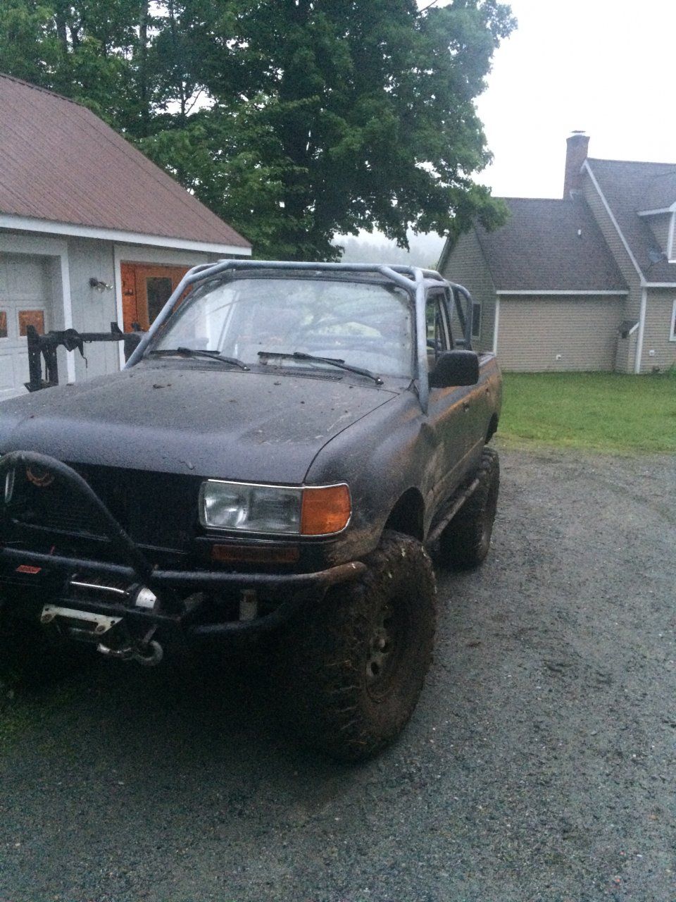

trailered the pile and steel tubing down to buddy's garage in Grantham NH last weekend. Removed all carpet, AND.... got the B pillar tacked in!!!! 1.75x.120 DOM. Should get a lot more done this weekend!
we checked clearances in the cab, and decided to run "A-pillar" section exo, to keep room in the front cab. tube will be exposed down around doors, then tuck in under front fender... basically stealing the idea from VCCruzr's awesome truck (see picture).... that's the current plan anyway...

Man that's looking sweet.
Gonna make a soft top for it?
