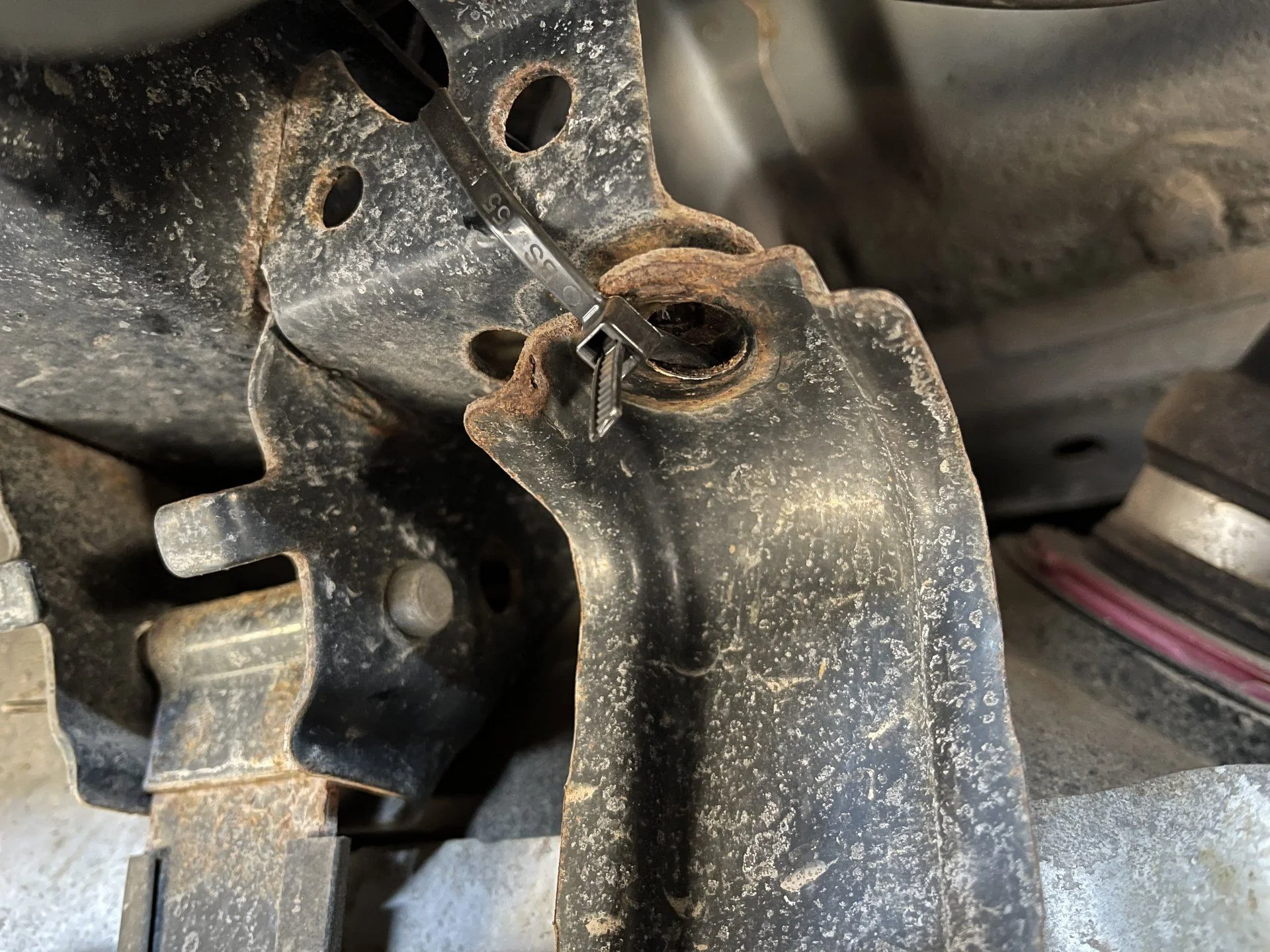

So .. I have fuel pump recall and seat belt recall done , amazing quality job 👎🏻‼️
WTAF? What is zip tied together? Do they remove the door jamb for the seatbelt fix?

Hold on guys ... nothing against LC /LX , just those damn grease monkey working at dealerships, I’m doing all nacessery works on my vehicles by my self , I do not care about seat belts recall , just by watching YouTube videos of fuel pump job , I was thinking why not let some “professional “ do the work .little worry about actually how new fuel pump went in ❓coat hanger will be my choice 😎
Not a joke , they offer to repleace door things, step ? , guess what, I have to massage everything around so it fit perfect, I’m telling you guys , the time of decent mechanics are over ‼️And fuel tank skid plate ? I will adress it by my self , or I let my granddaughter do it ,

The zip tie is hilarious.

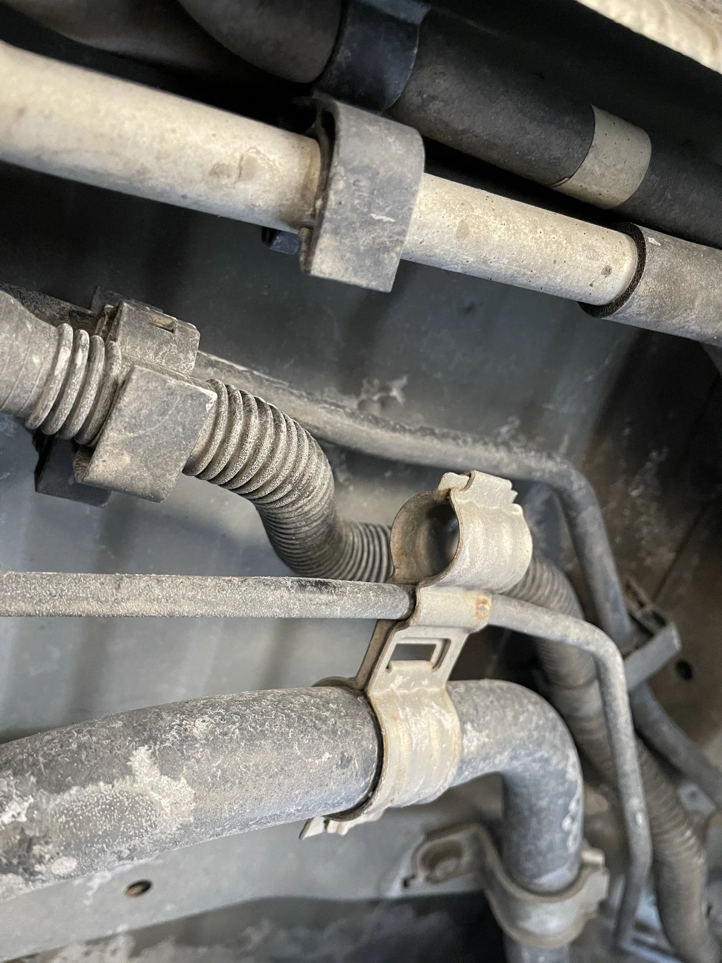

The evap hose has never gone through the fuel filler clip in the second picture. That isn't a reassembly mistake.
The zip tie was supposed to hold in the seat belt anchor wasn’t it. Must have had the instructions upside down....
Zip tie appears to be holding the fuel tank heat shield up.
