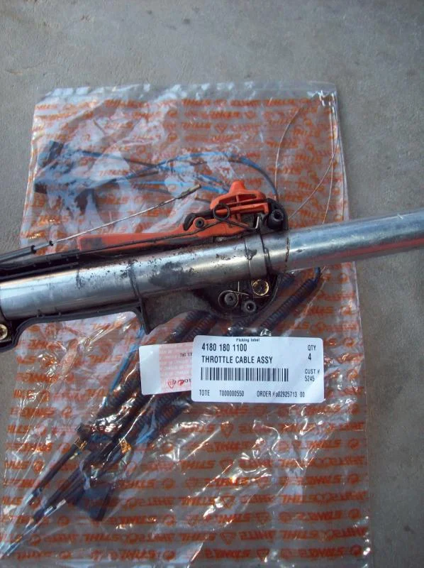

Dan, you wouldn't happen to have the right part# memorized would you?

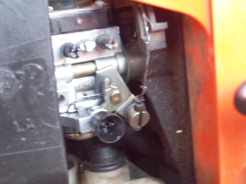

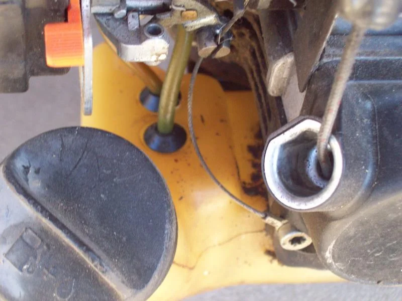

Here's pics of the other ends.
2nd style
The more I look at these, the more I think some of the parts were mismatched. I've got 2 units with FS 100 RX stickers on the tubes, but the power heads are completely different (can no longer read the model # on the starter housing).
The 4180 180 1100 should be the one for the FS 90, FS 100, FS 110 or FS 130.
What you have in the top two pictures is an FS 80 or FS 85 power head. 4137 180 1103 is the correct part number for the throttle cable that you have/need.
The bottom picture is an FS 90, FS 100, FS 110 or FS 130.
