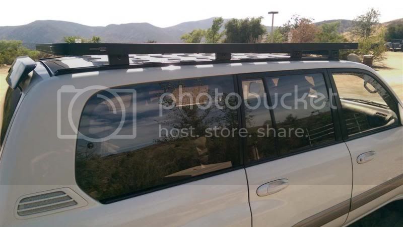

Just thought of this, but the rail that the feet attach to only goes so far. I had to attach the forward feet at the very end of the rail and my rack ends close to the front of the sunroof. A longer rack would have too much unsupported length up front. You may be able to put very light stuff up there, but nothing significant.

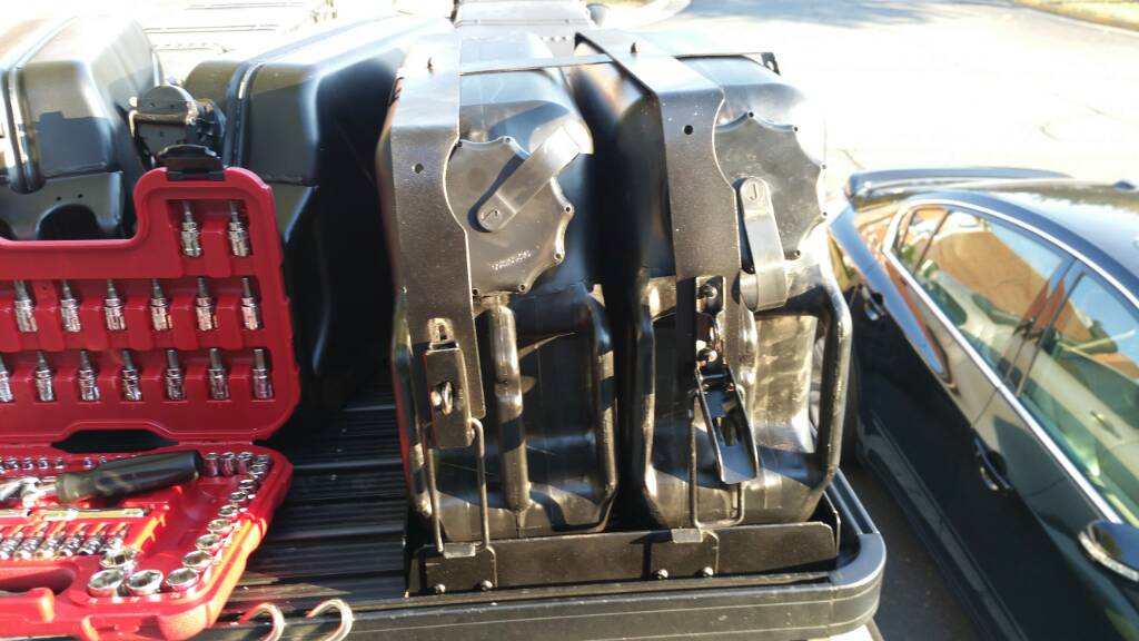

Bryan, you should post pics here. I am dealing with the same issue. I have the Frontrunner dual jerry can holder. From my measurements, all that should need to be done is bend up a new top bracket.
FYI - I called the number for the fuel can holder pictured above, they are Out of business and a new company took over.

We were working with someone looking for a solution but we never ended up with a finish product. We are in the works of sending a few cans to SA and having a mount made. I am not sure how long it will be until we see a finished product. The fitment I have seen most often on our Roof Racks are the Baja Mounts. Unfortunately, I know many people do not like the design because of the high profile it has.

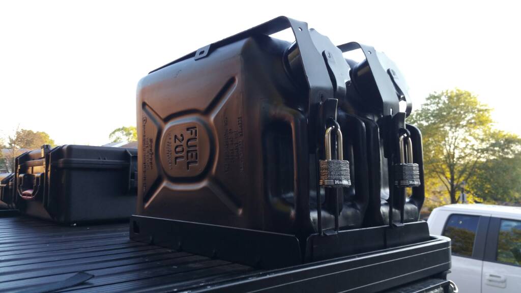

I use the Front Runner holder for Nato cans, and the BajaRack holder for water cans. It works ok. Arrangement in first picture is for longer trips when I carry two fuel and two water cans. Other arrangement is for shorter trips when I carry one of each in the BajaRack holder and don't use the Front Runner holder.

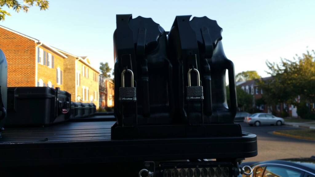

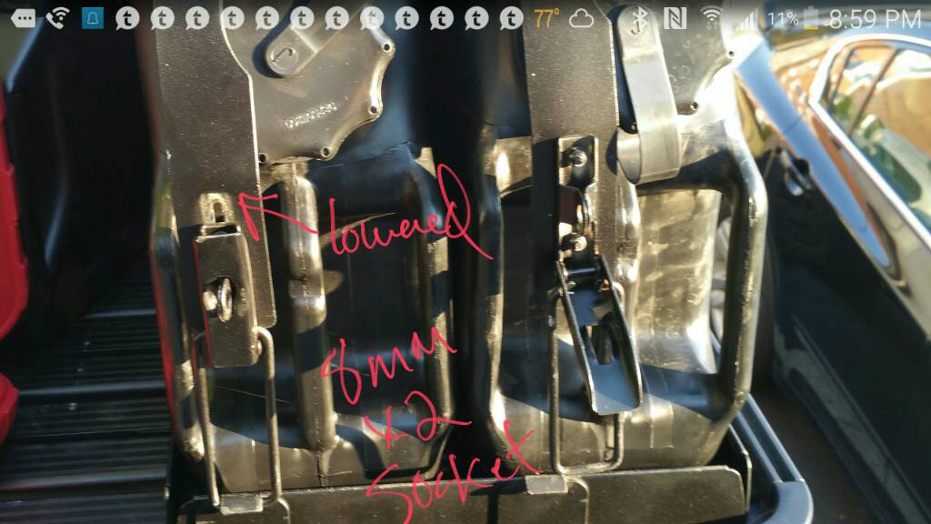

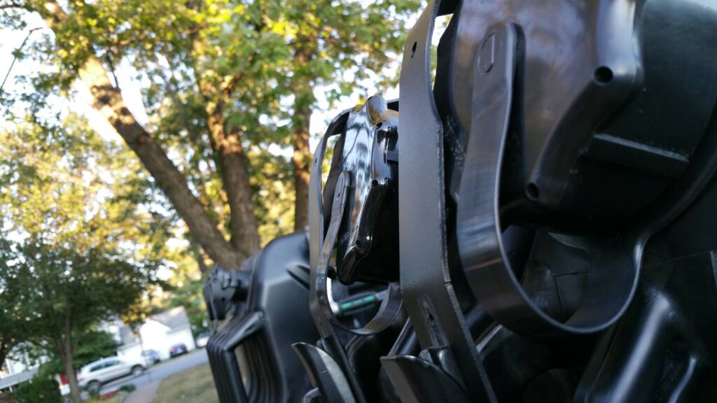

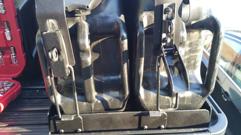

The plan is to flare the bottom a little of the holder. Also i want to add a 'C' shaped bar across the front that wraps around the sides a bit to protect the caps and side to side movement.
The same 'bar' across the top would work in front if there was a second one. Also, the bar across the top, if there were long eyes instead of a hole, I could adjust the bracket over a little on the drivers side of the holder to accommodate the cans being centered better. Will work on it later today while the wife is out.
