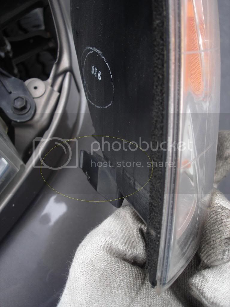

Man, I finally got it,
After about an hour of trying by pushing
on the tab, I said screw this. I never got enough leverage in that tight space.
So, I just pulled hard straight forward
and it poped out. I had to put on some heavy gloves so I could grab the sharp edge of the turn signal on the outer side. Wasn't hard I guess. I just never thought to use gloves previously, so could never pull hard enough. 1loud was right.
So the trick is, to use heavy gloves so you get a good grip on that sharp edge and to pull straight forward without fear.
Anyway, here are some pics of the TABs for for future reference.

Pictures look like my color, you have a 98-00?
If you pull straight forward with force you can break those tabs. Not that I know. :mad:
...you see! I was trying to save you from the possibility of that happening but hey, it worked for you anyway.
I agree, the safest way would be to push the tabs out from the inside. But for me, I just could not get enough leverage on the tabs in that tight space. And as 1loud pointed out, I have tender:princess: hands.
The tabs are not the positive locking types, like say on a wiring harness. It is just held in there by friction. IMO, it is safe to pull, as long as you take care to pull it forward straight out, without tilting forward or twisting in any way. So gotta pull out grabbing the outboard bottom edge as well, which is kinda sharp.
For me, a last ditch, resigned to break it, desperation, sudden jerk, did the trick. Popped out in one firm tug.
Anyway, knowing the position and direction of the tab, helped me figure out which way to pull.
