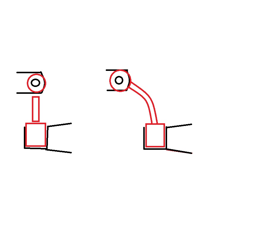

Does anyone with more engineering background than me have a good idea whether having a bent swaybar endlink would fundamentally change the effectiveness of the the bar, assuming you could make it strong and rigid enough not to break? I.e. if the force is not being exerted straight down on the LCA cradle, does it become less effective? I'm familiar with mounting the endlink outside the LCA cradle, but even that I think would not be enough offset to have a straight endlink for the distance you'd need to move the swaybar forward to clear the tie rod and swing it out of the way.
Also BTW, the LCA cradle is 1.5” deep. So to keep the links straight outside the cradle you’d have to shift the mounting point for the sway bar to the frame to be 1.5” forward.
I can’t answer your specific question but my gut says yes it will matter at least to some extent. As the downward force is now being pushed to the LCA at an angle rather than straight down.
For a number of reasons I think if you really wanted to do this you’d probably need to have a custom bar made or find one from another similar sized vehicle that might fit. Could something from a 100-series or Tundra fit?
Yes, the sway bar becomes less effective, essentially reducing its spring rate to a degree. With the end link at a more extreme angle, some of the travel will be taken up with additional flex in the end link, its bushings, and even the sway bar locating bushings and LCA bushings. Rather than translating majority of the LCA vertical motions to the sway bar as designed, there's horizontal forces created.
