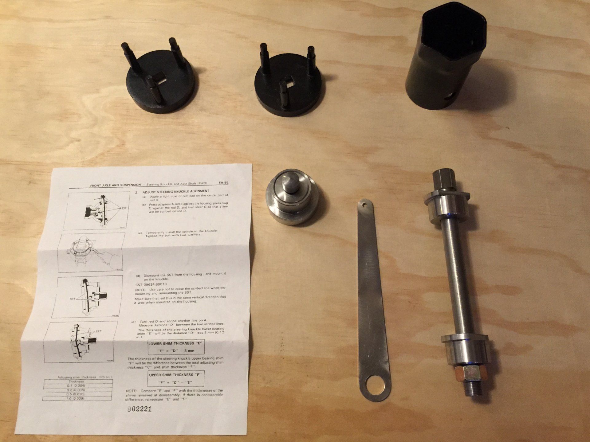

As @seapotato said the Toyota knuckle tool is crucial to centring the axle in that seal.
Also you could check for a plugged housing breather.
If you drive with your hubs locked a lot the brass spindle bushing can wear out allowing the birfield to flop around and prematurely wear out that seal

Your housing could have gotten slightly bent and that’s why the original stack of shims no longer lines the axle up in the seal. They usually get tweaked between the ball and spring.
By the way i have to check it was returned to me but I have a knuckle centring tool I lend out.

Wow that's super generous. I would love to borrow this when I tear back into it. Is the FSM what folks are using for instructions? I followed a youtube video but it obviously wasn't comprehensive.
I checked the breather and cleaned it out when I changed the seal, but no I didn't use an alignment tool. I did consider that the brass bushing could be worn. If I need to replace axle shafts and those brass spindles it almost starts to feel like I should just find a better axle somewhere.,
