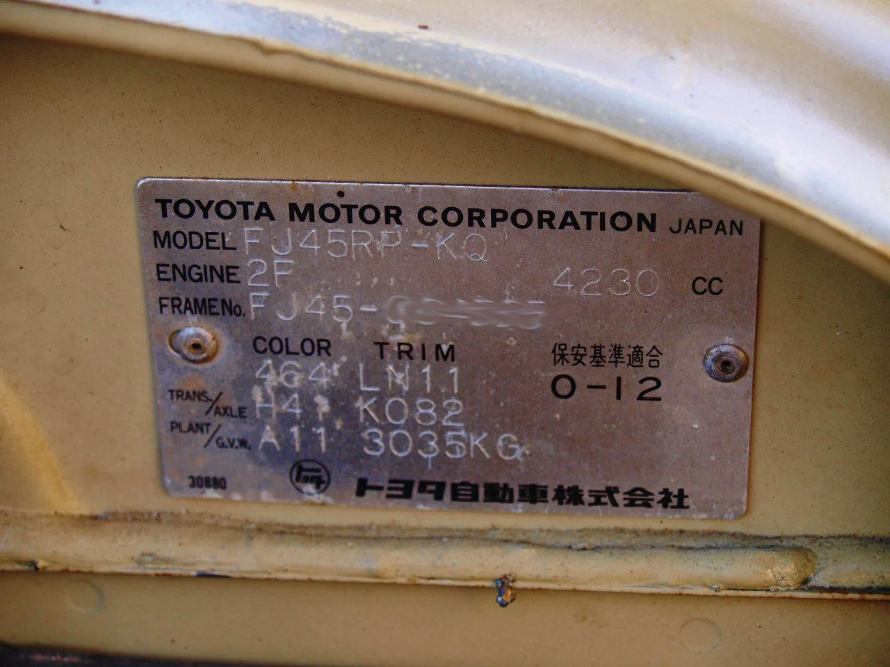

Been looking on the differentials for the ID code/stamp to tell me if they are 37.9 gear ratios or?.
Fire wall plate says Trans is a H41 and Axles are KO82? Is this the 37.9 code?
Am I on track here?
Yep, KO82 is 4.11

I was told from a landcruiser wrecker we only got the 3.7 diffs with the early 3 speed cruisers all the 4 and 5 speed got the 411 ratio.
I heard that too oz. Are the 3.7's just as strong as the 4.11's? Just thinking you could swap in 3.7's and gain highway MPH when matched to an H55.
I'm sure the diffs will be fine with your F engine but if you had a chev and were planning on four wheel drive burnouts you will have problems. I have read the early 3 speed boxes had a lower ratio transfer case that should bolt up to a 4 speed and give you the best of both worlds. :)
