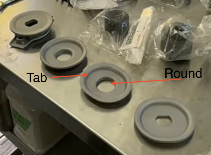

That difference in bushing size is pretty nuts. I really need to do this!

Only way I have found to make strap wrenches usefull, and only the fabric ones, the rubber straps tear instantly.Very cool! I like the duct tape trick.
Yes to a locating tab, but no to holding the shaft in place. The plate with the locating pic has a round bore, unlike the flat sided shaft.To do the front top lock nut, you don't need a strap wrench or antyhing since the top cushion retainer has a locater in it to prevent twisting with the oval-shaped hole and flat sides that hold the shock shaft for you (at least my 06 does).

They may have changed the design by 06, it would be a good idea for sure.I got lucky on mine then!

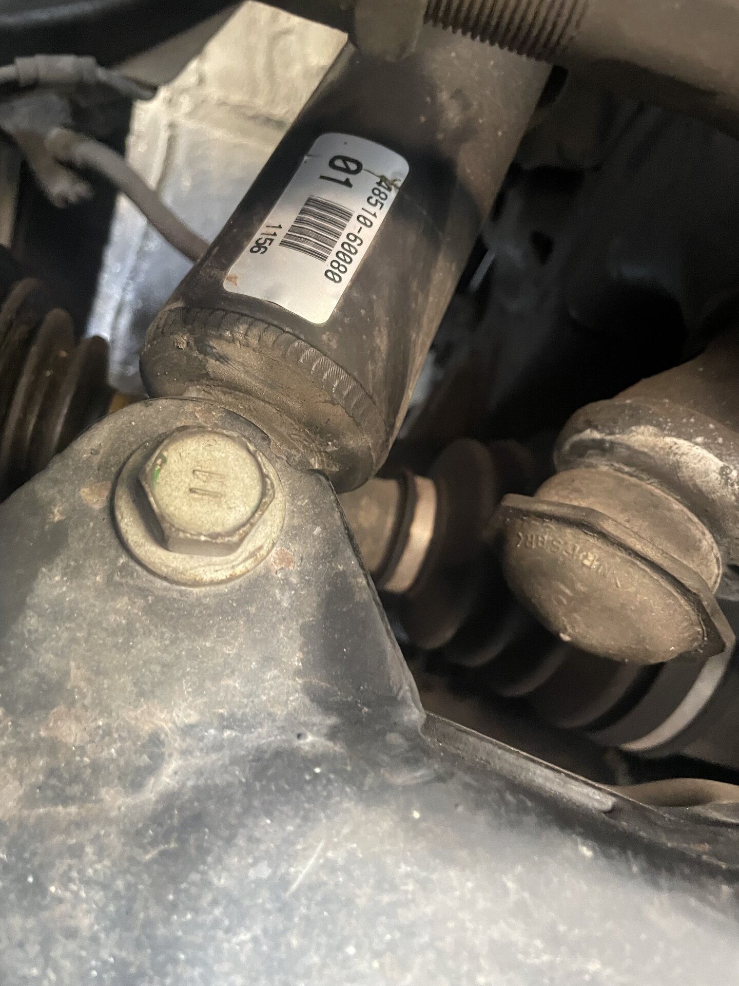

absolutely. the bottoming / clanking is gone. Also, the squish is reduced, so my wheel doesn't kiss the fender anymore! Quieter within cabin as well having some more rubber damping, vs the hockey pucks I pulled out!@harshjay Did you notice a difference in the ride? Everyone on here keeps saying the ride quality is more a globe function and not the shocks . How is your ride quality different now? Very curious to know
I'm installing a diff drop and some new suspension stuff in a couple of weeks, so I'll retorque them at that time. When I initially did it I think I somewhat tightened in air then torqued on ground. I tried to follow the forum guides as much as possible. Worth a try!While you had all the front suspension components replaced, were all the nuts and bolts torqued on a lift or on the ground? Don’t know if torquing with wheels in the air would cause this issue, but just a random thought.
I'm down a rabbit hole trying to figure out the source of a clank/rattle. How significant was the thud you heard before you replaced the bushings? I thought my issue was with the control arm bushings, but they seem okay. The latest thought is an issue with the "shock absorbers." Indeed I can feel a click/clunk when I have my hand on the "shock" and my truck bounces up and down (on a lift). I couldn't tell if it's a bushing issues or an internal issue. This is driving me nuts. Thanks.Thank you so much! my LX rides really smooth. But....When going over cracks in the road or slight bumps, I hear a thud which should be more muffled given how smooth the ride is. There is no "bouncing" when going over bumps. I already replaced the links. I figured maybe the bushings in the front shocks could be the culprit. Thanks for the FSM link!!
