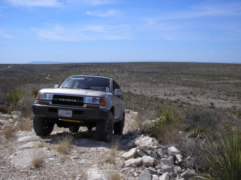

Here's a photo that shows one reason I'm liking these tires, and why I really like the 255/85R16 size for the kind of driving I do. The tire is at 42psi, so it rides firm enough for highway use and yet still has enough flex to wrap around some of the rocks I drive over. I get a much smoother ride and I think/hope I'm a little less prone to getting flats than if I was using 235/85R16 or 265/75R16... and I don't have to mess with airing down/up all the time.
