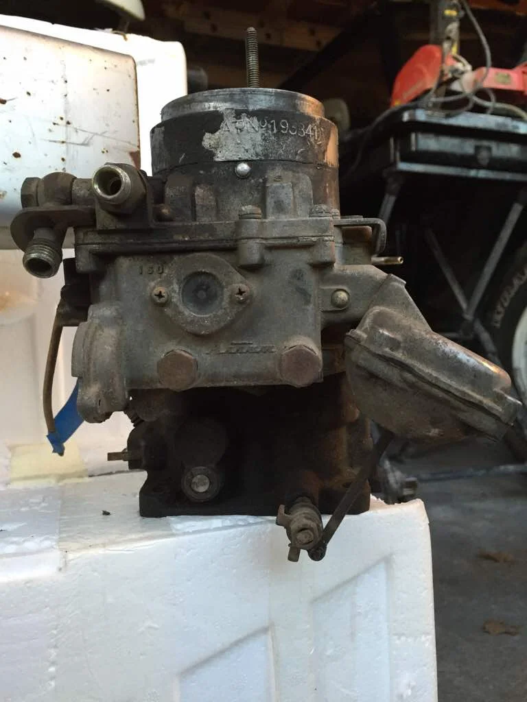

For those that are familiar with this modification it looks as if there has been an "extender" welded into the top of the carb. See photo. I feel like everything above the silver bump on the front of the carb is an addition. I'm planning on shipping the carb off to be rebuilt. Is removing this "extender" and issue?
Any and all input/advice/ideas would be great. Thanks!

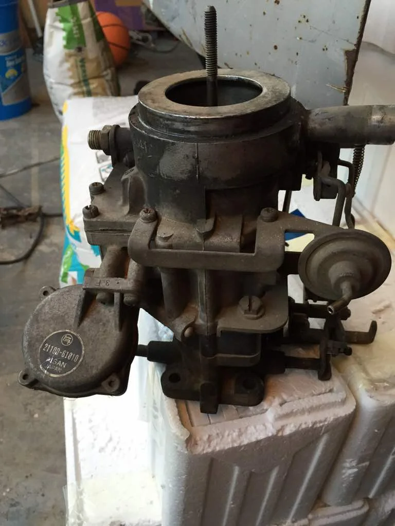

I'm gonna ship this carb off to FJ40Jim or Mark and let them put it back to stock. I don't trust myself to drill out the screw/rivet etc.

Other than the top "extender" the carb looks stock to me. Anyone else see anything that might cause any hiccups?
Don't drill out the rivet looking thing. That is a soft plug right at the top of the carb. The LPG mixer starts just above the soft plug. It should just be jammed or glued in place. Carb looks unmolested otherwise

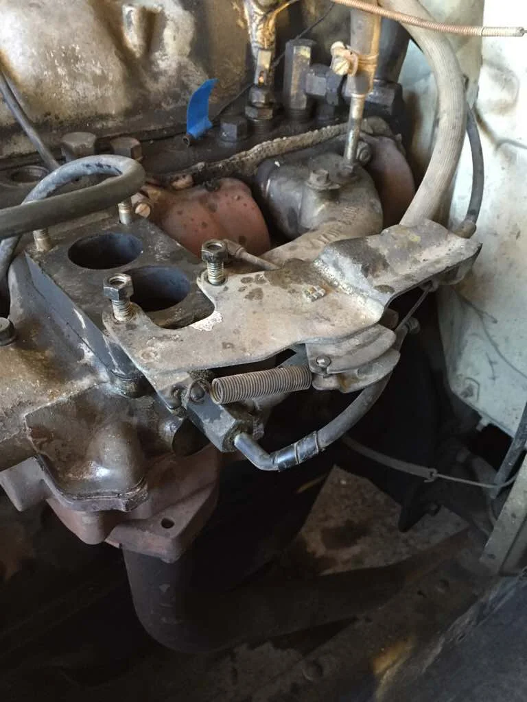

There is one port that looks like it may have been drilled into the intake manifold that I'll have to post up to see if it needs to be plugged as well. I forgot to take a picture but I think the vacuum tubing went straight to one of the LPG modules.
Actually no need to post another picture. In the first picture I posted in this thread in front of the carb between the TEQ logo and a nub on the intake manifold you can see the vacuum hose I'm talking about. Is that OEM or a LPG addition?
I can't tell from the pic. Depending on year & market there can be one or two vac barbs screwed into the intake manifold ahead of the carb. Cap the unused vac port and move on.
When the carb is reinstalled with no LPG, there will only be two vac hoses: one from carb base to distributor vac advance, one from side of intake to choke breaker.
