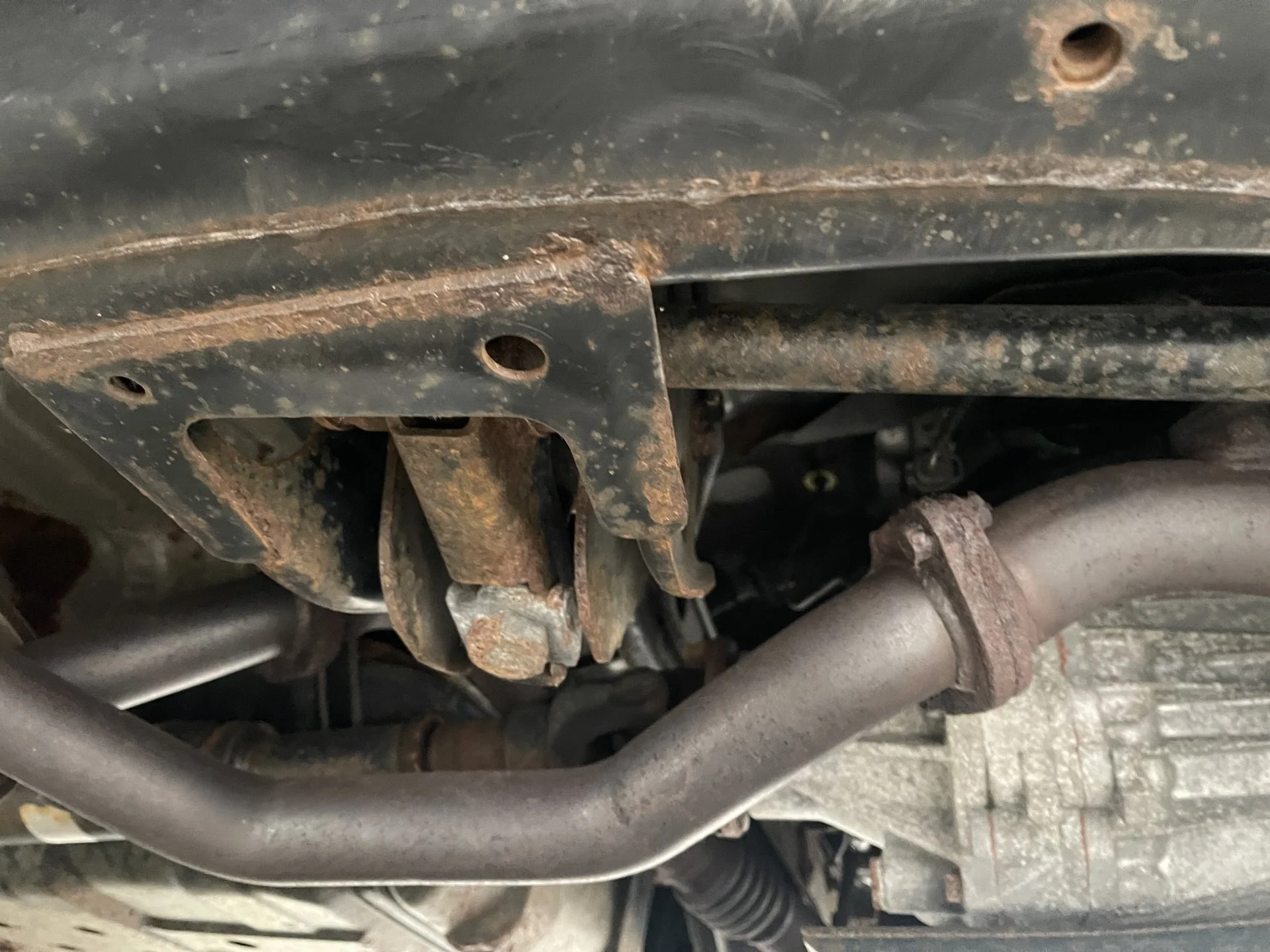

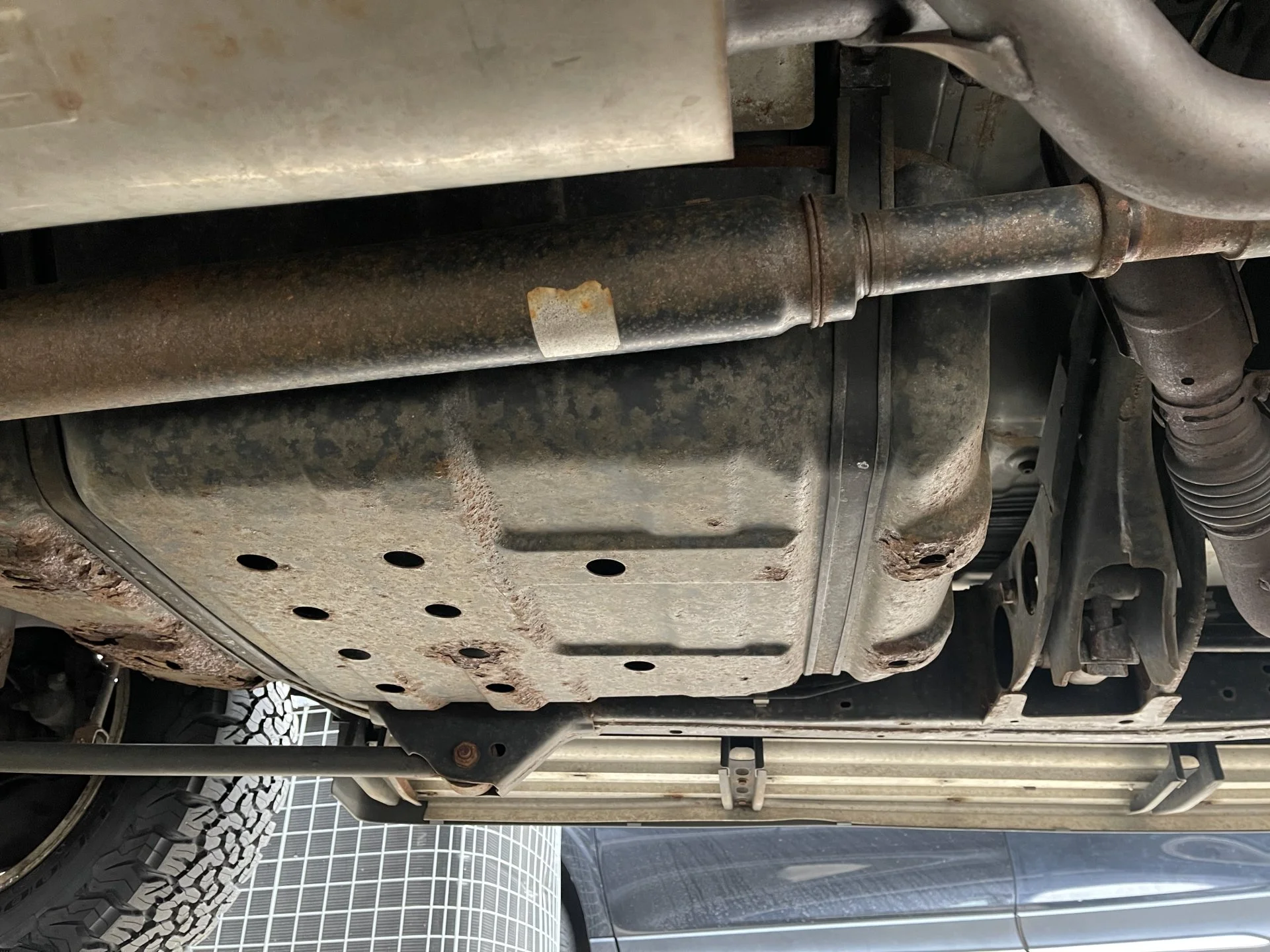

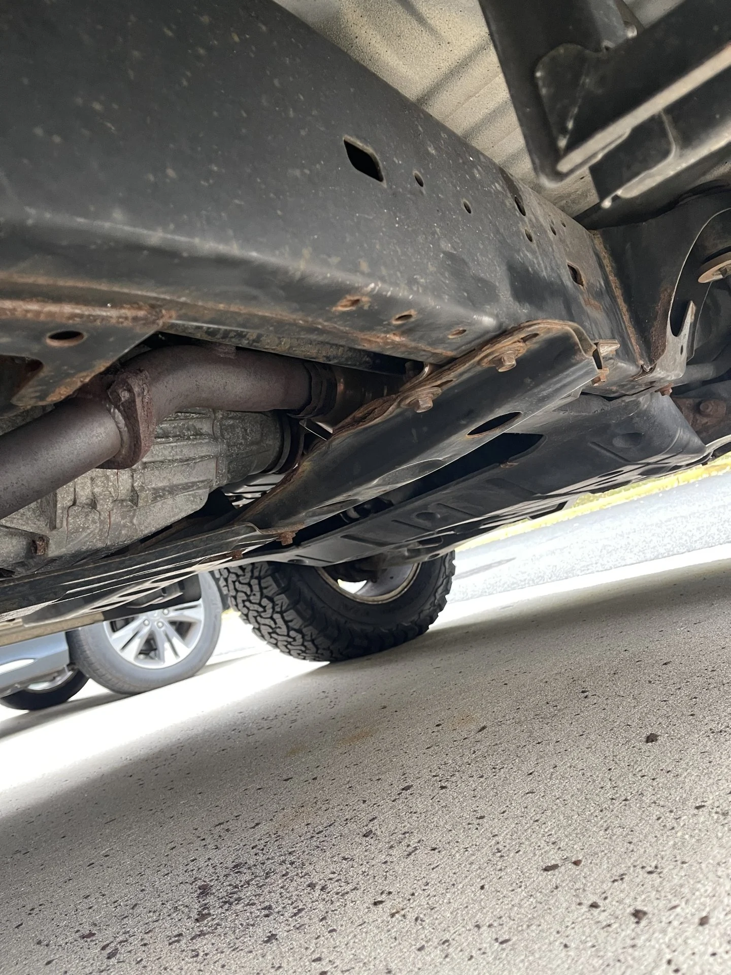

I did my state inspection this week, and inspector told me that I have a lot frame rust, he passed me this year, but in 1-2 years it will get any worse. What would you suggest to stop the rust on the truck? I already changed an exhaust and transmission lines because of rust, but trying to figure is there a way to slow down the frame rust

Post some pictures, that can give peeps an idea of how bad it is and make suggestion. There's tons of rust threads and how to mitigate it, from barriers like POR15, to treatments like Fluidfilm, to welding in new metal/scab plates.

If it took 18 years to get to this much rust, it'll last at least another 18-30 more years before there's any structural issues. Longer if you coat with a product like Blaster Surface Shield or similar.
From your pictures, you have very light surface rust on the frame. Crossmember has more damage, but that's easily replaceable. Ugly fuel tank skid plate, but also easily replaceable.
Boy, I would be tempted to go back to the inspector and make them show you their areas of concern, because I don't see anything remotely worrying. The cover over the gas tank is looking nasty, but most do. That said, you are in the East, I'd look at preventative measures still for winter.
It is because you are in Fairfax. lol. I live in Loudoun which is really no better BUT that rust is essentially is NOTHING compared to others in the area. Check your driver side rear cross member above the axle though. That is likely the only place you have frame damage based on the condition I am seeing. It is fixable if you do. My friend had it done in VT. We are not safe from rust here but anything north of here or near the ocean is going to be tough on these trucks.
