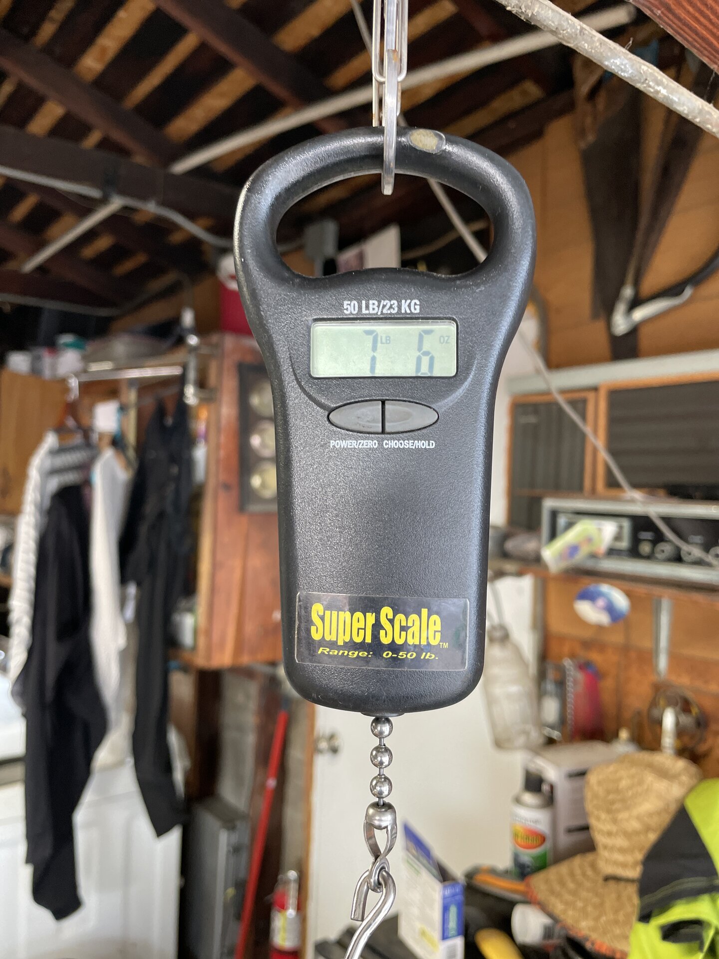

Almost 7 and a 1/2 pounds for the damper. Between this and my side steps my truck is down 44.5 pounds.
