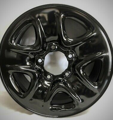

thanks for the replies. I’ll keep my summer spare for now and just more regularly check AK list, CL, FB marketplace. I reached out to this guy and offered him $75 for a steel rim with a 9 year old tire, he said no…

next question for the group anyone using a steel Tundra spare?
Yup, I am using a new (sort of) steel Tundra wheel and tire for my spare for my winter tires. Set was from the spare under a Tundra and is the same diameter as my snow tires. It only cost $40.00 bucks "MT dollars", from a wrecking yard. Installed Autel adjustable angle sensor for the 2011LC.

With all the Tundras on the Peninsula that have been converted to bro trucks I would have to think there are lots of takeoff aluminum rims available. Maybe check with some Toyota dealers or tire retailers to see if they have any? They had to go somewhere.
