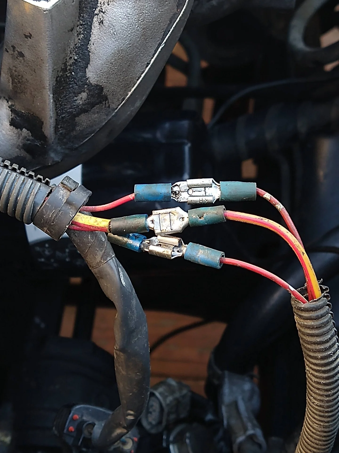

2. During the disassembly I found this wiring splice from one of the 7 previous owners. I replaced these spade connectors with butt connectors and hoped for the best. These run from the end of the fuel rail to wire harness junction just behind the battery. Does anyone know what these wires go to? I have a FSM but am not great at wiring diagrams so I figured I'd ask here before I dive into the diagrams.

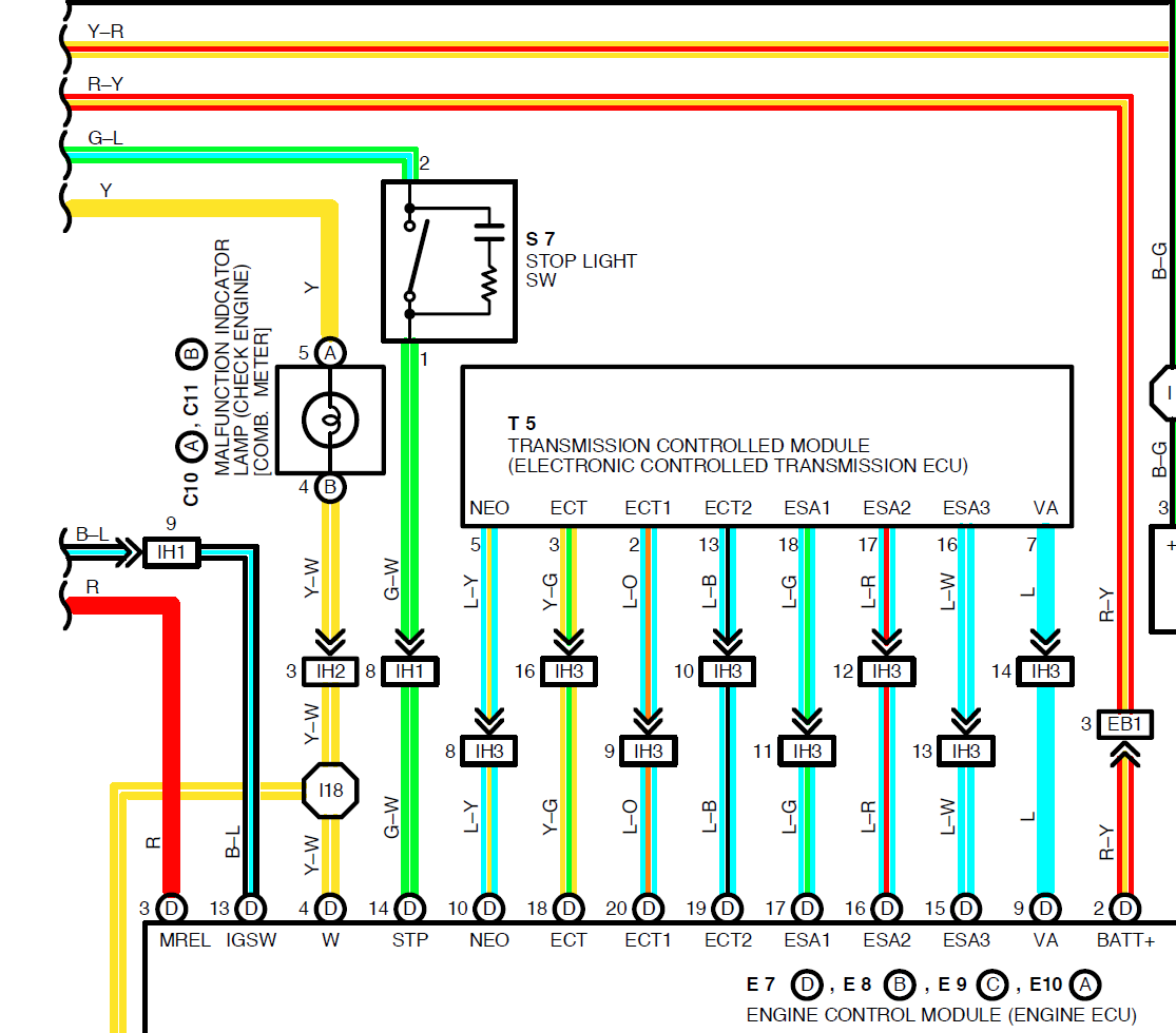

This is from the 1994 EWD; I think the '93 is the same:
This is only a guess, but it looks like those are the EFI leads:

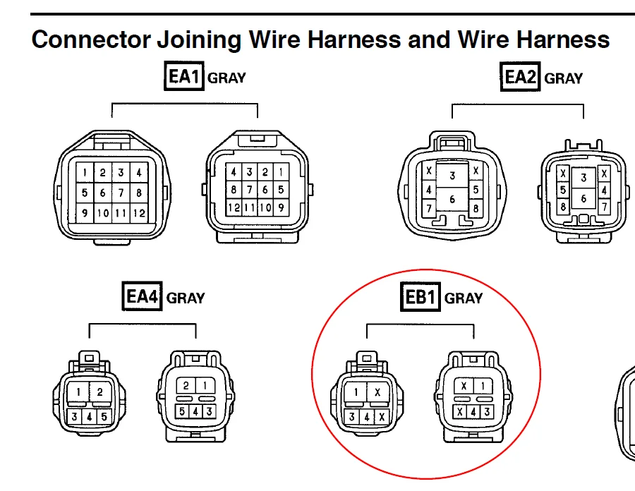

The colors are right and they appear to be bundled together. The R wire (red wire) should be connected to terminal "4" in EB1 (see above). The Y/R wire (yellow wire, red tracer)should be connected to terminal "1" in EB1. The R/Y wire (red wire, yellow tracer) should be connected to terminal "3" in EB1. Looks like someone cut that connector off the harness, and used the spade terminals to replace it.
"EB1: is a waterproof, 5P (5 pin) connector housing:
(female on left, male on right) You can either buy these from Toyota, or rob them from a 1993 Camry (or something near the same year). Be aware, though, Toyota only sells the bare housings; you then also have to buy the terminals (I like Mauser or Ballenger; you also need a crimper) and seal plugs. Not a big deal, but you need the whole kit (and kaboodle). Looks like about $40 to put it back right.
PM me if you need help with this.
If I'm right, the dark red wire (which is BR above) is a ground. I cut off the EWD above that point.

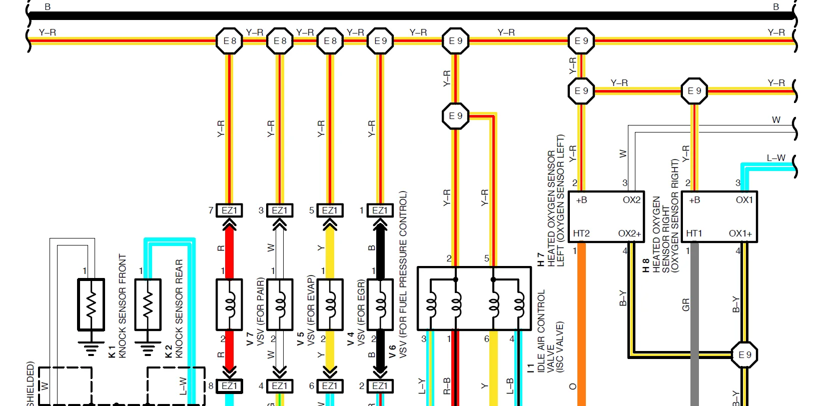

The Y/R wire (yellow wire, red tracer), feeds all this crap:

@Malleus Thank you so much! Considering that these wires seem to run to the relays that I measured to be out of spec I'm now concerned that if I put in new relays they will go bad. Thankfully I bought spares so I can try plugging them in to see if I can get fuel pressure. But doing a better repair than my crimped butt connectors sounds good. I have some crimping tools but I'll see if I have the right tool for those pins for the factory plug.

If those wires are the culprit, your solution is a good one, as long as the connections are good. The only reason Toyota put a removable connector there was to allow you to remove either side - the engine harness (for example to pull the head or engine) or the load side.
If I had to guess, I'd bet on the ground being bad.

The issue of cranking with no start was my fault. When I was fixing the wiring from my first post in this thread, I mixed up the two small gauge wires. When I fixed it, the 80 started right up.
