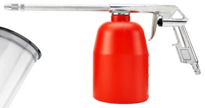

This year, I got a 5 litre can of the stuff, Fluid Film NAS, but it seems to be thicker than what is on the rattlecans. I also got a spray bottle which you can fill up 2/3 with any liquid and add compressed air, 10 bar, but the FF nas is a bit too thick at todays temperature. It comes out as a concentrated stream only, making "worms" of fat on the surface, like spaghetti-fat.
After a bit of experimenting, I found that using a cheap (5$) spray applicator with compressed air, and heating the FF to 40+ Celsius is very efficient. Gets too all the corners, and even blows off some flakes of loose frame-paint at the same time. This method does give a bit of oil mist in the air, but not to bad. It is a friendly oil after all. The sprayer is a bit like those linked to 4 posts up, but a cheaper version.
