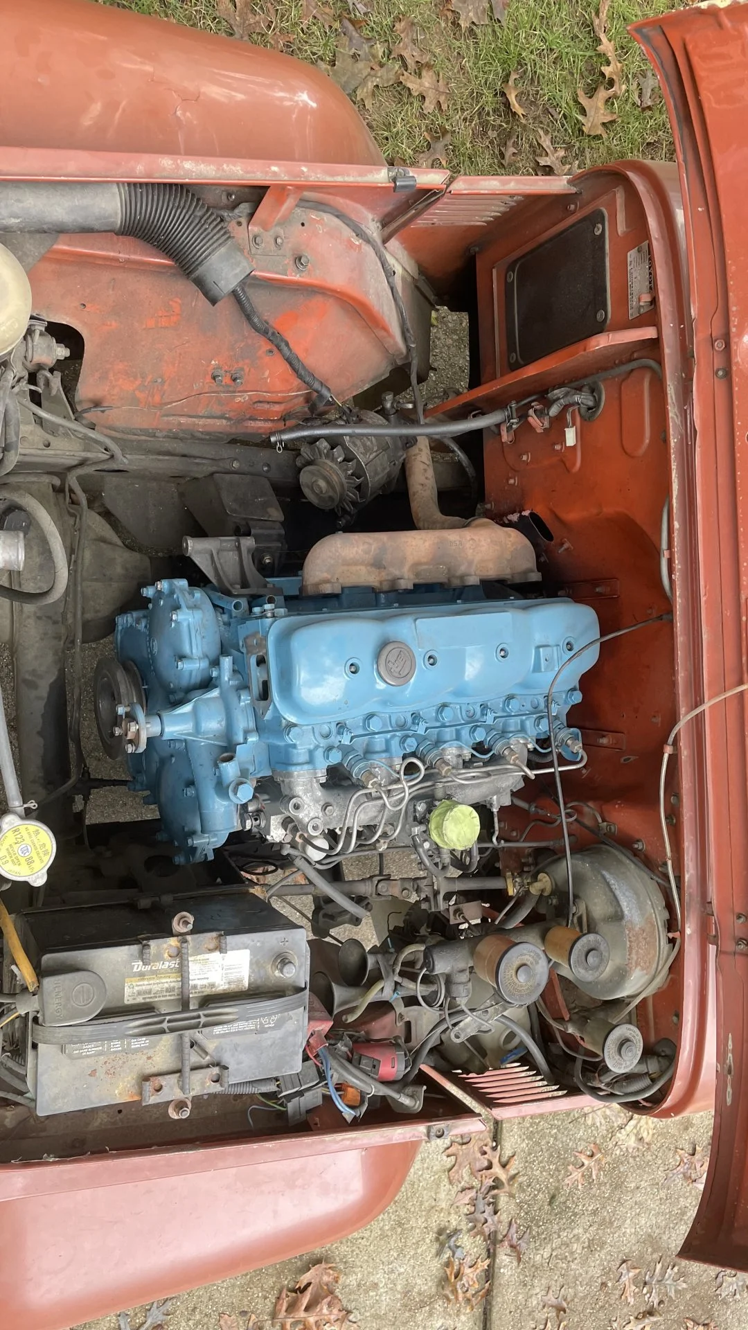

I’m in the 40 section for the brakes and stuff, but I need a lot of help on the engine. That parts are mostly there according the the mechanic I just got it from, I just need to put it together. Where should I start? I need a lot of help because I’m not a mechanic. I have a 1977 BJ40 with a B engine with a 3B head
Get a Factory Service Manual for the 3B motor. Looks like a 3B from pics. This will have all the steps on how to do things. It will show you how the parts go together. Start on a small part. Finish it, move to the next. Take your time to do it right. Ask questions. You are in the diesel section which is great. My 15 year old son rebuilt a 2H diesel motor by following the factory manual. It is not hard if you eat the elephant one bite at a time. Build the courage by getting smiles with small wins. You will surprise yourself on how easy it can be.

This is what I ordered and what is on it. They alleged it would work fine. I’m just taking it one step at a time, and just trying to get it running at the moment. What I received today from the mechanic was not in the shape they told me it was in. They told me I just had to find manifold studs, but it needs more work obviously. I’m gonna get it rolling on its own power and then figure out the rest later
I understand it isn’t ideal, but it is what it is. I just want to get all the parts into the engine bay and get the car running.
Any help on what to install or start on first would be great. I’m just trying to work with what I can right now.

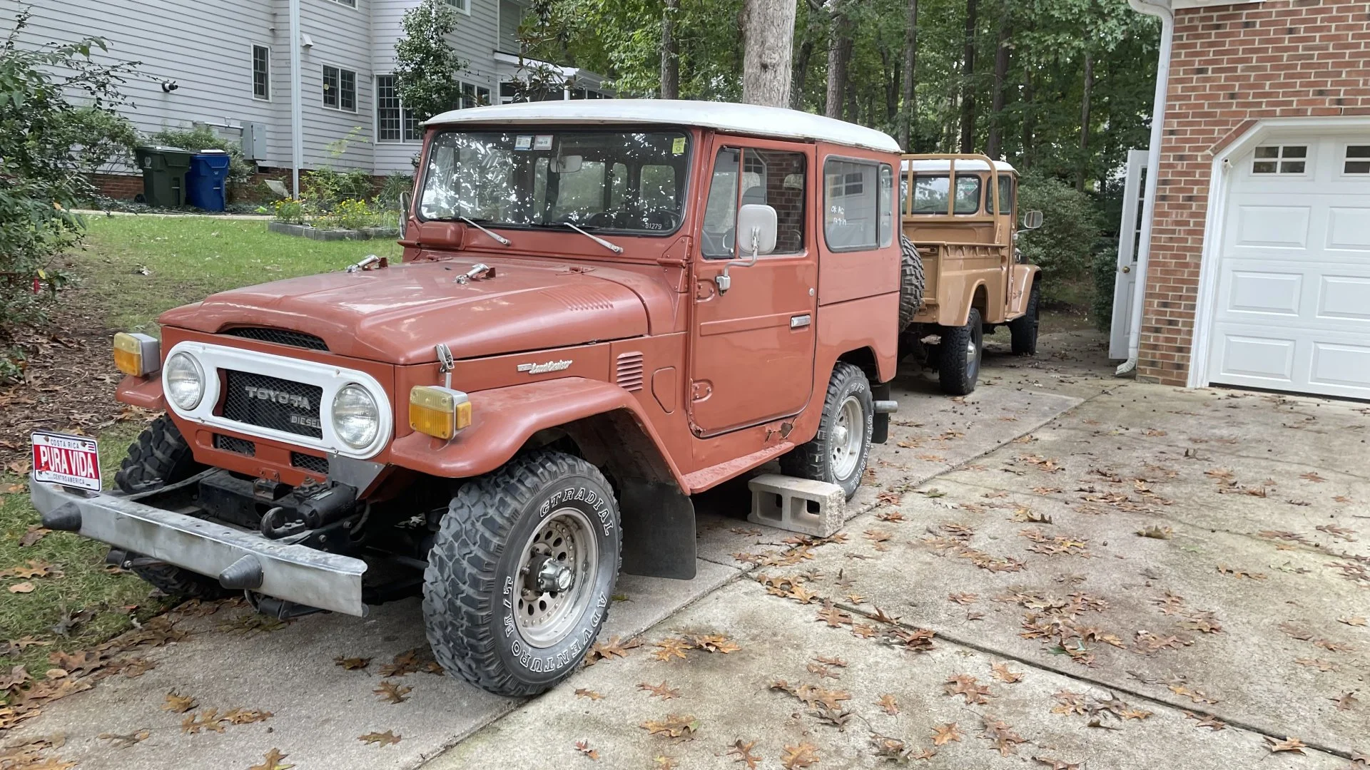

sure it’s a 77? with the long jump seats and the split front i would have thought us was older
sorry i don’t know these engines so i’m really no help. just looking what you’ve got! looks pretty clean from what i can see in those pics

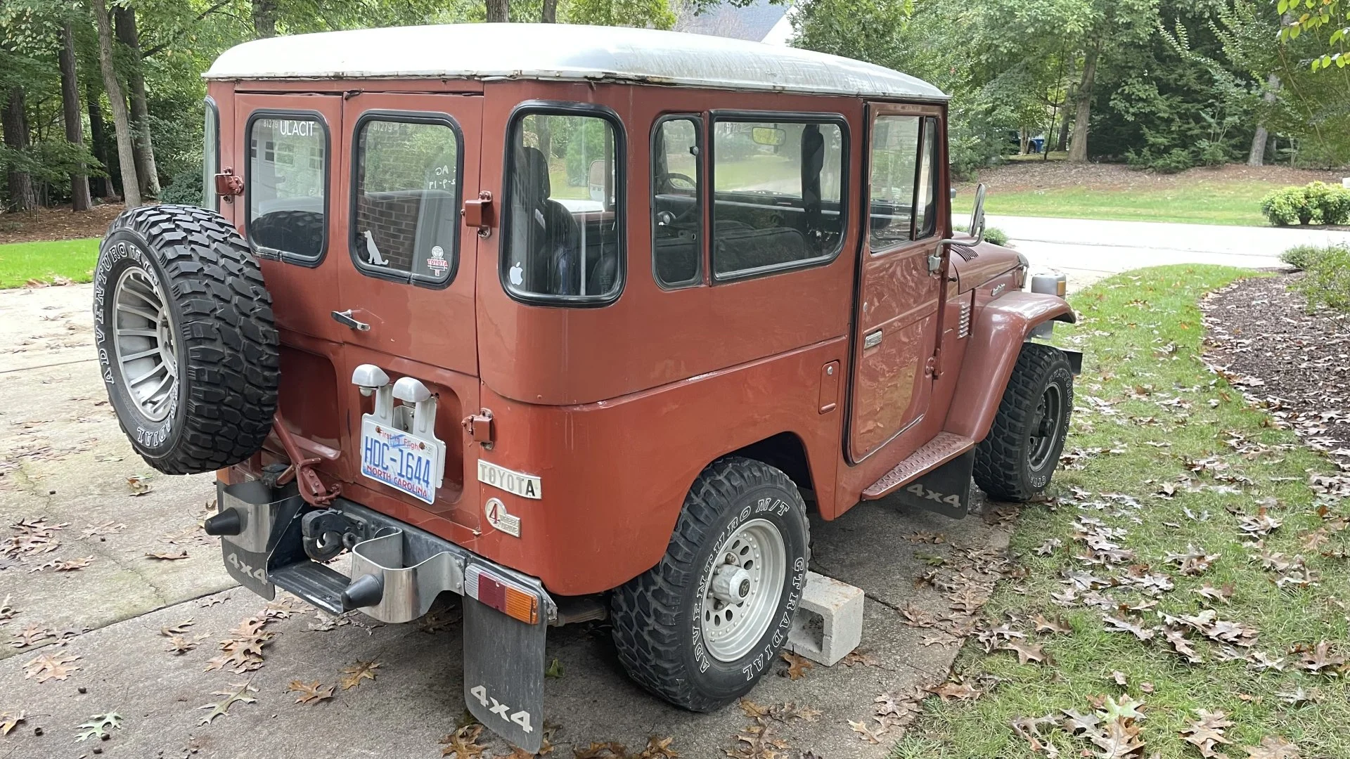

I’m not positive. Title said 79 but that is definitely not right. Hard top has small windows that open, and from what I remember, that’s 76-77. SA cruisers didn’t have toolbars most of the time, and seats could be aftermarket. Mine has a front bench and I’m pretty sure that isn’t stock, but I like it anyway. Has some rust on driver rocker panel and rear driver quarter panel, and some rust on the ambulance doors. Pretty typical rust spots. It’s not bad for a SA land cruiser in my opinion. Most of it is exposed rather than covered with bondo, which is a plus. Makes it easier to fix later when I can

Is the fuel and electrical connected? Whats the gearbox and clutch doing, are they connected? You need to give us a bit more info. Have you seen the engine running?
Fuel filter and some fuel lines and other stuff are in the back. I’m not quite sure what that means, but I’m pretty sure that means fuel is not connected. Clutch and gearbox are in and connected.(car doesn’t roll when it is in gear, and the clutch works) Battery is disconnected, and the alternator is not connected. It’s all there but I need to assemble it. I need some guidance on how to do that
I haven’t seen the engine run yet because it hasn’t all been assembled together yet. All the parts are there except for exhaust manifold studs, which are in the mail and coming in a couple of days.
I think tomorrow I’m going to lay out the parts I have and ask what each one is and where it goes.
Ask any questions and I’ll answer to the best of my ability. I’m just trying to get it all put together
Its not rocket science, all that stuff goes on one way. You should make sure you have brackets etc for the various parts like the alternator and fuel filter. They may be attached to the engine.
But yes, lay them all out and we will go through them one at a time. Most other older cars and trucks will have similar set ups

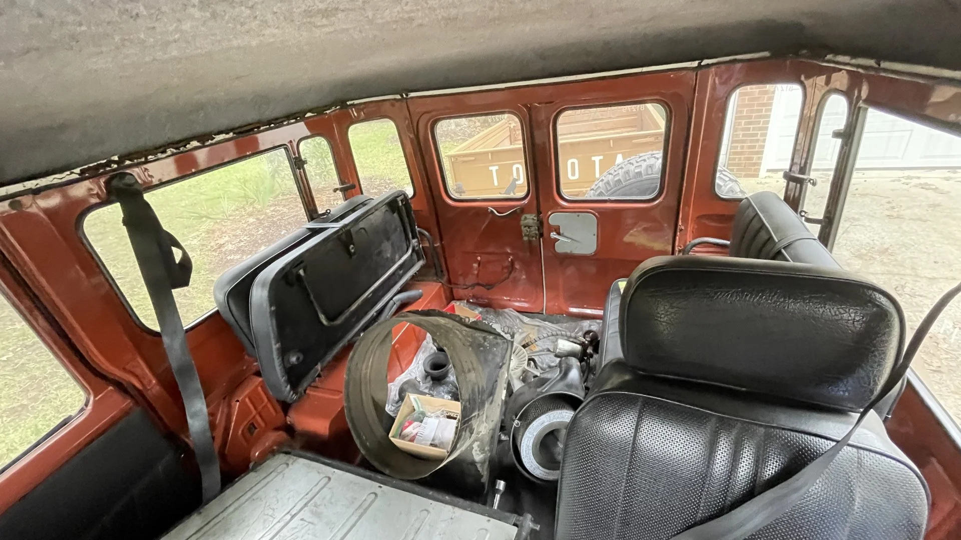

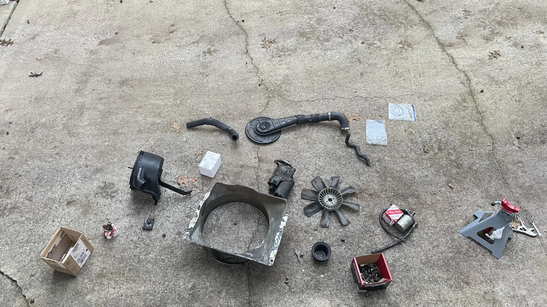

This is the stuff that was in the back of my truck. Any help assembling it or identifying it would be helpful.
Feel free to ask for closeups of anything
I would start with the starter motor. Getting the engine spinning on the battery would be my first stop. The starter is the black heavy thing next to the fan
Did you look at those download links?
I cant see a thermostat houising but I see a thermostat. I have this premonition that maybe there are small but crucial parts missing.

Nearly forgot, thermostat housing is there, I just forgot to put it in the pic. It was somewhere else and I forgot to grab it
