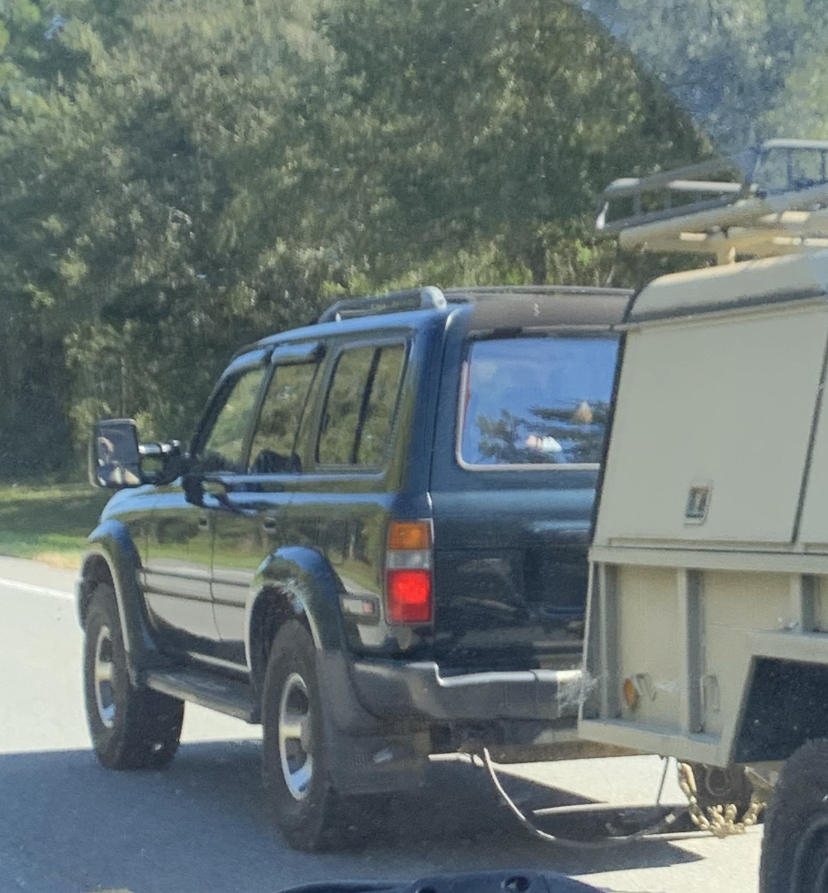

I am not sure what theses came on before but they don't look that bad on an 80 this is not my rig

The GM mirrors I linked look almost identical to the Clearview ones, down to how far they stick out even when collapsed. Look up pictures of the Aussie 80s with Clearviews. I think they look badass but to each their own.

@shocktower, I think those are the Clearviews.

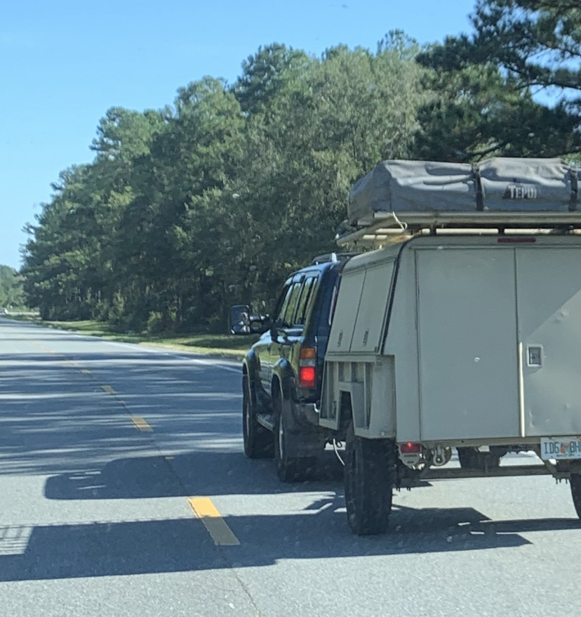

I passed a guy on the highway a while back and they don’t look as bad as I expected they would. I wouldn’t sport them though.
