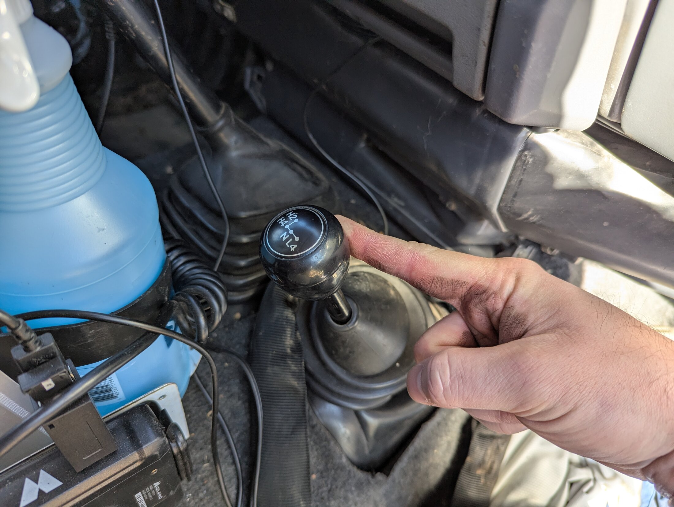

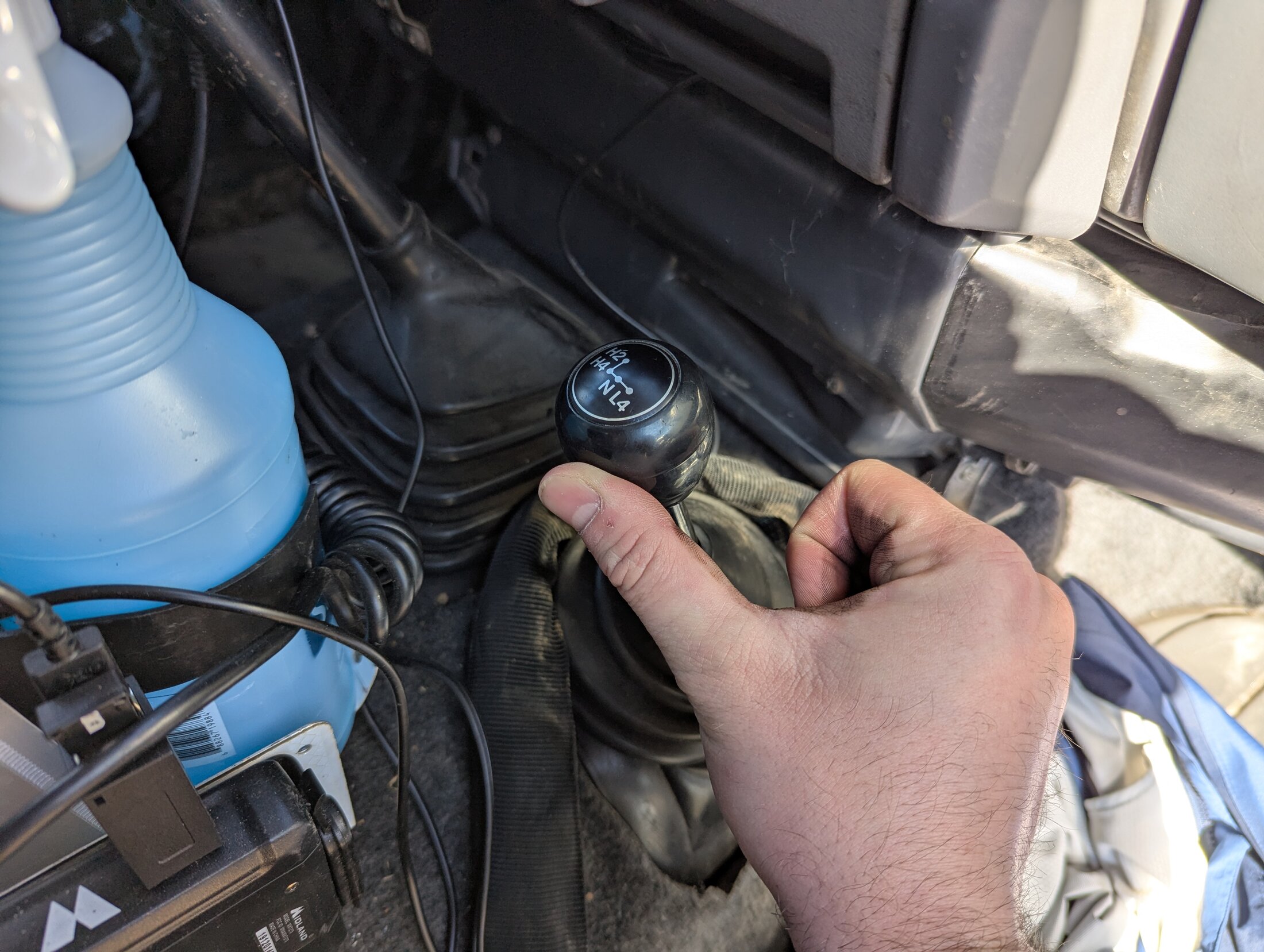

I asked on a 70 series specific group about what i found while looking into my 4wd problem.
If you pull the stick down in 4lo, all for tires move.
If you push the stick up while in 4lo, it moves forward roughley 2 inches. And the front disengages and you are in 2lo.

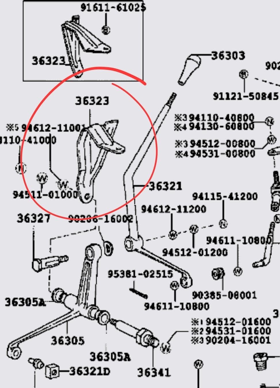

Come to find out, the interlock pin was pulled, the shift gate was removed, this mod allows a quick change from 4lo to 2lo. Really wish i knew this as i could have used this little trick a dozen other times crossing pavement while wheeling. If i knew this was the issue. I could have just pulled back on the stick and we probably would have made it to the top!
I'm getting conflicting answers. But i believe the shift gate removal explanation since mine doesn't have it and the guy seems like he knows what hes saying. But hey idk. Nothings broken and its a handy feature if you KNOW its there, other wise you think you blew a hub

It’s a common mod. The bracket is probably there they probably removed the gate that stoped it from moving forward. It is a nice mod. You can also do a twin stick.
