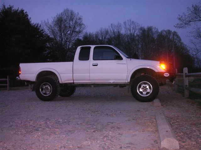

    stock lc wheels BS should be 4'' here is a pic on a 99 w/ donahoes and deaver 8 pack
    tires are a 285/75/16 can barely get the back of back wheel to snag a bolt head that holds the flare on at full stuff.
