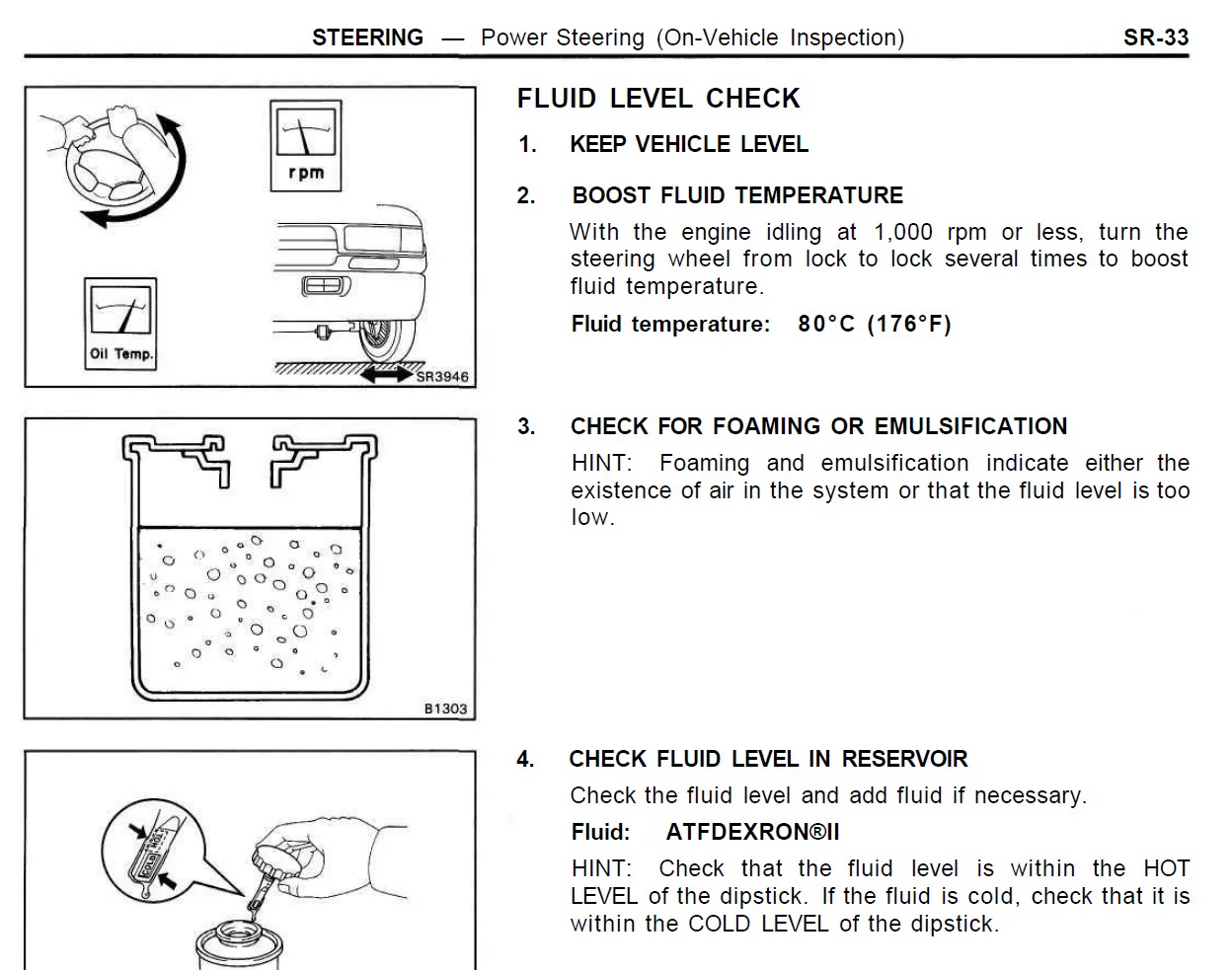

I highly recommend you download a copy of the FSM. Most questions like this can be found there. You can find one in the Resources section.

Thanks! A foolish question for sure, but I recalled reading something way back that they were linked. This settles it in my mind, so I really appreciate the help.
